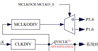

Also 74AHC1G4208 SOT25
or Si5351A / MS5351M  MSOP10 + i2c SW CLK0  = CLKIN/RDIV
or XTAL STC-MCU SO16+ as MCLKO = CLKIN/N, to ??MHZ (144MHz?)
