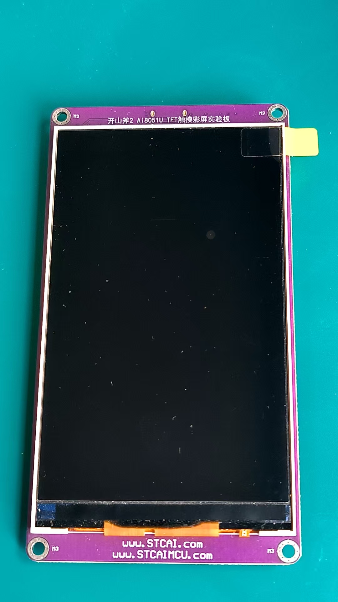

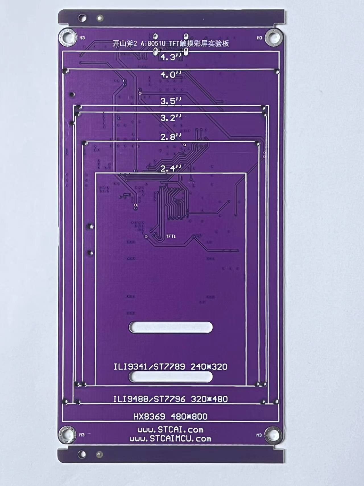

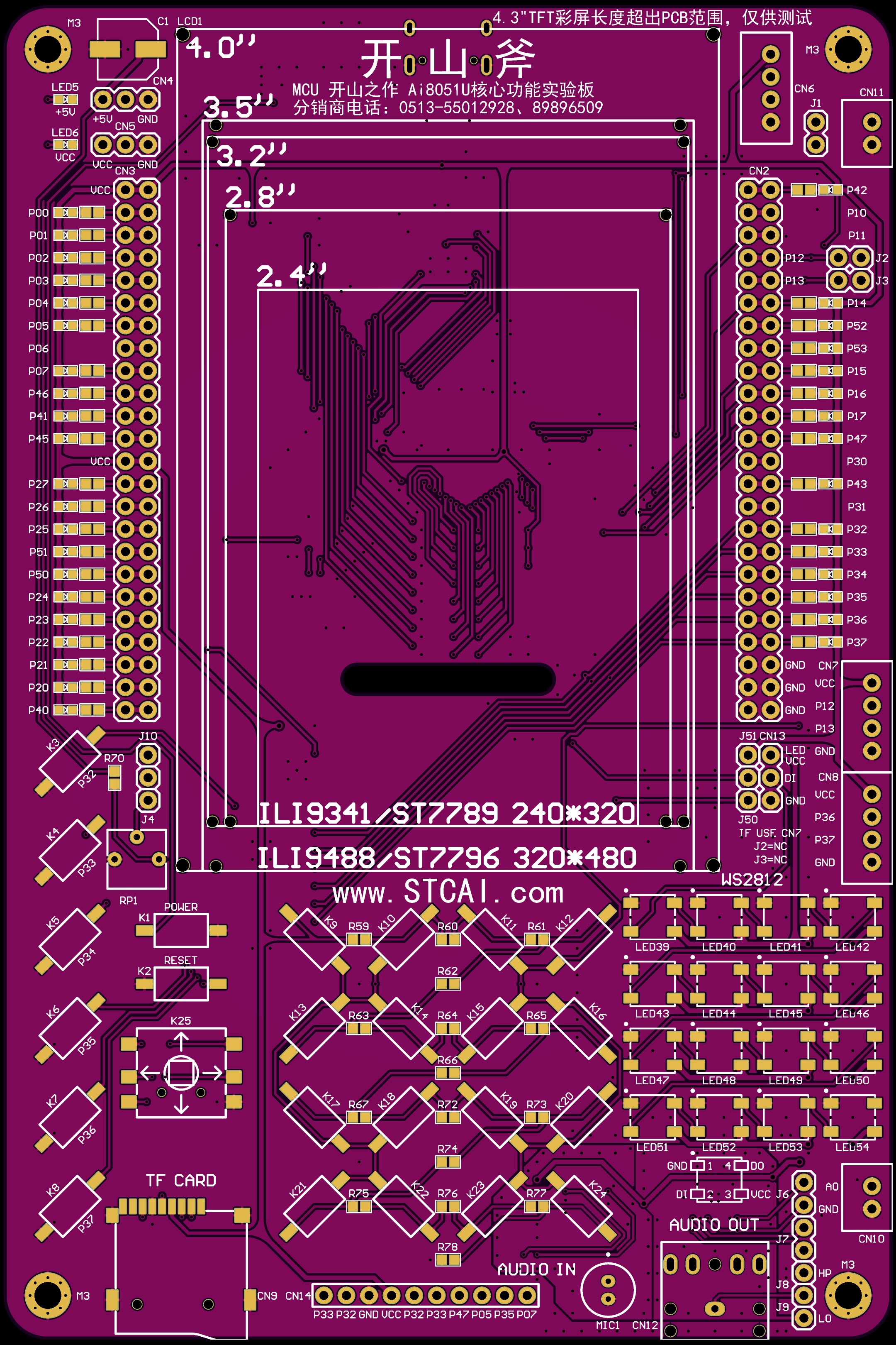

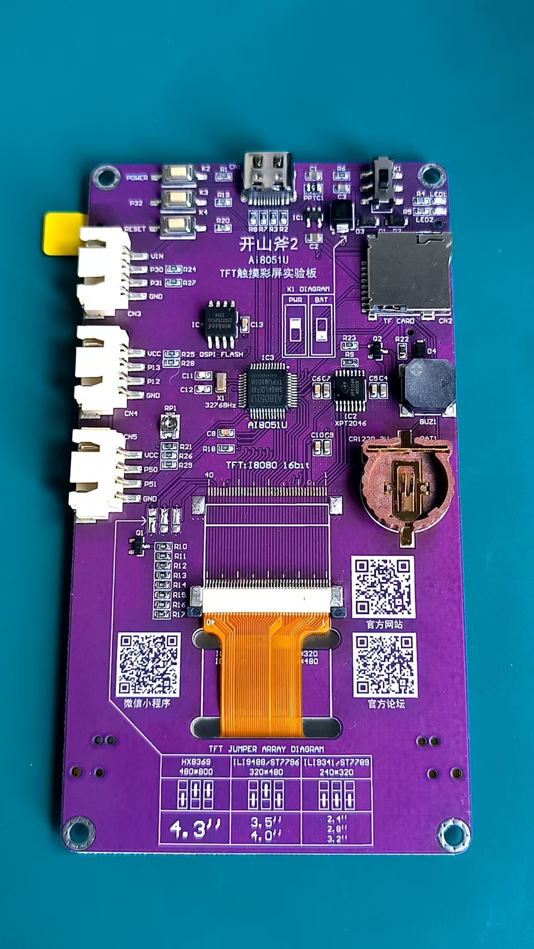

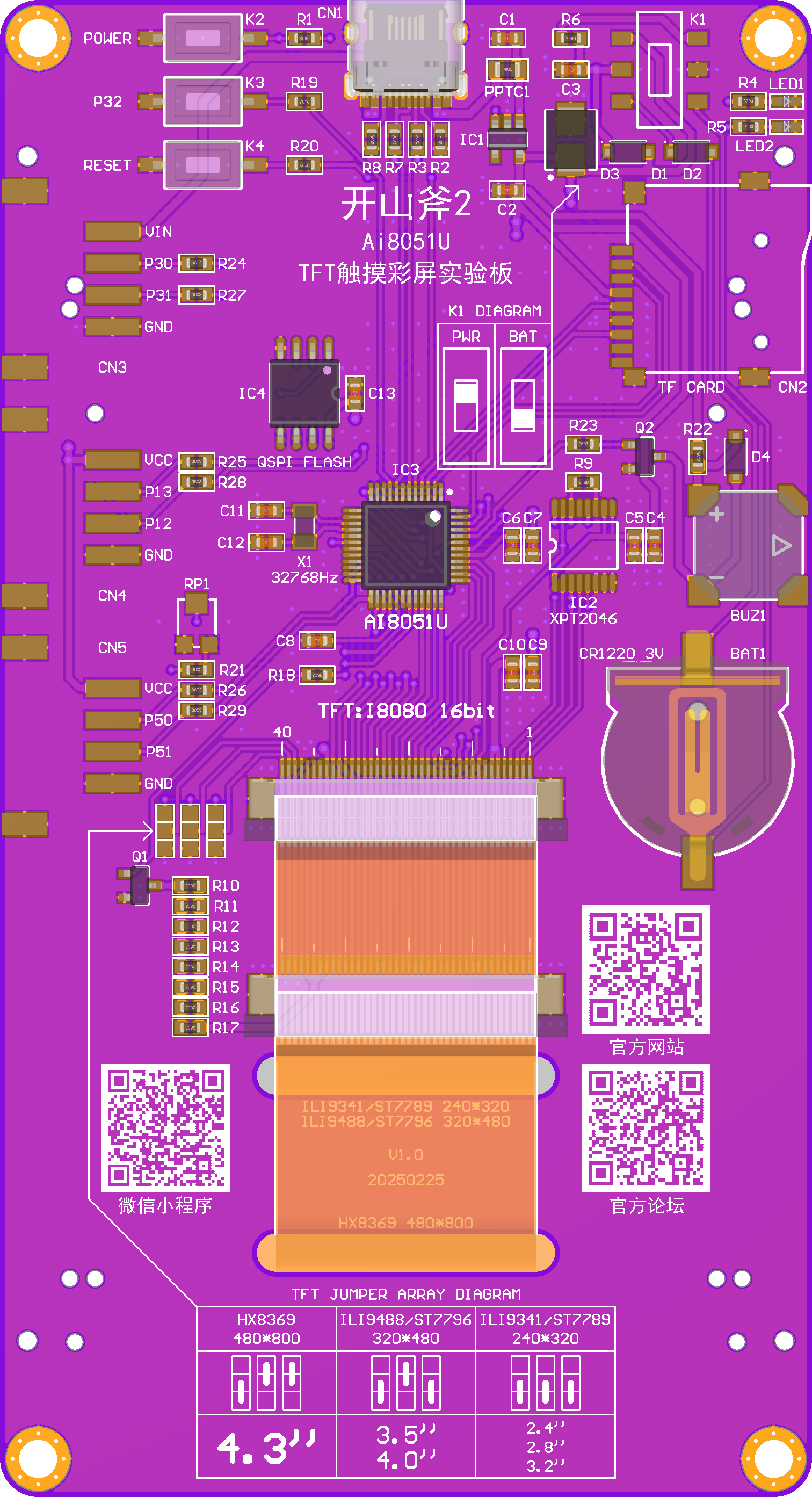

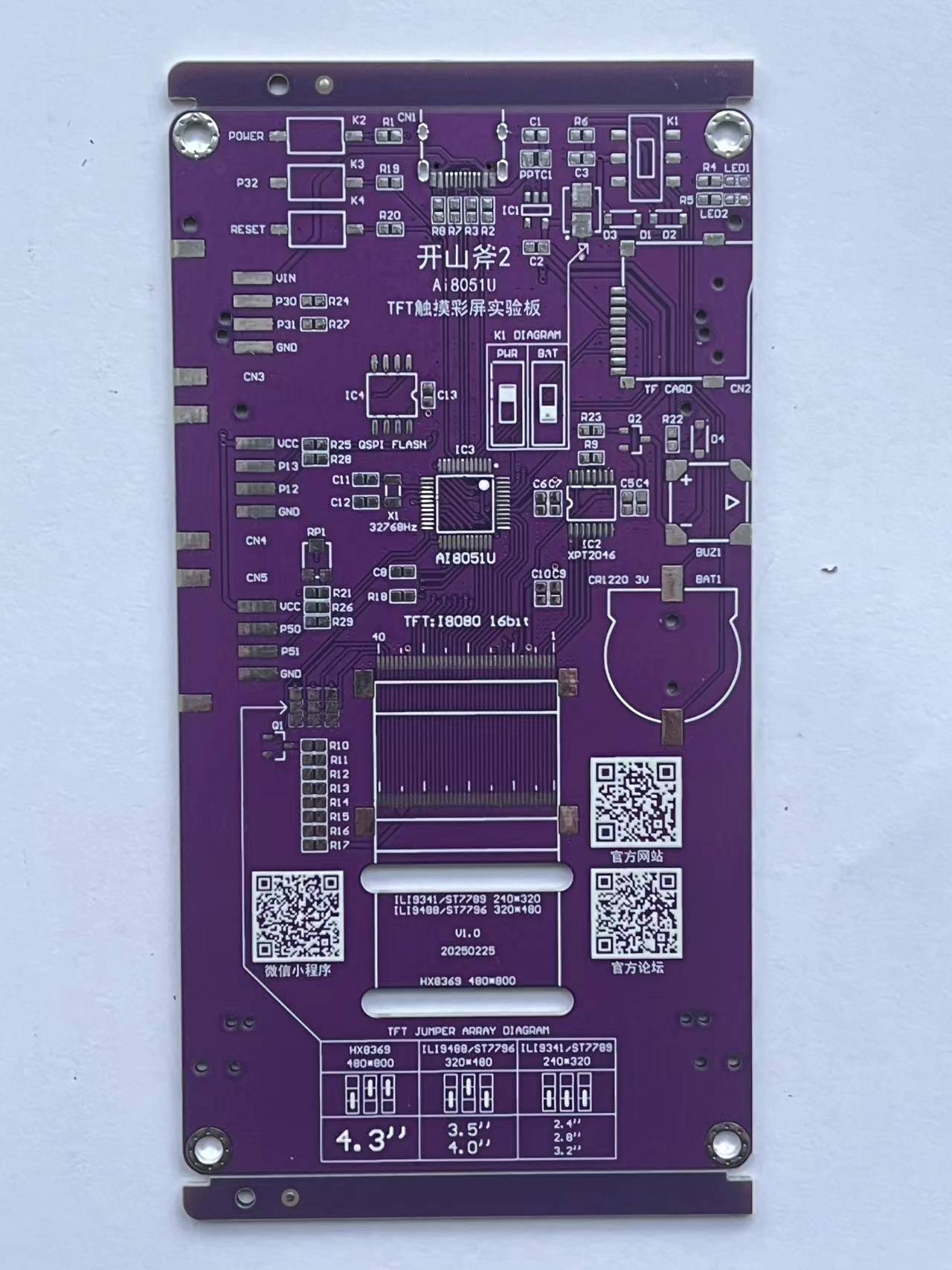

开山斧2TFT触摸彩屏实验板/16位-i8080并行接@Ai8051U
开山斧  TFT触摸彩屏实验板 / 8位-i8080并行接@Ai8051U
===QSPI-Flash、TF卡,可做串口屏
Ai8051U-TFT触摸彩屏实验板-V1.0-20250225
LCEDA:
AI8051U-TFT触摸彩屏实验板-V1.0-20250225.eprj (2.11 MB, 下载次数: 198)
SCH:
SCH-AI8051U-TFT触摸彩屏实验板-V1.0-20250225.pdf (493.48 KB, 下载次数: 212)
PCB:
PCB-AI8051U-TFT触摸彩屏实验板-V1.0-20250225.pdf (3.45 MB, 下载次数: 187)
Gerber:
Gerber-AI8051U-TFT触摸彩屏实验板-V1.0-20250225.zip (152.41 KB, 下载次数: 170)
BOM:
BOM-AI8051U-TFT触摸彩屏实验板-V1.0-20250225.xlsx (11.51 KB, 下载次数: 155)
Assembly Drawings:
Assembly Drawings-AI8051U-TFT触摸彩屏实验板-V1.0-20250225.pdf (49.18 KB, 下载次数: 143)
Pick Place:
Pick Place-AI8051U-TFT触摸彩屏实验板-V1.0-20250225.xlsx (13.83 KB, 下载次数: 145)
Pick Place-AI8051U-TFT触摸彩屏实验板-V1.0-20250225.csv (3.21 KB, 下载次数: 135)
其他资料请参考开山斧-Ai8051U-核心功能实验板
https://www.stcaimcu.com/forum.php?mod=viewthread&tid=10686
版本更新记录:
V1.0
初始版本,增加复位按键,更新部分元件封装,原理图增加说明(接口和下载程序),
PCB增加丝印(论坛网址、官网论坛小程序二维码、电源切换开关说明)

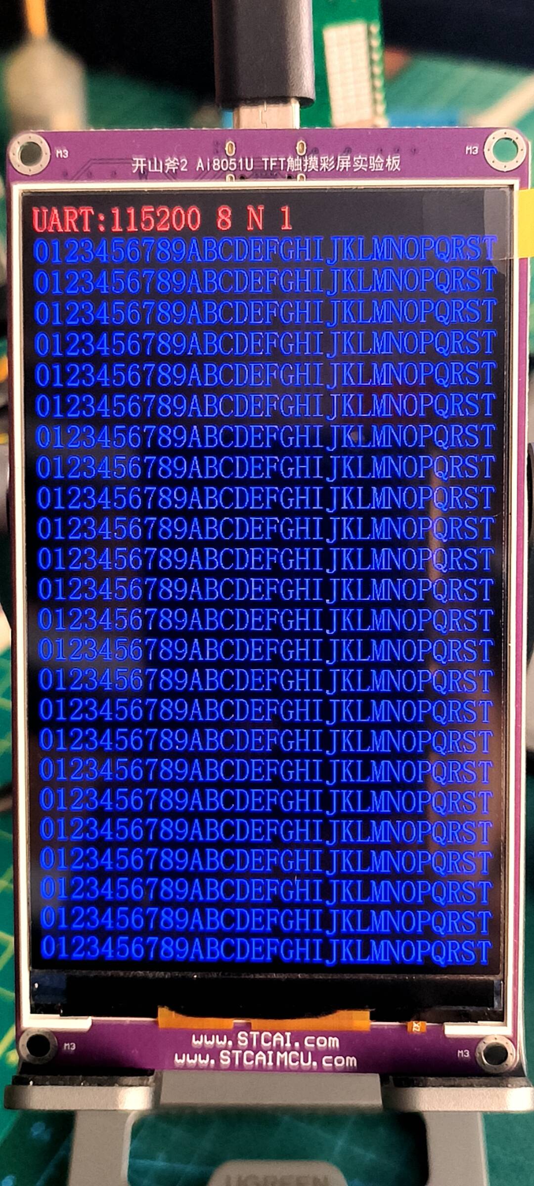

发表于 2025-3-21 13:09:42 | 显示全部楼层
