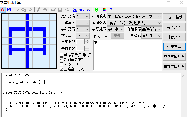

我用 PCtoLCD2002 对 “中”取模,结果如下:
{0x00,0x00,0xF0,0x10,0x10,0x10,0x10,0xFF,0x10,0x10,0x10,0x10,0xF0,0x00,0x00,0x00,0x00,0x00,0x0F,0x04,0x04,0x04,0x04,0xFF,0x04,0x04,0x04,0x04,0x0F,0x00,0x00,0x00},/*"中",0*/
用STC的字库生成工具,结果如下:
{0x01,0x00,0x01,0x00,0x01,0x00,0x01,0x00,0x3F,0xF8,0x21,0x08,0x21,0x08,0x21,0x08, 0x21,0x08,0x21,0x08,0x3F,0xF8,0x21,0x08,0x01,0x00,0x01,0x00,0x01,0x00,0x01,0x00, /*'中',0*/
好像完全不一样

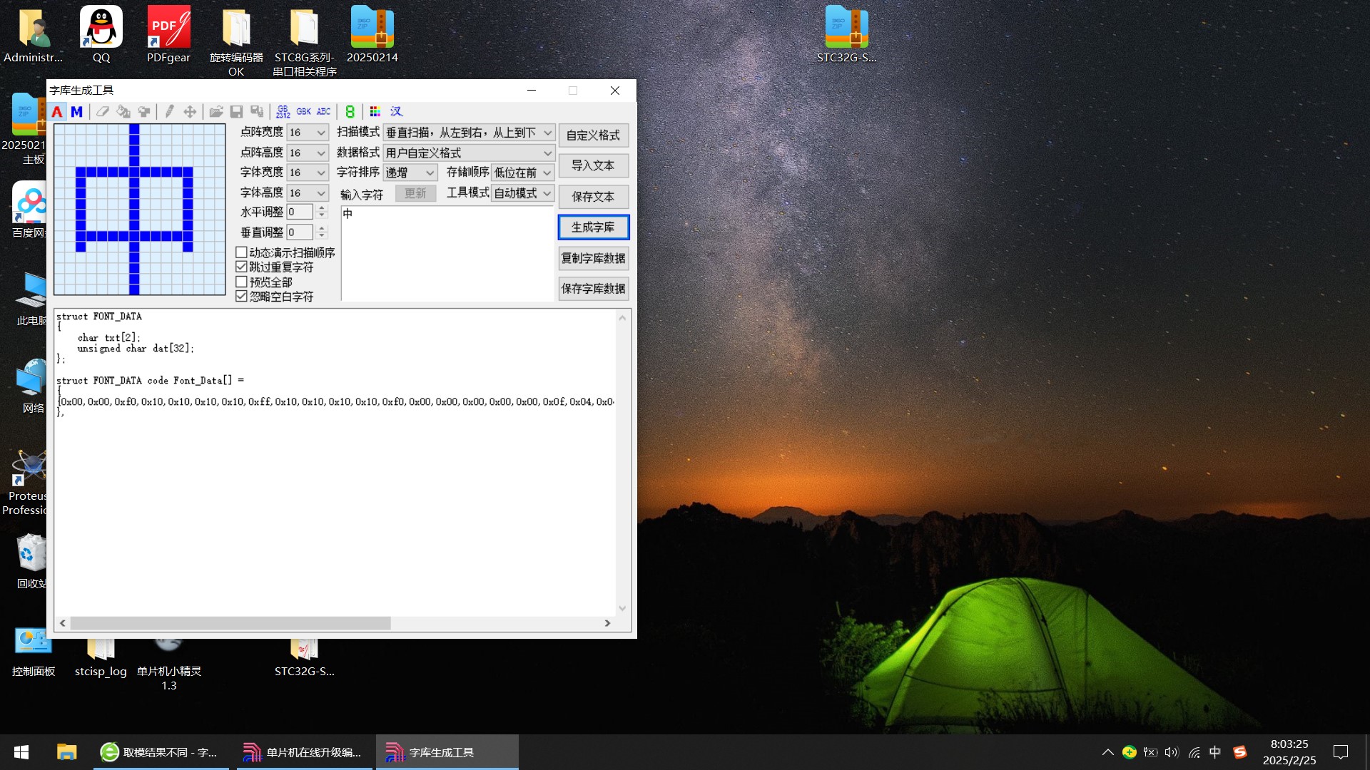

发表于 2025-2-25 08:04:19 | 显示全部楼层
你的扫描模式不一样。。这样是不是完全一样

发表于 2025-2-25 09:10:47 | 显示全部楼层
谁说的这两个软件的默认配置就得是一致的....wunai
