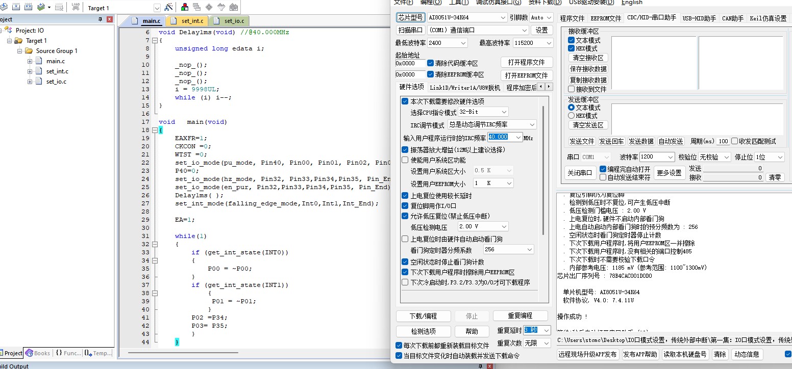

打卡第一集  I/O口模式设置
#include <AI8051U.H>
#include "set_int.h"
#include "set_io.h"
#include "intrins.h"
void Delay1ms(void)        //@40.000MHz
        unsigned long edata i;
        _nop_();
        _nop_();
        _nop_();
        i = 9998UL;
        while (i) i--;
void   main(void)
        EAXFR=1;
    CKCON =0;
        WTST =0;
        set_io_mode(pu_mode, Pin40, Pin00, Pin01, Pin02, Pin03,Pin_End);
        P40=0;
    set_io_mode(hz_mode, Pin32, Pin33,Pin34,Pin35, Pin_End);
    set_io_mode(en_pur, Pin32,Pin33,Pin34,Pin35, Pin_End);
        Delay1ms( );
        set_int_mode(falling_edge_mode,Int0,Int1,Int_End);
        EA=1;
    while(1)
                if (get_int_state(INT0))
            P00 = ~P00;
                if (get_int_state(INT1))
                         P01 = ~P01;
        P02 =P34;
                P03= P35;
IO口模式设置,传统外部中断.zip

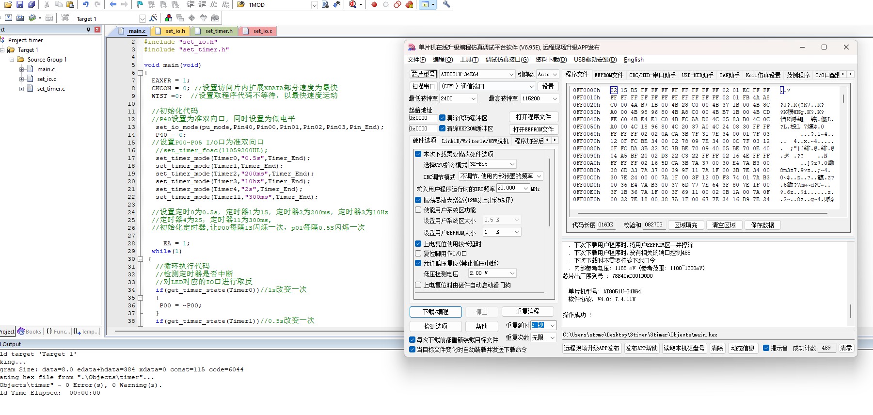

打卡第三集  24位定时器
#include "set_io.h"
#include "set_timer.h"
void main(void)
        EAXFR = 1;
        CKCON = 0; //设置访问片内扩展XDATA部分速度为最快
        WTST =0;        //设置取程序代码不等待,以最快速度运动
        //初始化代码
        //P40设置为准双向口,同时设置为低电平
         set_io_mode(pu_mode,Pin40,Pin00,Pin01,Pin02,Pin03,Pin_End);
         P40 = 0;
        //设置P00~P05 I/O口为准双向口
         //set_timer_fosc(11059200UL);
         set_timer_mode(Timer0,"0.5s",Timer_End);
         set_timer_mode(Timer1,Timer_End);
         set_timer_mode(Timer2,"200ms",Timer_End);
         set_timer_mode(Timer3,"10hz",Timer_End);
         set_timer_mode(Timer4,"2s",Timer_End);
         set_timer_mode(Timer11,"300ms",Timer_End);
        //设置定时0为0.5s,定时器1为1S,定时器2为200ms,定时器3为10Hz
        //定时器4为2S,定时器11为300ms,
        //初始化定时器,让P00每隔1S闪烁一次,p01每隔0.5S闪烁一次
           EA = 1;
  while(1)
         //循环执行代码
         //检测定时器是否中断
         //对LED对应的IO口进行取反
         if(get_timer_state(Timer0))//1s改变一次
                P00 = ~P00;
         if(get_timer_state(Timer1))//0.5s改变一次
                P01 = ~P01;
         if(get_timer_state(Timer2))
                P02 = ~P02;
                 if(get_timer_state(Timer3))
                P03 = ~P03;
                 if(get_timer_state(Timer4))
                P04 = ~P04;
         if(get_timer_state(Timer11))
                P05 = ~P05;
e6de830ece9a15076a08eecb3c1384df.mp4
859.26 KB, 下载次数: 45
timer.zip
104.06 KB, 下载次数: 47
