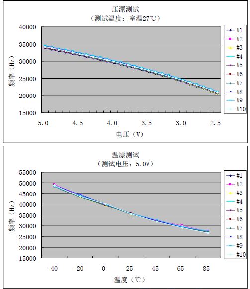

To measure temperature, there is no ADC pathway I can see.
I did find this info below, on IRC32k, and it has a strong temperature and voltage effect, so a regulated Vcc can give temperature from kHz, but there seems to be no means in STC8 to read both 32.768kHz Xtal and the IRC32K ?
No timers can capture from 32k sources, and RTC is only Xtal  or  IRC32K ?
Looks like the external Temperature Sensor choices are an NTC for ~1c and also run the ADC on 1 pin, or a ~20c semiconductor sensor on 1 or 2 pins.

Thanks, yes that's an example using an external NTC for temperature sense, and it uses floating point calc (log) to curve fit.
TI has some good notes on Code size / power / resource for floating point on NTC and other sensors
https://www.ti.com/lit/an/snoaa12/snoaa12.pdf
If this is used to correct a parabolic crystal error of RTC, it may be simplest to simply create a LUT that applies both NTC and parabola corrections in one pass.
