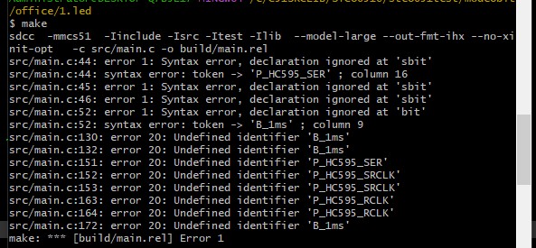

  1. #ifdef __SDCC
  2. #define    P_HC595_SER     P34  //pin 14    SER     data input
  3. #define    P_HC595_RCLK    P35  //pin 12    RCLk    store (latch) clock
  4. #define    P_HC595_SRCLK   P32  //pin 11    SRCLK   Shift data clock
  5. #else
  6. sbit    P_HC595_SER   = P3^4;   //pin 14    SER     data input
  7. sbit    P_HC595_RCLK  = P3^5;   //pin 12    RCLk    store (latch) clock
  8. sbit    P_HC595_SRCLK = P3^2;   //pin 11    SRCLK   Shift data clock
  9. #endif

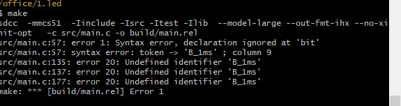

所有sbit定义的地方都需修改为#define宏定义,没修改一般编译的错误如下图
  1. bit B_1ms;          //1ms标志
  2. 修改为
  3. BOOL B_1ms;          //1ms标志
未修改编译错误
