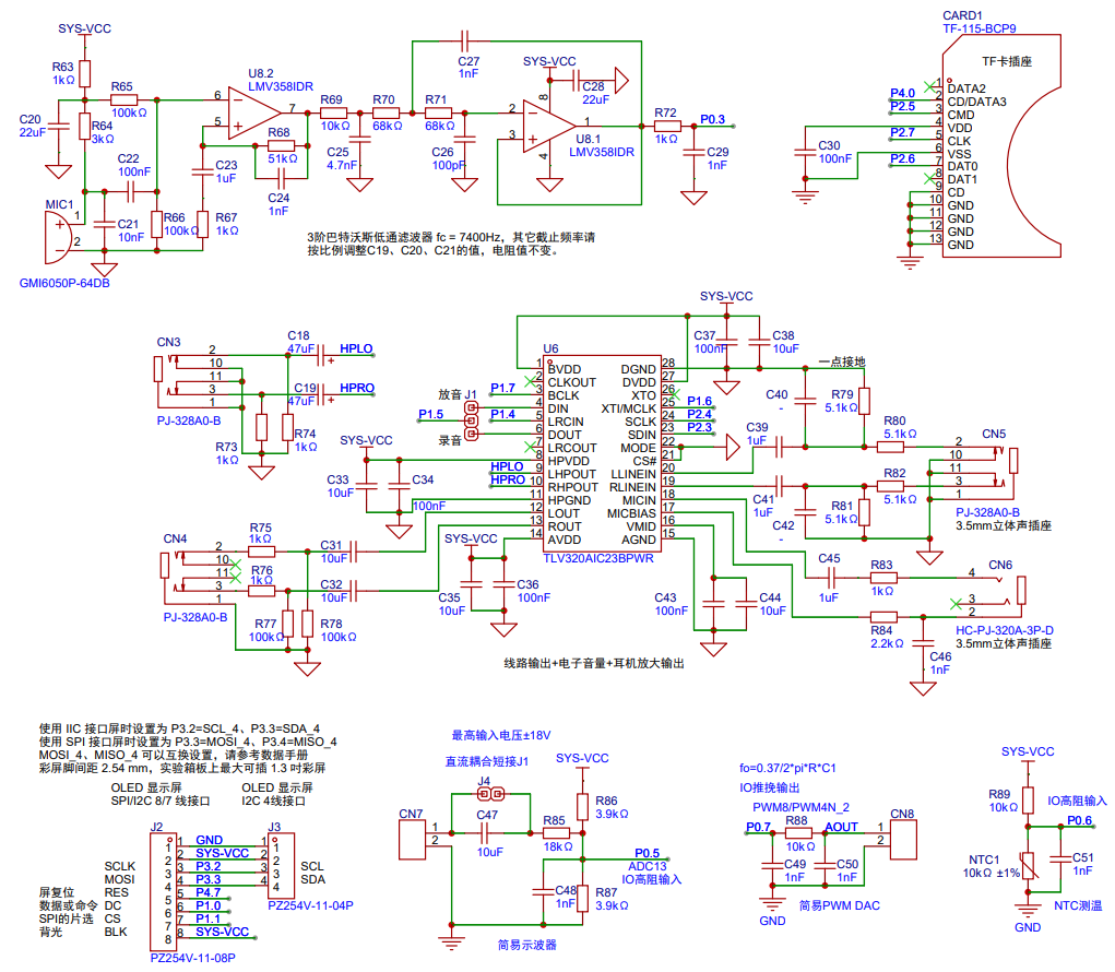

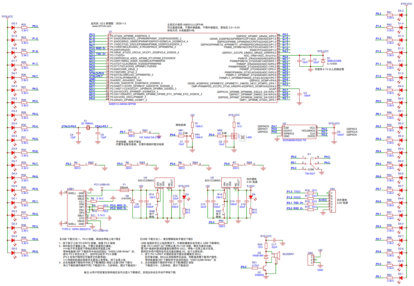

擎天柱3:
Ai8051U-音频FFT示波器USB实验板-V1.0
讨论稿
擎天柱3: Ai8051U-音频FFT示波器USB实验板-V1.0,讨论稿-1.png
擎天柱3: Ai8051U-音频FFT示波器USB实验板-V1.0,讨论稿-2.png
