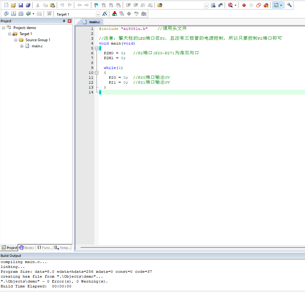

第3集:点亮第一颗LED
代码:
#include "ai8051u.h"        //调用头文件
//注意:擎天柱的LED端口在P2,且没有三极管的电源控制,所以只要控制P2端口即可
void main(void)
    P2M0 = 0;        //P2端口(P20-P27)为准双向口
    P2M1 = 0;
    while(1)
        P20 = 0;    //P20端口输出0V
        P21 = 0;    //P21端口输出0V

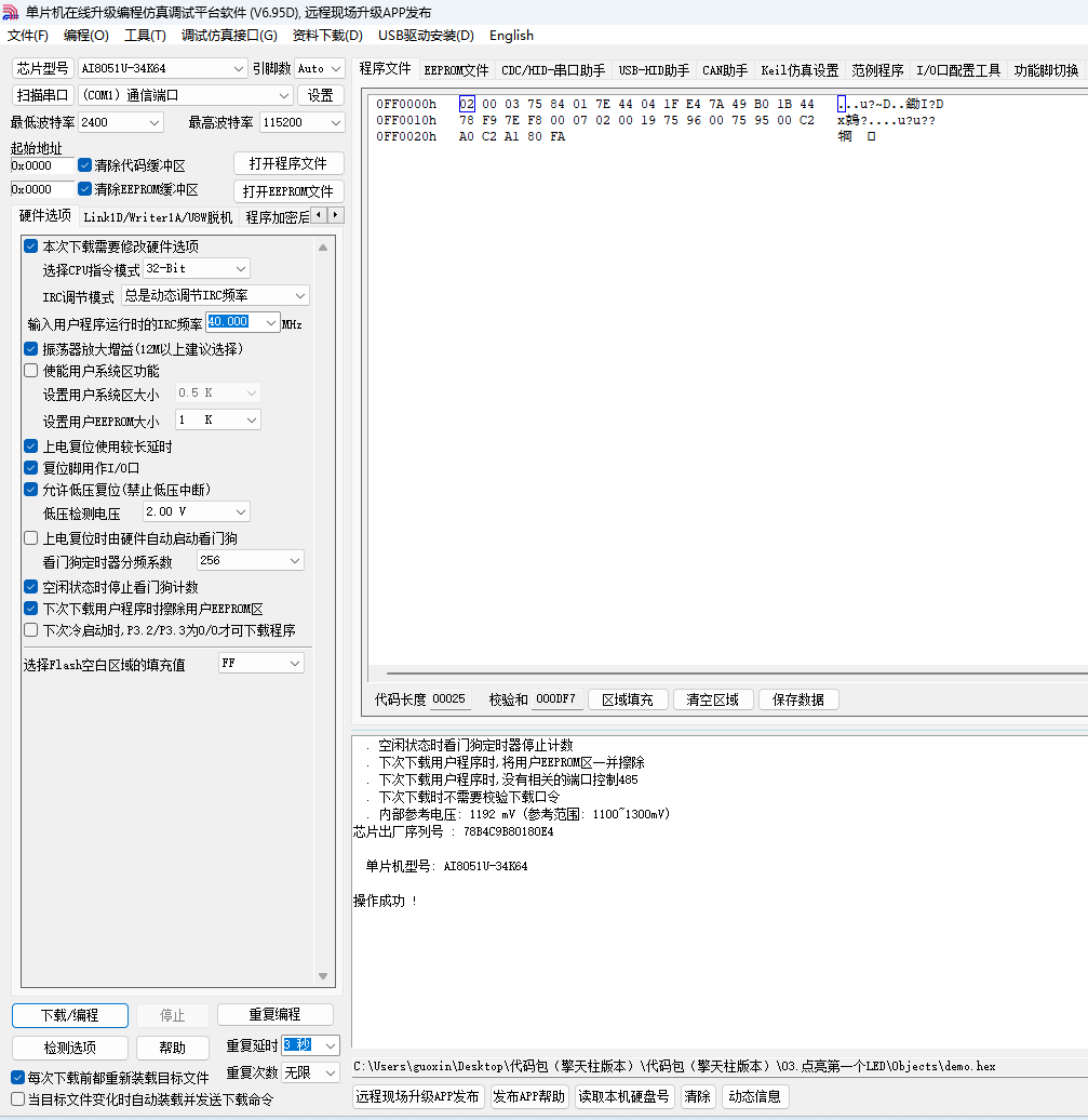

KEIL编译:
下载成功:

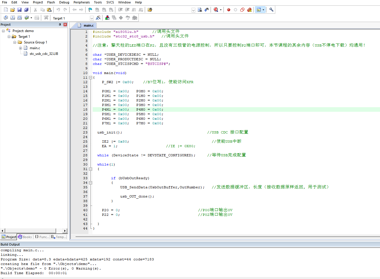

第4集:USB不停电下载
代码:
#include "stc32_stc8_usb.h"
char *USER_DEVICEDESC = NULL;
void main(void)
    P_SW2 |= 0x80;
    P0M1 = 0x00;   P0M0 = 0x00;
    P1M1 = 0x00;   P1M0 = 0x00;
    P2M1 = 0x00;   P2M0 = 0x00;
    P3M1 = 0x00;   P3M0 = 0x00;
    P4M1 = 0x00;   P4M0 = 0x00;
    P5M1 = 0x00;   P5M0 = 0x00;
    P6M1 = 0x00;   P6M0 = 0x00;
    P7M1 = 0x00;   P7M0 = 0x00;
    usb_init();
    IE2 |= 0x80;
    EA = 1;
    while (DeviceState != DEVSTATE_CONFIGURED);
    while(1)
        if (bUsbOutReady)
            USB_SendData(UsbOutBuffer,OutNumber);
            usb_OUT_done();
        P20 = 0;
        P22 = 0;

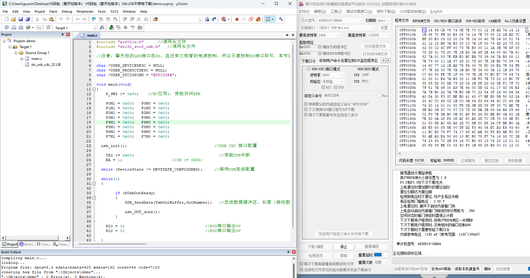

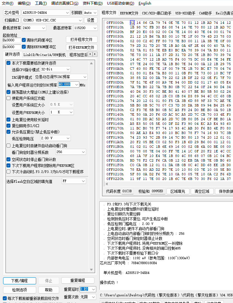

编译:
不停电下载学习图:
