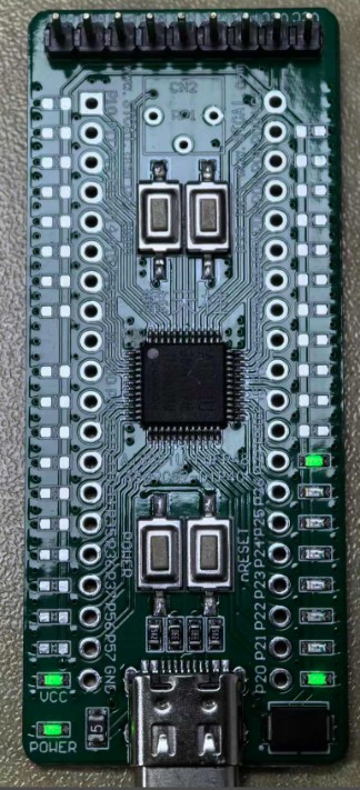

发表于 2024-12-31 11:25:47 | 显示全部楼层 |阅读模式
第三集:擎天柱点亮LED灯,测试通过:
#include "ai8051u.h"                //调用头文件
void main(void)
        P2M0 = 0;
        P2M1 = 0;
        while(1)
                P20 = 0;
                P27 = 0;

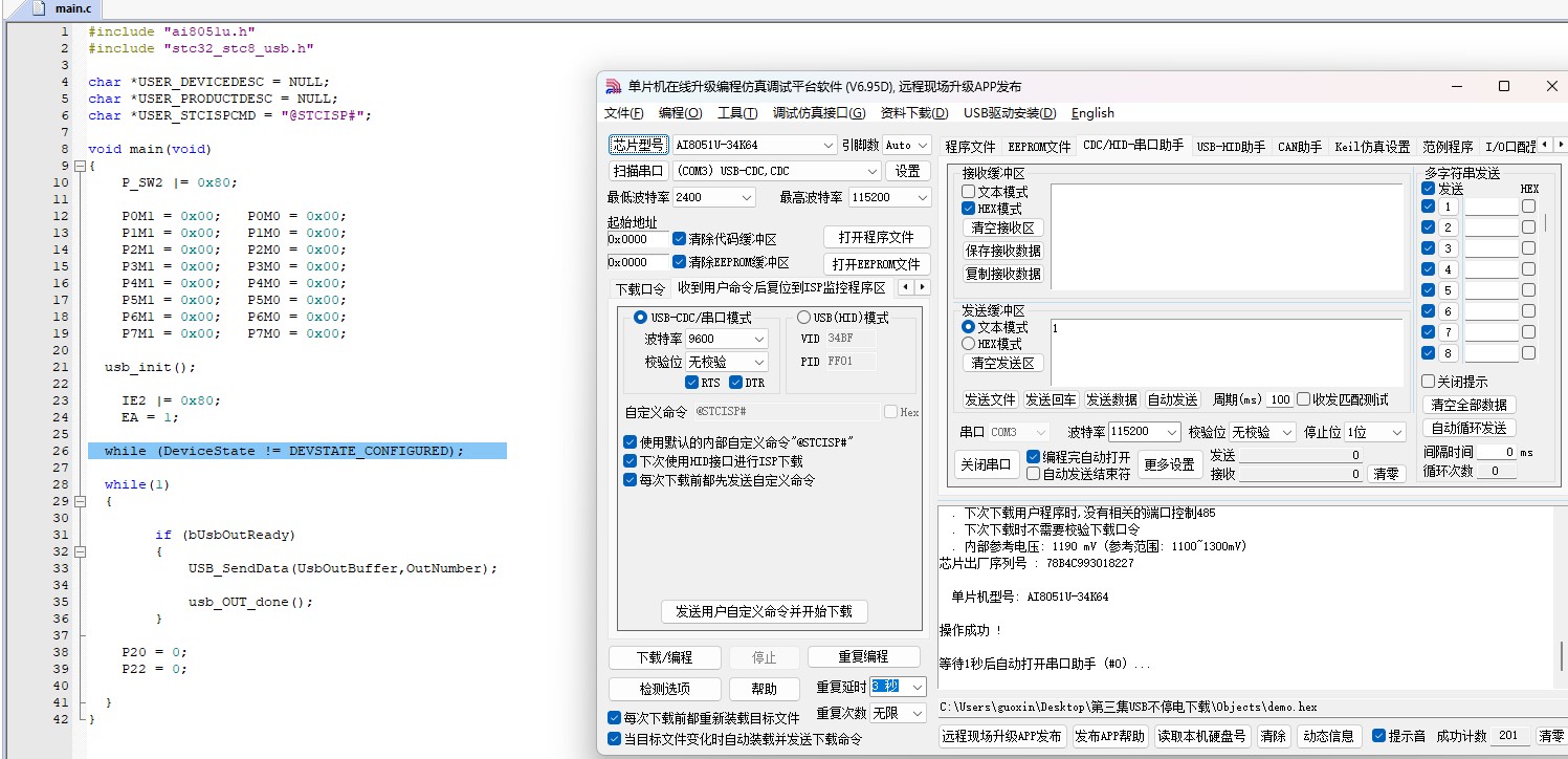

发表于 2024-12-31 11:46:05 | 显示全部楼层
第四集  不停电下载  代码成功
#include "stc32_stc8_usb.h"
char *USER_DEVICEDESC = NULL;
void main(void)
    P_SW2 |= 0x80;
    P0M1 = 0x00;   P0M0 = 0x00;
    P1M1 = 0x00;   P1M0 = 0x00;
    P2M1 = 0x00;   P2M0 = 0x00;
    P3M1 = 0x00;   P3M0 = 0x00;
    P4M1 = 0x00;   P4M0 = 0x00;
    P5M1 = 0x00;   P5M0 = 0x00;
    P6M1 = 0x00;   P6M0 = 0x00;
    P7M1 = 0x00;   P7M0 = 0x00;
        usb_init();
    IE2 |= 0x80;
    EA = 1;
        while (DeviceState != DEVSTATE_CONFIGURED);
        while(1)
        if (bUsbOutReady)
            USB_SendData(UsbOutBuffer,OutNumber);
            usb_OUT_done();
                P20 = 0;
                P22 = 0;
第四集USB不停电下载.zip (94.92 KB, 下载次数: 75)

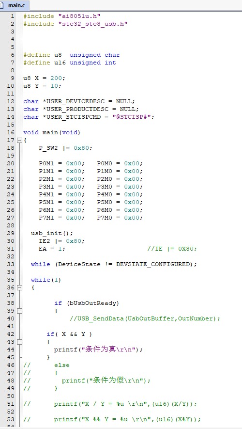

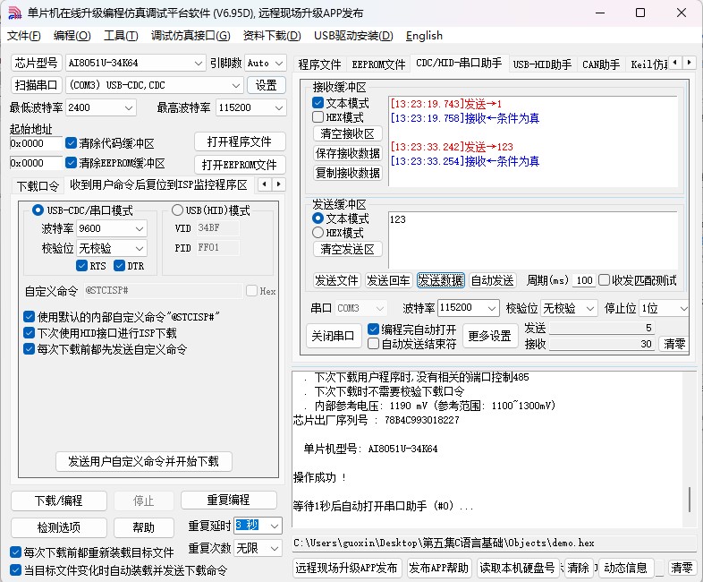

发表于 2024-12-31 13:24:25 | 显示全部楼层
第5集 C语言基础
程序:
#define u8  unsigned char
#define u16 unsigned int
u8 X = 200;
u8 Y = 10;
void main(void)
    P_SW2 |= 0x80;
        usb_init();
    IE2 |= 0x80;
    EA = 1;                                                                                        //IE |= 0X80;
        while(1)
        if (bUsbOutReady)
            //USB_SendData(UsbOutBuffer,OutNumber);
                        if( X && Y )
                                printf("条件为真\r\n");
//                        else
//                                printf("条件为假\r\n");
//                        printf("X / Y = %u \r\n",(u16)(X/Y));
//                        printf("X %% Y = %u \r\n",(u16)(X%Y));
            usb_OUT_done();
第五集C语言基础.zip (95.2 KB, 下载次数: 63)

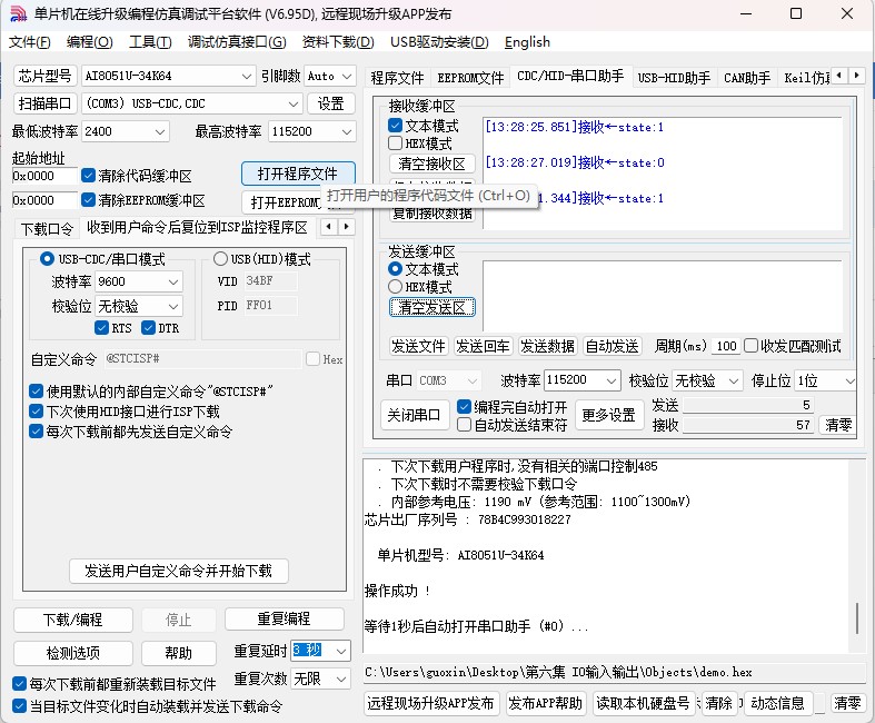

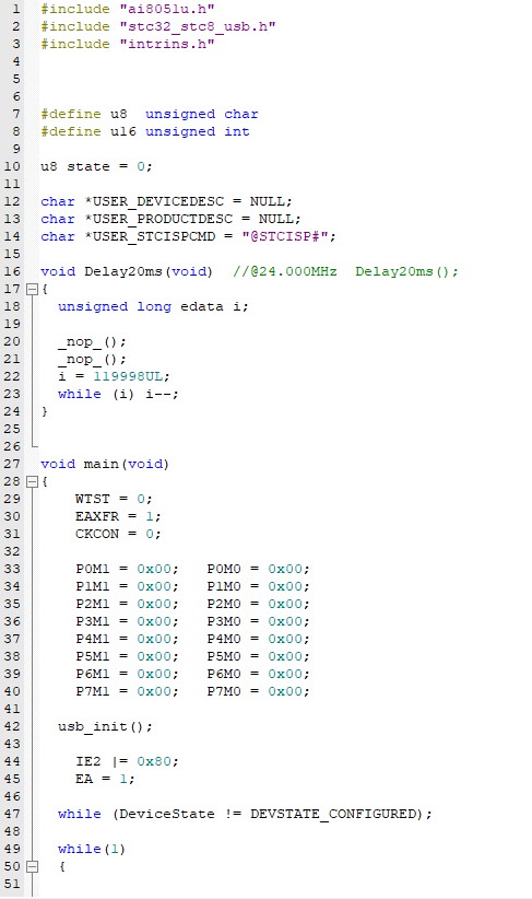

发表于 2024-12-31 13:30:27 | 显示全部楼层
第六集  IO 输入输出   代码测试成功
代码:
#include "intrins.h"
u8 state = 0;
void Delay20ms(void)        //@24.000MHz  Delay20ms();
        unsigned long edata i;
        _nop_();
        _nop_();
        i = 119998UL;
        while (i) i--;
void main(void)
    WTST = 0;
    EAXFR = 1;
    CKCON = 0;
        usb_init();
    IE2 |= 0x80;
    EA = 1;
        while(1)
        if (bUsbOutReady)
            usb_OUT_done();
//                //任务1:按下P32按钮灯亮,松开P32按钮灯灭;
//                if( P32 == 0 )                                                                //判断P32按钮是否按下
//                        P20 = 0;
//                else
//                        P20 = 1;
                //任务2:按下P32按钮灯灭,松开P32按钮灯亮;
//                if( P32 == 1 )                                                                //判断P32按钮是否按下
//                        P20 = 0;
//                else
//                        P20 = 1;
                //任务3:按一下灯亮,按一下灯灭
                        Delay20ms();                                                        //延时20ms消抖
                        if( P32 == 0 )
                                state = !state;
                                P20 = state;
                                printf("state:%d\r\n",(int)state);
                                while( P32 == 0 );                                        //等待P32松开
