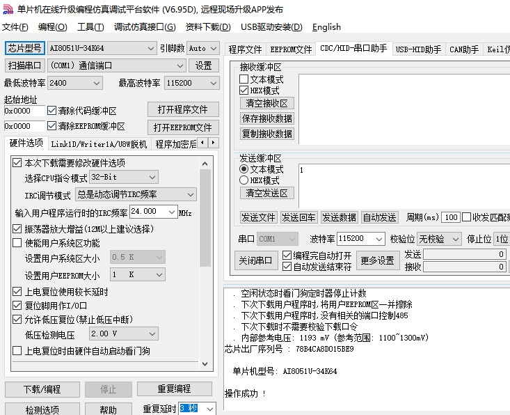

第四集:
擎天柱USB-CDC 不停电下载,测试OK
程序如下:

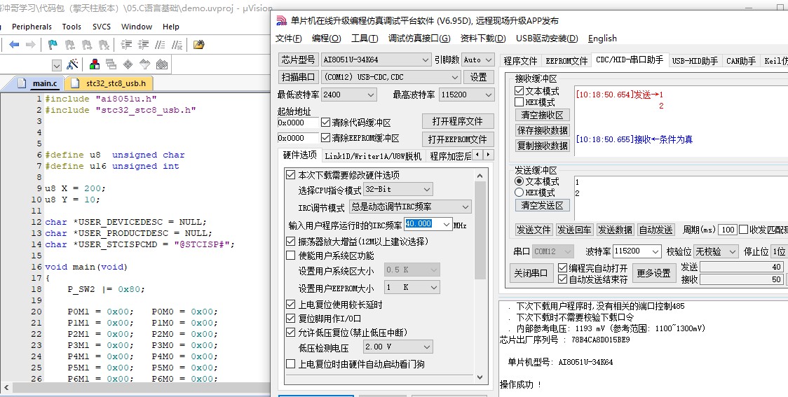

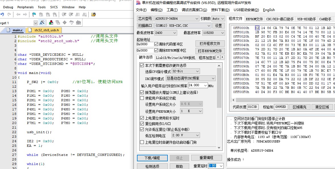

第五集:擎天柱 C语言基础已学习,测试OK:
1,编译图片:
#include "ai8051u.h"
#include "stc32_stc8_usb.h"
#define u8  unsigned char
#define u16 unsigned int
u8 X = 200;
u8 Y = 10;
char *USER_DEVICEDESC = NULL;
void main(void)
    P_SW2 |= 0x80;
    P0M1 = 0x00;   P0M0 = 0x00;
    P1M1 = 0x00;   P1M0 = 0x00;
    P2M1 = 0x00;   P2M0 = 0x00;
    P3M1 = 0x00;   P3M0 = 0x00;
    P4M1 = 0x00;   P4M0 = 0x00;
    P5M1 = 0x00;   P5M0 = 0x00;
    P6M1 = 0x00;   P6M0 = 0x00;
    P7M1 = 0x00;   P7M0 = 0x00;
        usb_init();
    IE2 |= 0x80;
    EA = 1;                                                                                        //IE |= 0X80;
        while (DeviceState != DEVSTATE_CONFIGURED);     //等待USB完成配置
        while(1)
        if (bUsbOutReady)                                                        //如果接收到了数据
            //USB_SendData(UsbOutBuffer,OutNumber);   //发送数据缓冲区,长度(接收数据原样返回, 用于测试)
                        if( X && Y )
                                printf("条件为真\r\n");
//                        else
//                                printf("条件为假\r\n");
//                        printf("X / Y = %u \r\n",(u16)(X/Y));
//                        printf("X %% Y = %u \r\n",(u16)(X%Y));
            usb_OUT_done();                                                        //
C语言基础.zip (86.78 KB, 下载次数: 96)

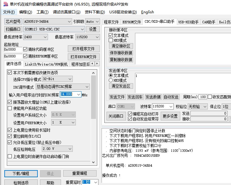

第六集:擎天柱IO输入输出,测试通过:
#include "ai8051u.h"                        //调用头文件
#include "stc32_stc8_usb.h"                //调用头文件
#include "intrins.h"                        //d调用头文件
u8 state = 0;
void Delay20ms(void)        //@24.000MHz  Delay20ms();
        unsigned long edata i;
        _nop_();
        _nop_();
        i = 119998UL;
        while (i) i--;
void main(void)
    WTST = 0;
    EAXFR = 1;
    CKCON = 0;
        usb_init();
    IE2 |= 0x80;
    EA = 1;
        while(1)
        if (bUsbOutReady)
            usb_OUT_done();
//                //任务1:按下P32按钮灯亮,松开P32按钮灯灭;
//                if( P32 == 0 )                                                                //判断P32按钮是否按下
//                        P20 = 0;
//                else
//                        P20 = 1;
                //任务2:按下P32按钮灯灭,松开P32按钮灯亮;
//                if( P32 == 1 )                                                                //判断P32按钮是否按下
//                        P20 = 0;
//                else
//                        P20 = 1;
                //任务3:按一下灯亮,按一下灯灭
                        Delay20ms();                                                        //延时20ms消抖
                        if( P32 == 0 )
                                state = !state;                                                //变量取反 0 1 0 1 0 1
                                P20 = state;
                                printf("state:%d\r\n",(int)state);
                                while( P32 == 0 );                                        //等待P32松开
IO输入输出.zip (88.39 KB, 下载次数: 97)

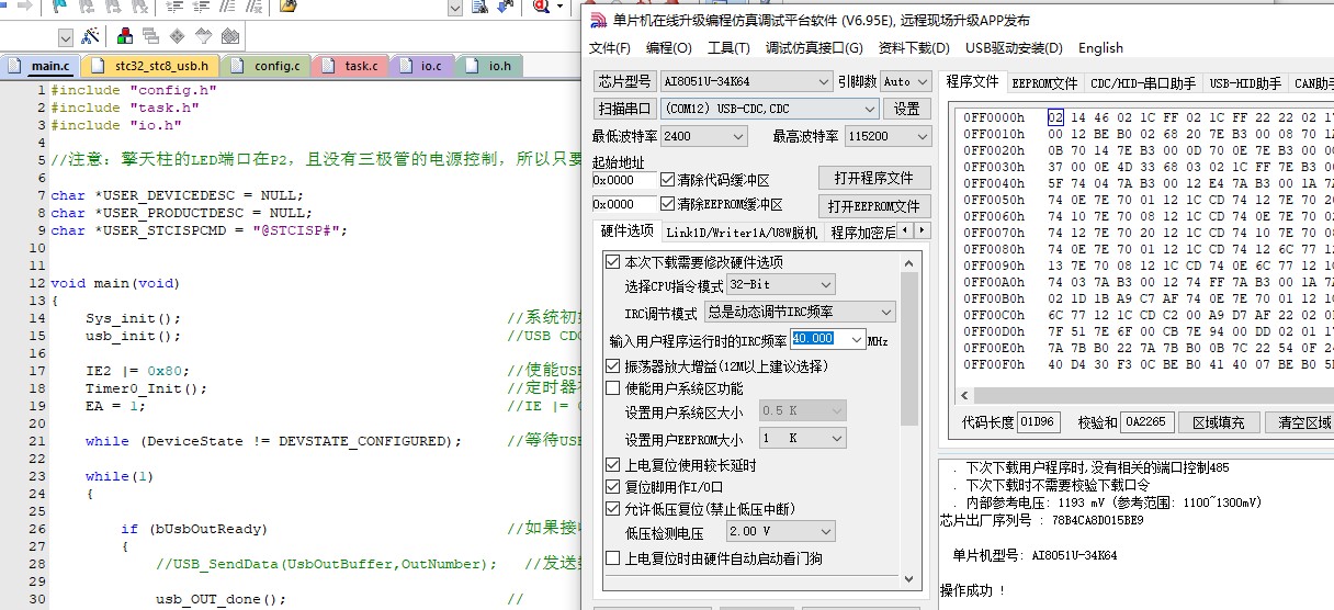

发表于 2025-1-3 11:29:49 | 显示全部楼层
第7集 定时器中断,打卡OK
u8 state = 0;
u8 Run_State = 0;
        _nop_();
        _nop_();
        i = 119998UL;
        while (i) i--;
void Timer0_Init(void);                //3秒@24.000MHz                //函数声明
void main(void)
        int count=1;                                                                        //按键计数变量
    WTST = 0;                                                                                  //设置程序指令延时参数,赋值为0可将CPU执行指令的速度设置为最快
    EAXFR = 1;                                                                                 //扩展寄存器(XFR)访问使能
    CKCON = 0;                                                                                 //提高访问XRAM速度
        usb_init();                                     //USB CDC 接口配置
    IE2 |= 0x80;                                    //使能USB中断
//        Timer0_Init();                                                                        //定时器初始化
        P40 = 0;
        while(1)
            usb_OUT_done();                                                        //
                //任务1:
//                        Delay20ms();                                                        //延时20ms消抖
//                        if( P32 == 0 )
//                                printf("按键按下次数\xfd:%d 次\r\n",(int)count);
//                                count++;
//                                while( P32 == 0 );                                        //等待P32松开
//                //任务2:灯按一下点亮三秒后熄灭。
                        if( P32 == 0 )
//                                count++;
                                P20 = 0;
                                Timer0_Init();
                //任务3:救护车灯控制器,按下报警按钮,红蓝交替闪烁(LED1和LED2              表示红和蓝灯),再按一下报警按钮,红蓝灯停止。
                        if( P32 == 0 )
                                Run_State = !Run_State;                                //运行状态取反
                                if( Run_State==1 )                                        //运行
                                        Timer0_Init();
                                else
                                        TR0 = 0;                                                //关闭定时器
                                        P20 = 1;
                                        P21 = 1;
//void Timer0_Init(void)                //3秒@24.000MHz        函数定义
//        TM0PS = 0x5B;                        //设置定时器时钟预分频 ( 注意:并非所有系列都有此寄存器,详情请查看数据手册 )
//        AUXR &= 0x7F;                        //定时器时钟12T模式
//        TMOD &= 0xF0;                        //设置定时器模式
//        TL0 = 0x3F;                                //设置定时初始值
//        TH0 = 0x01;                                //设置定时初始值
//        TF0 = 0;                                //清除TF0标志
//        TR0 = 1;                                //定时器0开始计时
//        ET0 = 1;                                //使能定时器0中断
//        //TM0PS = 91
//        //12T                 /12
//        // THO-TL0 = 319
void Timer0_Init(void)                //500毫秒@24.000MHz
        TM0PS = 0x0F;                        //设置定时器时钟预分频 ( 注意:并非所有系列都有此寄存器,详情请查看数据手册 )
        TL0 = 0xDC;                                //设置定时初始值
        TH0 = 0x0B;                                //设置定时初始值
        TF0 = 0;                                //清除TF0标志
        TR0 = 1;                                //定时器0开始计时
        ET0 = 1;                                //使能定时器0中断
void Timer0_Isr(void) interrupt 1                //3秒执行一次
        state = !state;
        P20 = state;
        P21 = !state;

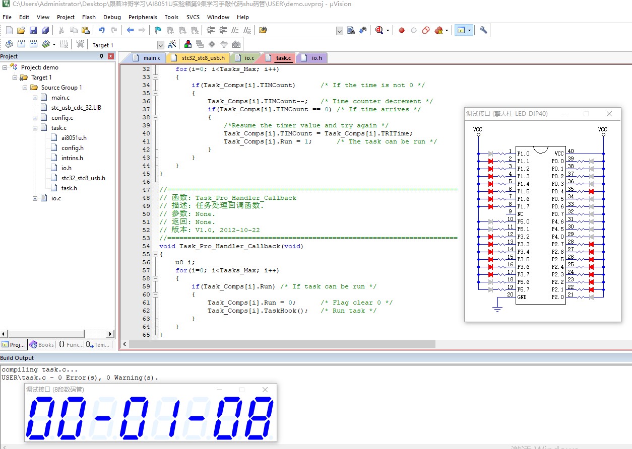

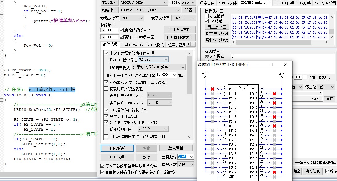

发表于 2025-1-15 14:07:40 | 显示全部楼层
第8集 定时器周期性调度任务
#include "io.h"
u8 State1 = 0;                                        //LED1初始状态
u8 State2 = 0;                                        //LED2初始状态
u8 State3 = 0;                                        //LED3初始状态
u16 Key_Vol[3] ;                                //按键按下持续时间
void LED0_Blink(void)
        State1 = !State1;
        P20 = State1;
void LED1_Blink(void)
        State2 = !State2;
        P21 = State2;
void LED2_Blink(void)
        State3 = !State3;
        P22 = State3;
void KEY_Task(void)
        if( P32 == 0 )
                Key_Vol[0]++;
                if( Key_Vol[0]==5 )
                        //按键按下的任务
                        printf( "按键单击\r\n" );
        else
                Key_Vol[0] = 0;
08.定时器周期性调度任务.zip (148.52 KB, 下载次数: 80)

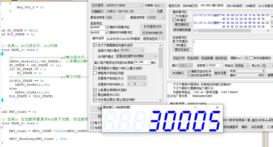

发表于 2025-1-15 14:11:25 | 显示全部楼层

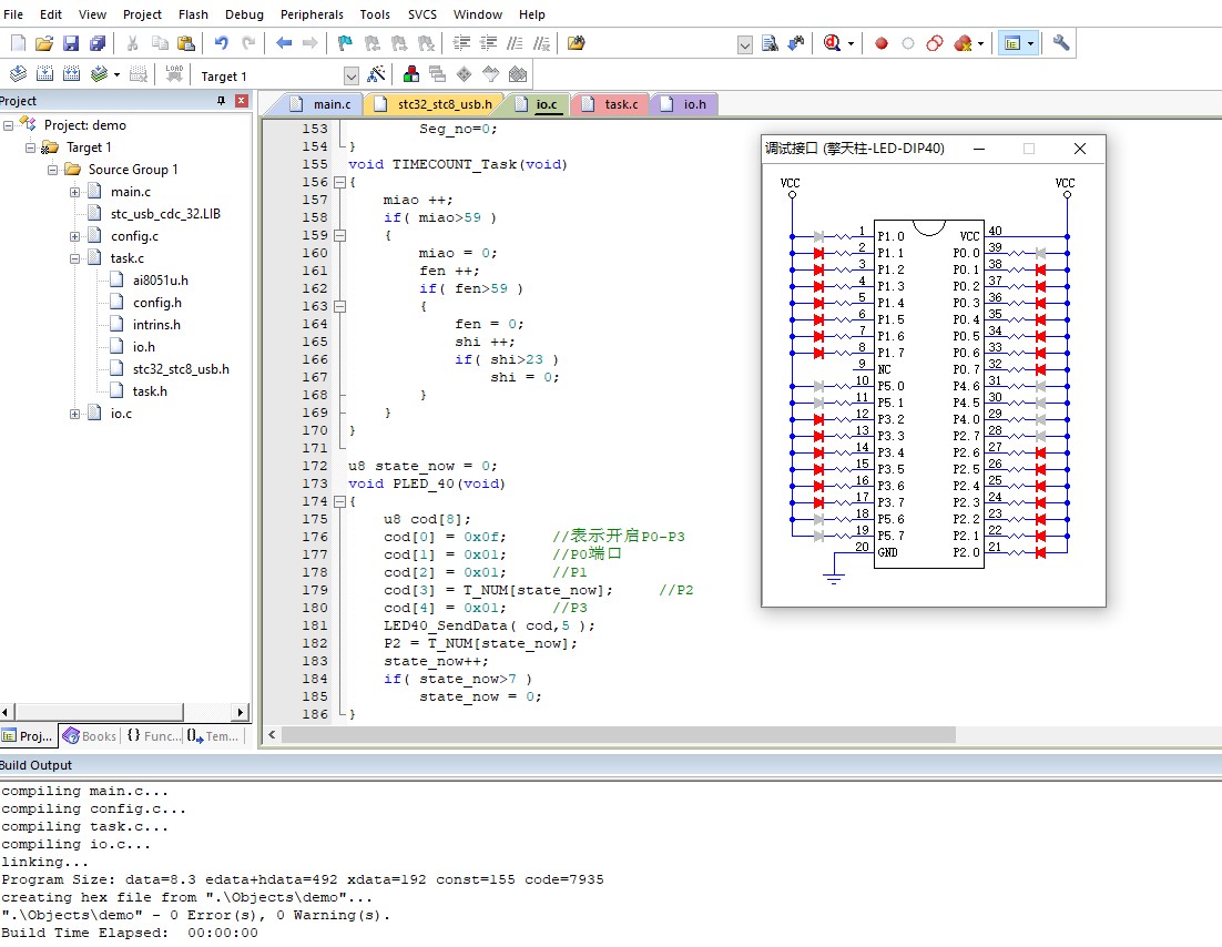

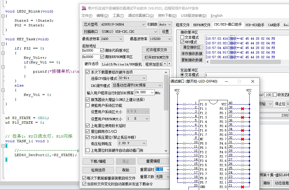

擎天柱 虚拟显示-LED,P2流水灯效果
io.c
#include "io.h"
u8 SEG_NUM[]=
    0x3F,       /*'0', 0*/
    0x06,       /*'1', 1*/
    0x5B,       /*'2', 2*/
    0x4F,       /*'3', 3*/
    0x66,       /*'4', 4*/

void PLED_40(void)
        u8 cod[8];
        cod[0] = 0x0f;     //表示开启P0-P3
        cod[1] = 0x01;     //P0端口
        cod[2] = 0x01;     //P1
        cod[3] = T_NUM[state_now];     //P2
        cod[4] = 0x01;     //P3
        LED40_SendData( cod,5 );
        P2 = T_NUM[state_now];
        state_now++;
        if( state_now>7 )
                state_now = 0;
Task.c

擎天柱-虚拟显示-LED,P2流水灯效果(续)

第十集:虚拟LED和数码管
擎天柱/AI8051U转89C52-DIP40核心功能板V1.1打卡
任务1.(1)点亮P2口端口
void TASK_1( void )
    //-------------------------p2端口流水灯------------------------
    LED40_SetPort(2,~P2_STATE);  //点亮P20端口
(2)P2口流水灯,P10闪烁
void TASK_1( void )
    P2_STATE = (P2_STATE << 1);
    if( P2_STATE == 0 )
        P2_STATE = 1;
    //-------------------------p1端口闪烁------------------------
    if(P10_STATE == 0)
       LED40_SetBit(1,0);
    else
       LED40_ClrBit(1,0);
    P10_STATE = !P10_STATE;
任务2.左边数码管显示P32按下次数,右边数码管显示P33按下次数
#include "io.h"
u16 Key_Vol = 0;  //按键按下持续时间
u16 Key_Vol_2 = 0;  //按键按下持续时间
    State1 = !State1;
    P00 = State1;
    State2 = !State2;
    P01 = State2;
    State3 = !State3;
    P02 = State3;
u16 KEY1_COUNT = 0;  //p32按钮计数
u16 KEY2_COUNT = 0;  //p33按钮计数
void KEY_Task(void)
    //----------P32按钮计数---------
    if( P32 == 0)
        Key_Vol++;
        if(Key_Vol == 5)
            KEY1_COUNT++;
    else
        Key_Vol = 0;
    if( P33 == 0)
        Key_Vol_2++;
        if(Key_Vol_2 == 5)
            KEY2_COUNT++;
    else
        Key_Vol_2 = 0;
u8 P2_STATE = 0X01;
u8 P10_STATE = 0;
// 任务2:左边数码管显示P32按下次数,右边数码管显示P33按下次数
void TASK_2( void )
    KEY_Count = KEY1_COUNT *10000+KEY2_COUNT;
    SEG7_ShowLong(KEY_Count , 10);

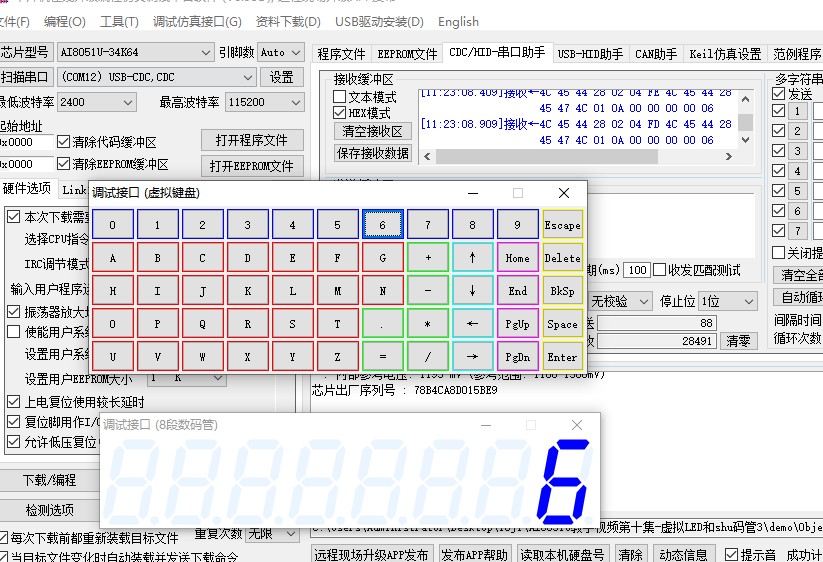

任务3:按下数字按键在数码管显示对应的按键数字
//任务3:按下数字按键在数码管显示对应的按键数字
void TASK_3( void )
    SEG7_ShowLong(REC_NUM , 10);
