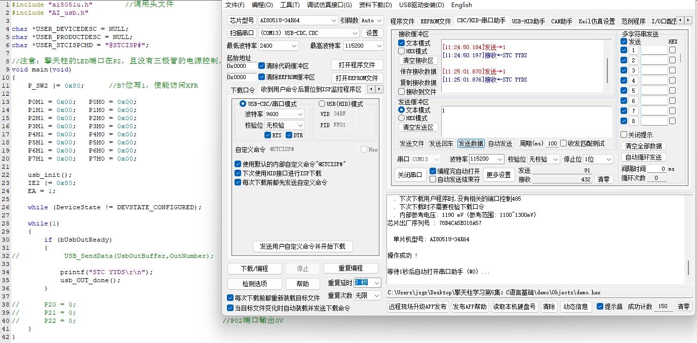

擎天柱学习记录,第3集:点亮LED灯
程序如下:
  1. #include "ai8051u.h"                //调用头文件
  2. //注意:擎天柱的LED端口在P2,且没有三极管的电源控制,所以只要控制P2端口即可
  3. void main(void)
  4. {
  5.         P2M0 = 0;                //P2端口(P20-P27)为准双向口
  6.         P2M1 = 0;
  7.
  8.         while(1)
  9.         {
  10.                 P20 = 0;        //P20端口输出0V
  11.                 P21 = 0;        //P21端口输出0V
  12.         }
  13. }

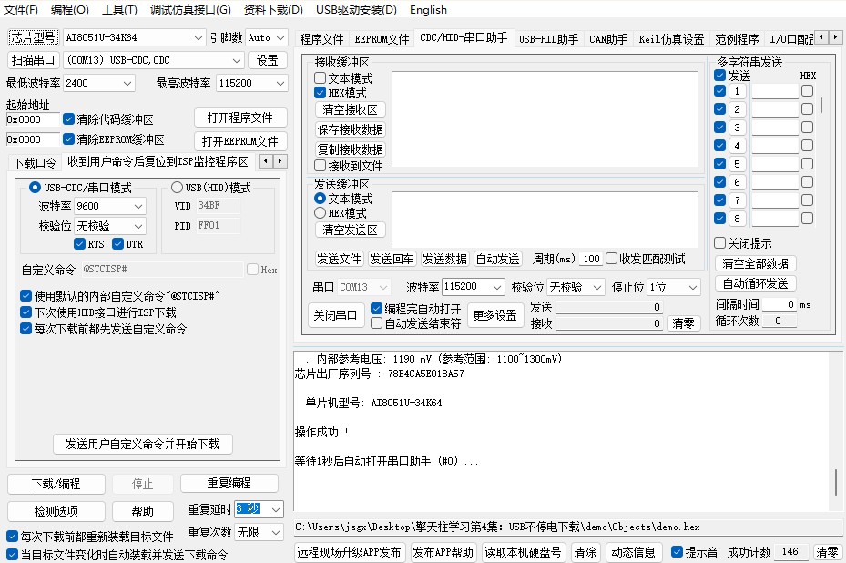

程序如下:

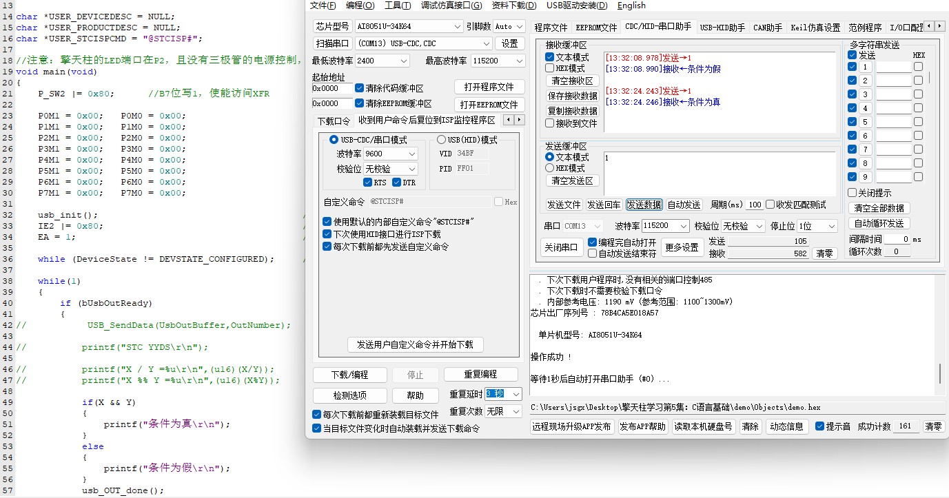

  2. #include "AI_usb.h"
  3. char *USER_DEVICEDESC = NULL;
  4. char *USER_PRODUCTDESC = NULL;
  5. char *USER_STCISPCMD = "@STCISP#";
  6. //注意:擎天柱的LED端口在P2,且没有三极管的电源控制,所以只要控制P2端口即可
  7. void main(void)
  8. {
  9.     P_SW2 |= 0x80;                //B7位写1,使能访问XFR
  10.
  11.     P0M1 = 0x00;   P0M0 = 0x00;
  12.     P1M1 = 0x00;   P1M0 = 0x00;
  13.     P2M1 = 0x00;   P2M0 = 0x00;
  14.     P3M1 = 0x00;   P3M0 = 0x00;
  15.     P4M1 = 0x00;   P4M0 = 0x00;
  16.     P5M1 = 0x00;   P5M0 = 0x00;
  17.     P6M1 = 0x00;   P6M0 = 0x00;
  18.     P7M1 = 0x00;   P7M0 = 0x00;
  19.
  20.         usb_init();                                     //USB CDC 接口配置
  21.     IE2 |= 0x80;                                    //使能USB中断
  22.     EA = 1;                                                                                        //IE |= 0X80;
  23.
  24.         while (DeviceState != DEVSTATE_CONFIGURED);     //等待USB完成配置
  25.
  26.         while(1)
  27.         {
  28.         if (bUsbOutReady)
  29.         {
  30.             USB_SendData(UsbOutBuffer,OutNumber);   //发送数据缓冲区,长度(接收数据原样返回, 用于测试)
  31.
  32.             usb_OUT_done();
  33.         }
  34.
  35.                 P20 = 0;                                        //P00端口输出0V
  36.                 P21 = 0;                                        //P01端口输出0V
  37. //                P22 = 0;                                    //P02端口输出0V
  38.         }
  39. }
擎天柱学习第4集:USB不停电下载.zip (79.85 KB, 下载次数: 55)

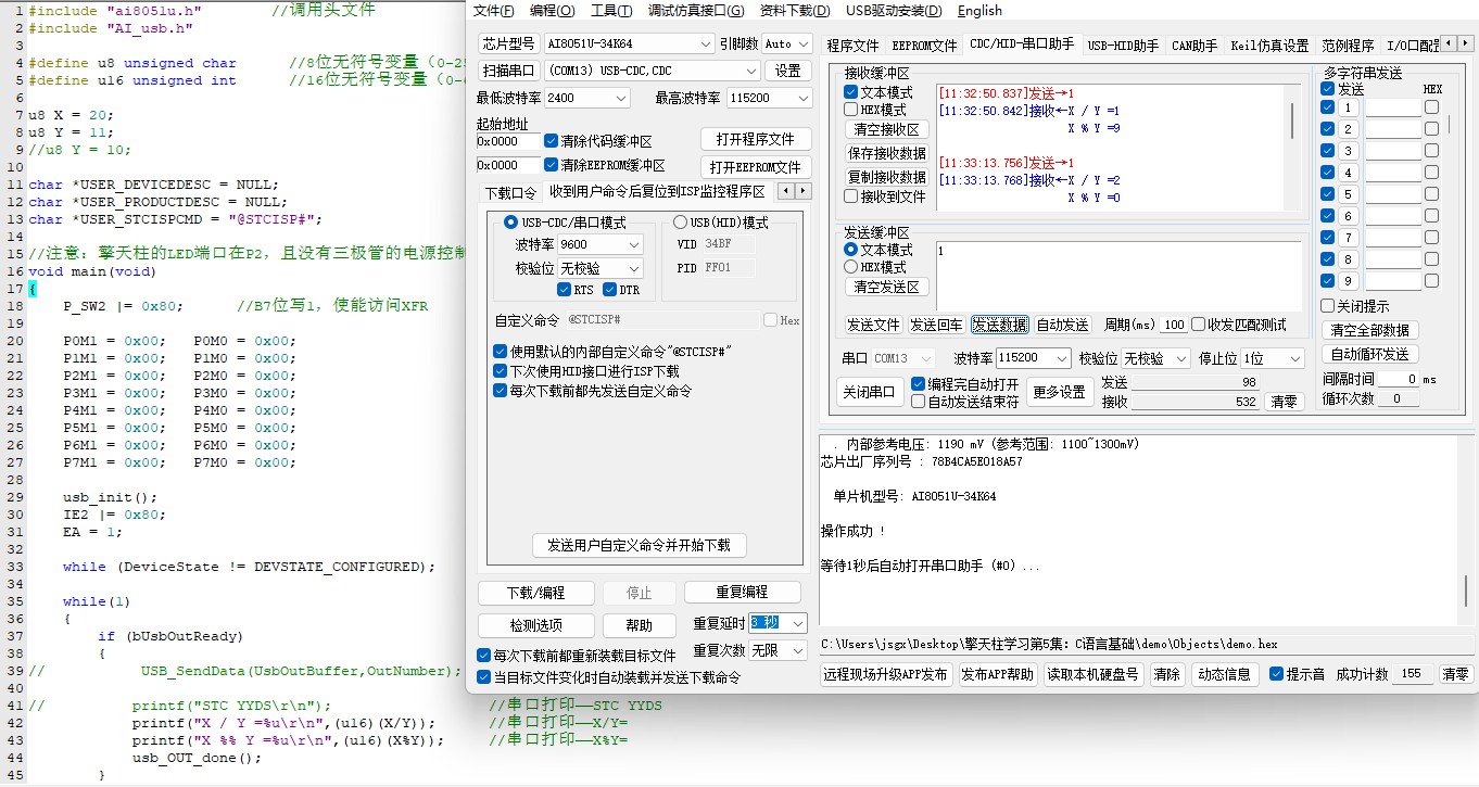

擎天柱学习记录,第5集:C语言基础
程序如下:
  3. #define u8 unsigned char      //8位无符号变量(0-255)
  4. #define u16 unsigned int      //16位无符号变量(0-65535)
  5. u8 X = 20;
  6. //u8 Y = 11;
  7. //u8 Y = 10;
  8. //u8 Y = 0;
  9. u8 Y = 10;
  10. char *USER_DEVICEDESC = NULL;
  11. char *USER_PRODUCTDESC = NULL;
  12. char *USER_STCISPCMD = "@STCISP#";
  13. //注意:擎天柱的LED端口在P2,且没有三极管的电源控制,所以只要控制P2端口即可
  14. void main(void)
  15. {
  16.     P_SW2 |= 0x80;                //B7位写1,使能访问XFR
  17.
  18.     P0M1 = 0x00;   P0M0 = 0x00;
  19.     P1M1 = 0x00;   P1M0 = 0x00;
  20.     P2M1 = 0x00;   P2M0 = 0x00;
  21.     P3M1 = 0x00;   P3M0 = 0x00;
  22.     P4M1 = 0x00;   P4M0 = 0x00;
  23.     P5M1 = 0x00;   P5M0 = 0x00;
  24.     P6M1 = 0x00;   P6M0 = 0x00;
  25.     P7M1 = 0x00;   P7M0 = 0x00;
  26.
  27.         usb_init();                                     //USB CDC 接口配置
  28.     IE2 |= 0x80;                                    //使能USB中断
  29.     EA = 1;                                                                                        //IE |= 0X80;
  30.
  31.         while (DeviceState != DEVSTATE_CONFIGURED);     //等待USB完成配置
  32.
  33.         while(1)
  34.         {
  35.         if (bUsbOutReady)
  36.         {
  37. //           USB_SendData(UsbOutBuffer,OutNumber);   //发送数据缓冲区,长度(接收数据原样返回, 用于测试)
  38.
  39. //                        printf("STC YYDS\r\n");                  //串口打印——STC YYDS
  40.
  41. //                        printf("X / Y =%u\r\n",(u16)(X/Y));      //串口打印——X/Y=
  42. //                        printf("X %% Y =%u\r\n",(u16)(X%Y));     //串口打印——X%Y=
  43.
  44.                         if(X && Y)                               //如果条件为真,输出什么
  45.                         {
  46.                                 printf("条件为真\r\n");
  47.                         }
  48.                         else
  49.                         {
  50.                                 printf("条件为假\r\n");
  51.                         }
  52.             usb_OUT_done();
  53.         }
  54.         }
  55. }
串口打印——STC YYDS
串口打印——X/Y=和X%Y=
擎天柱学习第5集:C语言基础.zip (80.4 KB, 下载次数: 44)

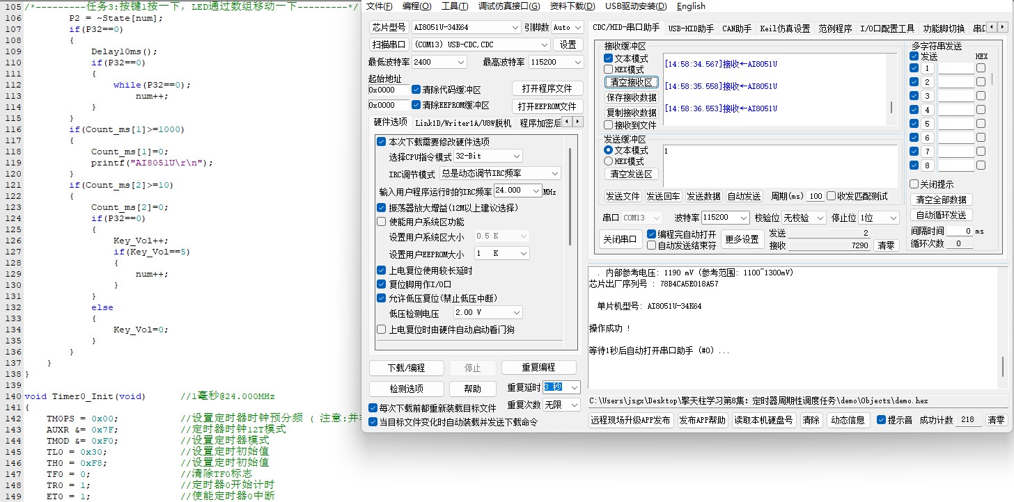

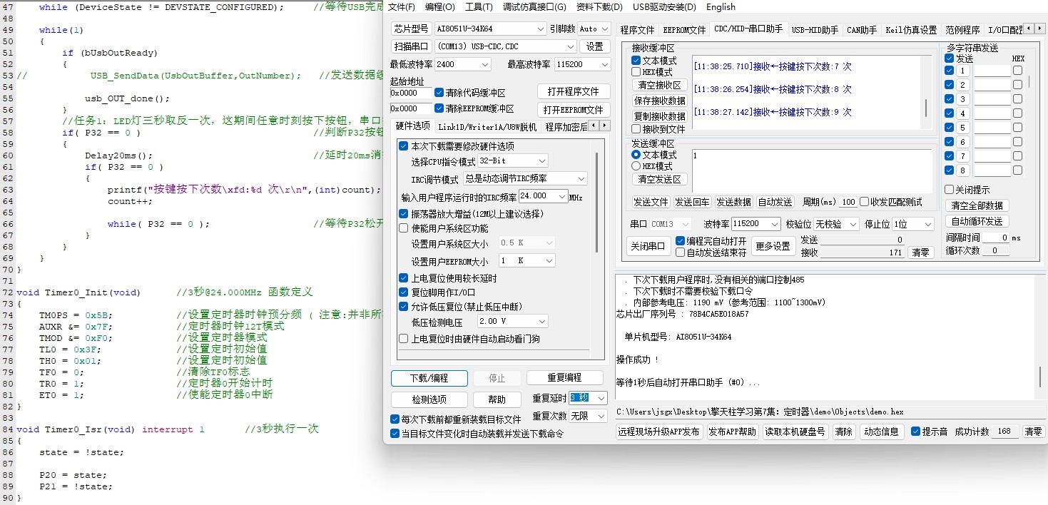

发表于 2025-1-2 15:12:04 | 显示全部楼层
擎天柱学习记录,第7集:定时器
程序如下:
  3. #include "intrins.h"
  4. #define u8 unsigned char      //8位无符号变量(0-255)
  5. #define u16 unsigned int      //16位无符号变量(0-65535)
  6. u8 state = 0;                   //初始状态
  7. u8 Run_State = 0;                                //运行状态
  8. char *USER_DEVICEDESC = NULL;
  9. char *USER_PRODUCTDESC = NULL;
  10. char *USER_STCISPCMD = "@STCISP#";
  11. void Delay20ms(void)        //@24.000MHz   Delay20ms();
  12. {
  13.         unsigned long edata i;
  14.         _nop_();
  15.         _nop_();
  16.         i = 119998UL;
  17.         while (i) i--;
  18. }
  19. void Timer0_Init(void);                //3秒@24.000MHz                //函数声明
  20. void main(void)
  21. {
  22.         int count=1;                        //按键计数变量
  23.     WTST = 0;                                  //设置程序指令延时参数,赋值为0可将CPU执行指令的速度设置为最快
  24.     EAXFR = 1;                                 //扩展寄存器(XFR)访问使能
  25.     CKCON = 0;                                 //提高访问XRAM速度
  26.
  27.     P0M1 = 0x00;   P0M0 = 0x00;
  28.     P1M1 = 0x00;   P1M0 = 0x00;
  29.     P2M1 = 0x00;   P2M0 = 0x00;
  30.     P3M1 = 0x00;   P3M0 = 0x00;
  31.     P4M1 = 0x00;   P4M0 = 0x00;
  32.     P5M1 = 0x00;   P5M0 = 0x00;
  33.     P6M1 = 0x00;   P6M0 = 0x00;
  34.     P7M1 = 0x00;   P7M0 = 0x00;
  35.
  36.         usb_init();                                     //USB CDC 接口配置
  37.     IE2 |= 0x80;                                    //使能USB中断
  38. //        Timer0_Init();
  39.     EA = 1;                                                                                        //IE |= 0X80;
  40.
  41.         while (DeviceState != DEVSTATE_CONFIGURED);     //等待USB完成配置
  42.
  43.         while(1)
  44.         {
  45.         if (bUsbOutReady)
  46.         {
  47. //           USB_SendData(UsbOutBuffer,OutNumber);   //发送数据缓冲区,长度(接收数据原样返回, 用于测试)
  48.
  49.             usb_OUT_done();
  50.         }
