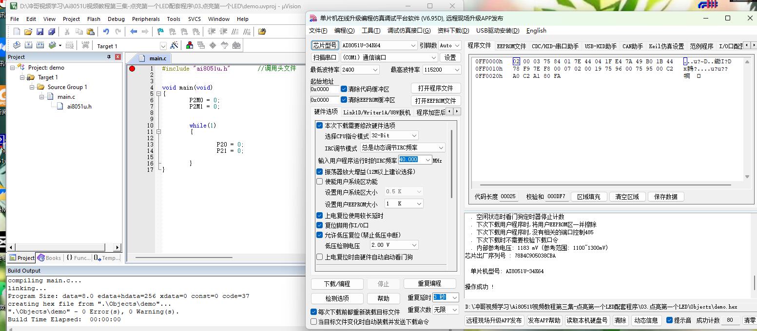

擎天柱第三集打卡
#include "ai8051u.h"                //调用头文件
void main(void)
        P2M0 = 0;
        P2M1 = 0;
        while(1)
                P20 = 0;
                P21 = 0;

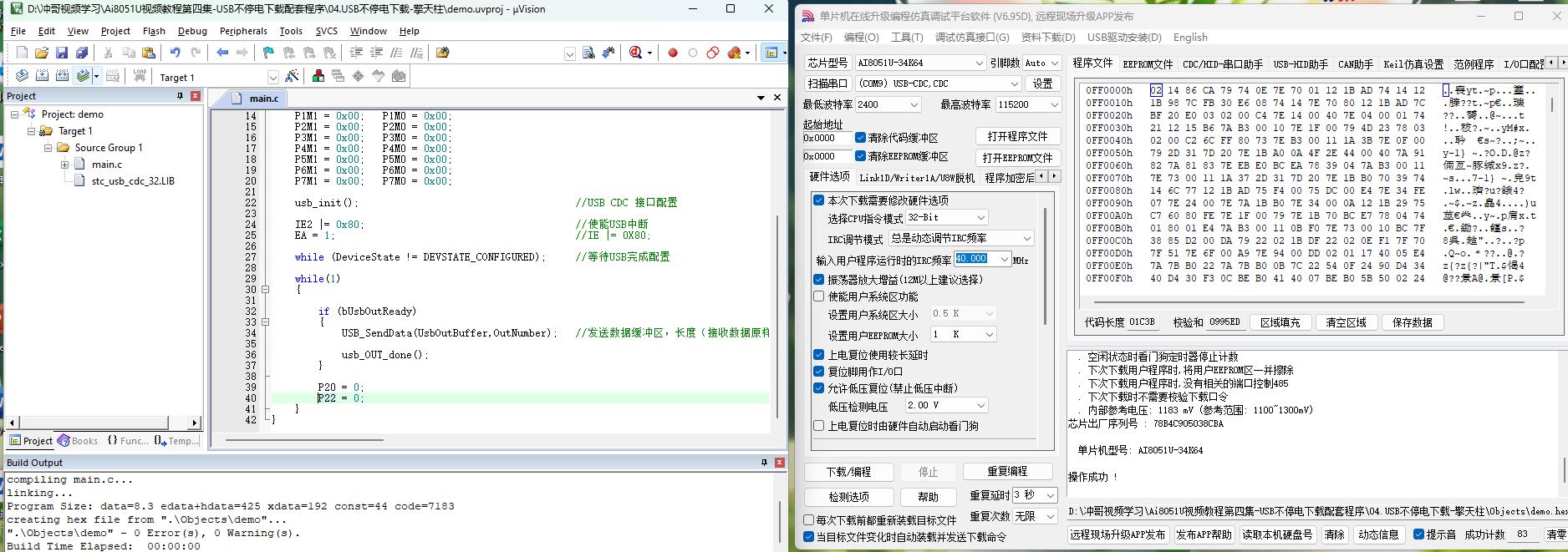

第四集打卡不停电下载
#include "stc32_stc8_usb.h"                //调用头文件
char *USER_DEVICEDESC = NULL;
void main(void)
    P_SW2 |= 0x80;                //B7位写1,使能访问XFR
    P0M1 = 0x00;   P0M0 = 0x00;
    P1M1 = 0x00;   P1M0 = 0x00;
    P2M1 = 0x00;   P2M0 = 0x00;
    P3M1 = 0x00;   P3M0 = 0x00;
    P4M1 = 0x00;   P4M0 = 0x00;
    P5M1 = 0x00;   P5M0 = 0x00;
    P6M1 = 0x00;   P6M0 = 0x00;
    P7M1 = 0x00;   P7M0 = 0x00;
        usb_init();                                     //USB CDC 接口配置
    IE2 |= 0x80;                                    //使能USB中断
    EA = 1;                                                                                        //IE |= 0X80;
        while (DeviceState != DEVSTATE_CONFIGURED);     //等待USB完成配置
        while(1)
        if (bUsbOutReady)
            USB_SendData(UsbOutBuffer,OutNumber);   //发送数据缓冲区,长度(接收数据原样返回, 用于测试)
            usb_OUT_done();
                P20 = 0;
                P22 = 0;

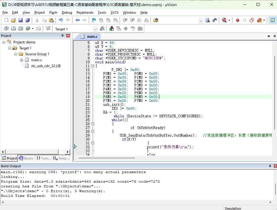

第五集打卡 C语言基础
#include "AI8051U.h"
#include "AI_usb.h"
#define u8  unsigned char
#define u16 unsigned int
u8 X = 66;
u8 Y = 6;
void main(void)
        P_SW2 |= 0x80;
    usb_init();
        IE2 |= 0x80;
    EA = 1;
        while(1)
                 if (bUsbOutReady)
             if(X>Y)
                         printf("条件为真\r\n");
                         else
                          printf("条件为假\r\n");
            usb_OUT_done();

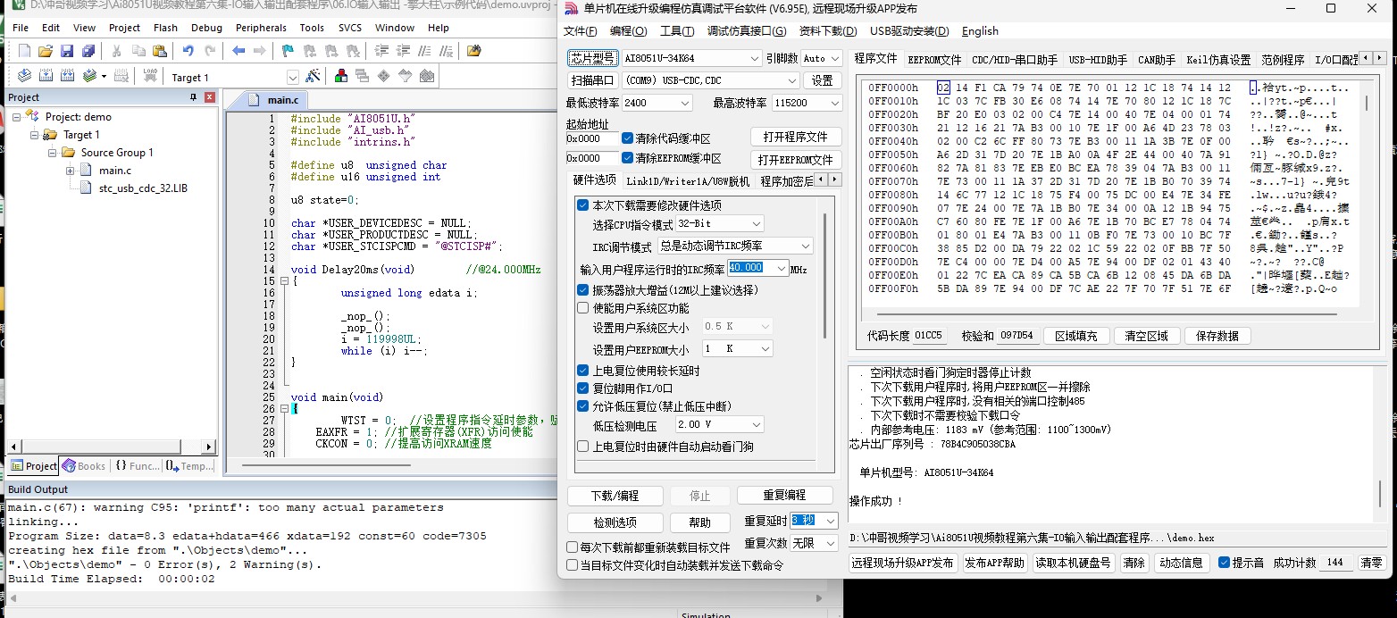

第六集 io口输入输出
#include "AI_usb.h"
#include "intrins.h"
u8 state=0;
void Delay20ms(void)        //@24.000MHz
        unsigned long edata i;
        _nop_();
        _nop_();
        i = 119998UL;
        while (i) i--;
void main(void)
    EAXFR = 1; //扩展寄存器(XFR)访问使能
    CKCON = 0; //提高访问XRAM速度
        P0M1 = 0X00;   P0M0 =  0X00;
        P1M1 = 0X00;   P1M0 =  0X00;
        P2M1 = 0X00;   P2M0 =  0X00;
        P3M1 = 0X00;   P3M0 =  0X00;
        P4M1 = 0X00;   P4M0 =  0X00;
        P5M1 = 0X00;   P5M0 =  0X00;
        P6M1 = 0X00;   P6M0 =  0X00;
        P7M1 = 0X00;   P7M0 =  0X00;
        usb_init();
        IE2 |= 0x80;
    EA = 1;
        while(1)
                if (bUsbOutReady)
            //USB_SendData(UsbOutBuffer,OutNumber);   //发送数据缓冲区,长度(接收数据原样返回, 用于测试)
            usb_OUT_done();
                //按一下灯亮,按一下灯灭
                if( P32 == 0 )                                                                //判断P32按钮是否按下
                        Delay20ms();
                        if( P32 == 0 )
                                state = !state;
                                P20 = state;
                                printf("state:%d\r\n",(int)state);
                                while( P32 == 0 );                                        //等待P32松开

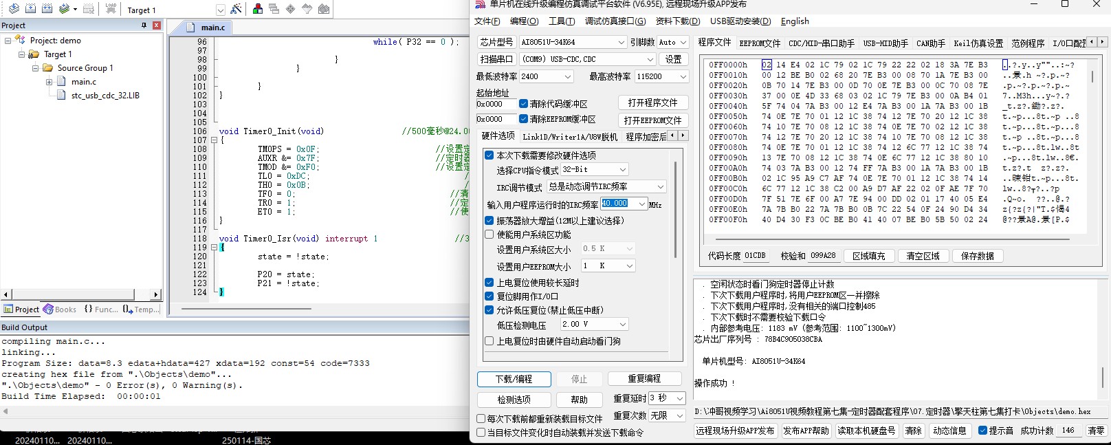

第七集 定时器中断
#include "AI_usb.h"
u8 state=0;
u8 Run_State=0;       //运行状态
void Delay20ms(void)        //@24.000MHz  Delay20ms();
        _nop_();
        _nop_();
        i = 119998UL;
        while (i) i--;
void Timer0_Init(void);                //3秒@24.000MHz                //函数声明
void main(void)
        int count=1;                                                                        //按键计数变量
    WTST = 0;                                                                                  //设置程序指令延时参数,赋值为0可将CPU执行指令的速度设置为最快
        usb_init();
    IE2 |= 0x80;
    EA = 1;
        P40 = 0;
        while(1)
        if (bUsbOutReady)
            usb_OUT_done();                                                        //
                if( P32 == 0 )
                        Delay20ms();                                                        //延时20ms消抖
                        if( P32 == 0 )
                                P20 = 0;
                                Timer0_Init();
                                while( P32 == 0 );
                //任务:救护车灯控制器
                if( P32 == 0 )
                        if( P32 == 0 )
                                Run_State = !Run_State;                                //运行状态取反
                                if( Run_State==1 )
                                        Timer0_Init();
                                else
                                        TR0 = 0;
                                        P20 = 1;
                                        P21 = 1;
                                while( P32 == 0 );
void Timer0_Init(void)                //500毫秒@24.000MHz
        TM0PS = 0x0F;                        //设置定时器时钟预分频 ( 注意:并非所有系列都有此寄存器,详情请查看数据手册 )
        AUXR &= 0x7F;                        //定时器时钟12T模式
        TMOD &= 0xF0;                        //设置定时器模式
        TL0 = 0xDC;                                //设置定时初始值
        TH0 = 0x0B;                                //设置定时初始值
        TF0 = 0;                                //清除TF0标志
        TR0 = 1;                                //定时器0开始计时
        ET0 = 1;                                //使能定时器0中断
void Timer0_Isr(void) interrupt 1                //3秒执行一次
        state = !state;
        P20 = state;
        P21 = !state;
第七集打卡.mp4
93.23 KB, 下载次数: 46
擎天柱第七集打卡.zip
93.9 KB, 下载次数: 52
