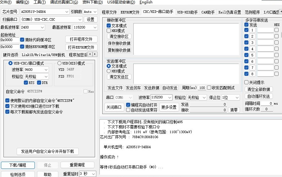

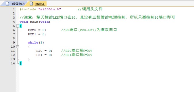

第三集:
擎天柱点亮LED灯,测试通过:
源代码如下:
#include "ai8051u.h"                //调用头文件
void main(void)
        P2M0 = 0;                //P2端口(P20-P27)为准双向口
        P2M1 = 0;
        while(1)
                P20 = 0;        //P20端口输出0V
                P21 = 0;        //P21端口输出0V

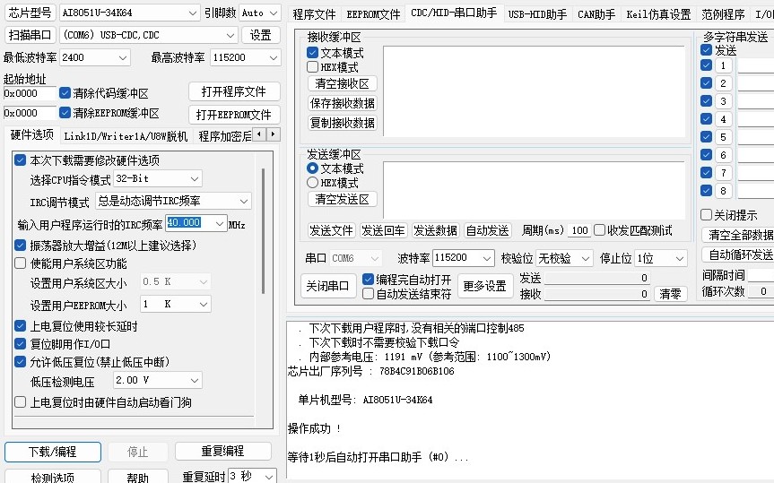

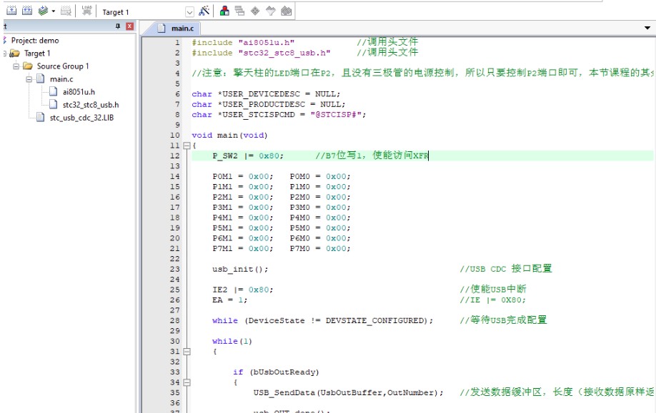

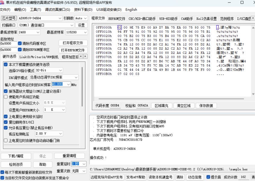

第四集:
擎天柱USB-CDC 不停电下载,测试通过:
测试代码如下:#include "ai8051u.h"
#include "stc32_stc8_usb.h"
char *USER_DEVICEDESC = NULL;
void main(void)
    P_SW2 |= 0x80;                //B7位写1,使能访问XFR
    P0M1 = 0x00;   P0M0 = 0x00;
    P1M1 = 0x00;   P1M0 = 0x00;
    P2M1 = 0x00;   P2M0 = 0x00;
    P3M1 = 0x00;   P3M0 = 0x00;
    P4M1 = 0x00;   P4M0 = 0x00;
    P5M1 = 0x00;   P5M0 = 0x00;
    P6M1 = 0x00;   P6M0 = 0x00;
    P7M1 = 0x00;   P7M0 = 0x00;
        usb_init();
    IE2 |= 0x80;
    EA = 1;
        while (DeviceState != DEVSTATE_CONFIGURED);
        while(1)
        if (bUsbOutReady)
            USB_SendData(UsbOutBuffer,OutNumber);
            usb_OUT_done();
                P20 = 0;
                P22 = 0;

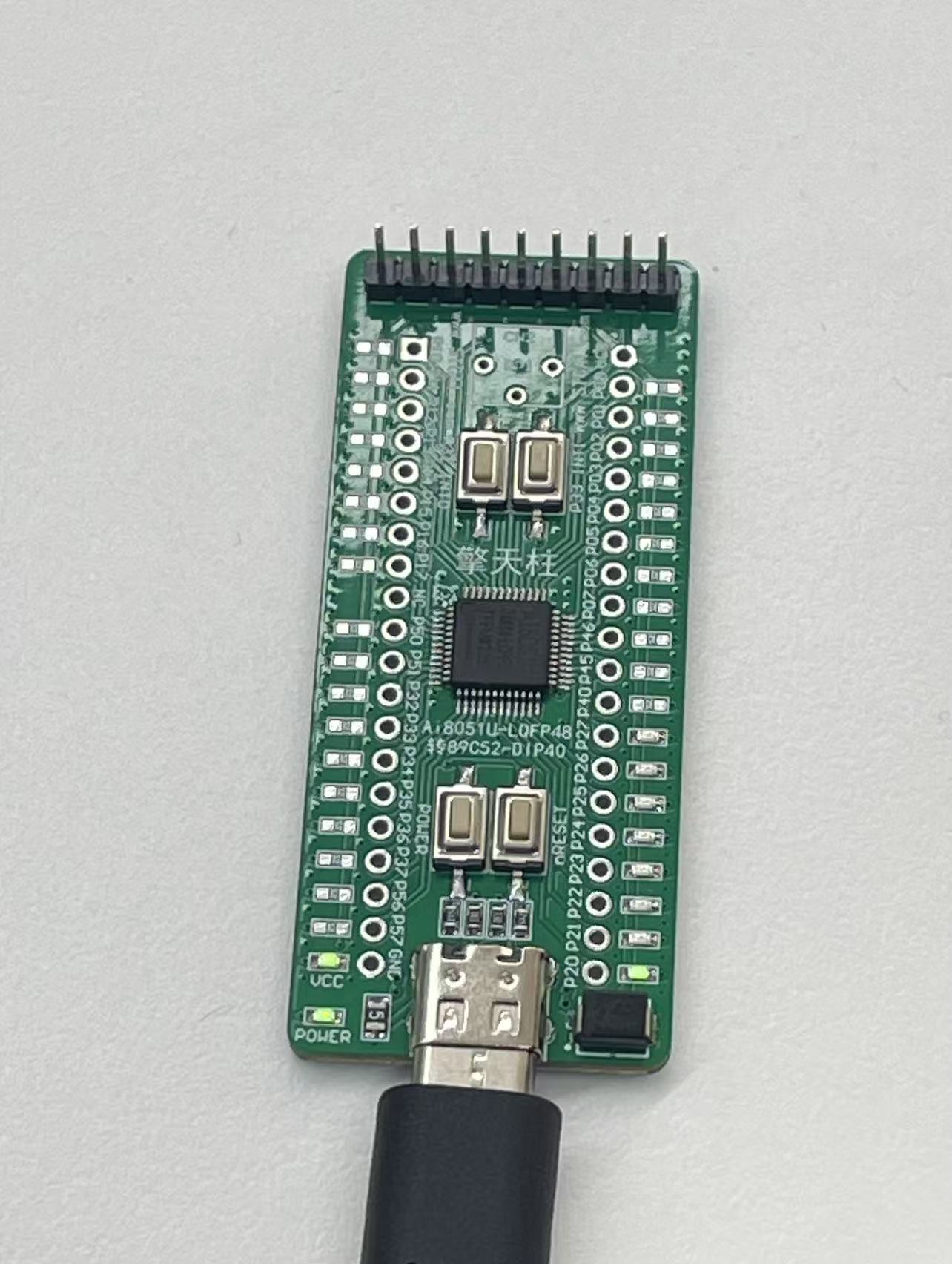

擎天柱 第五集 C语言基础 已手敲代码测试成功
#include "AI8051U.h"
#include "AI_usb.h"
#define u8  unsigned char
#define u16 unsigned int
u8 X = 66;
u8 Y = 6;
void main(void)
        P_SW2 |= 0x80;
    usb_init();
        IE2 |= 0x80;
    EA = 1;
        while(1)
                 if (bUsbOutReady)
            USB_SendData(UsbOutBuffer,OutNumber);   //发送数据缓冲区,长度(接收数据原样返回, 用于测试)
             if(X>Y)
                         printf("条件为真\r\n");
                         else
                          printf("条件为假\r\n");
            usb_OUT_done();

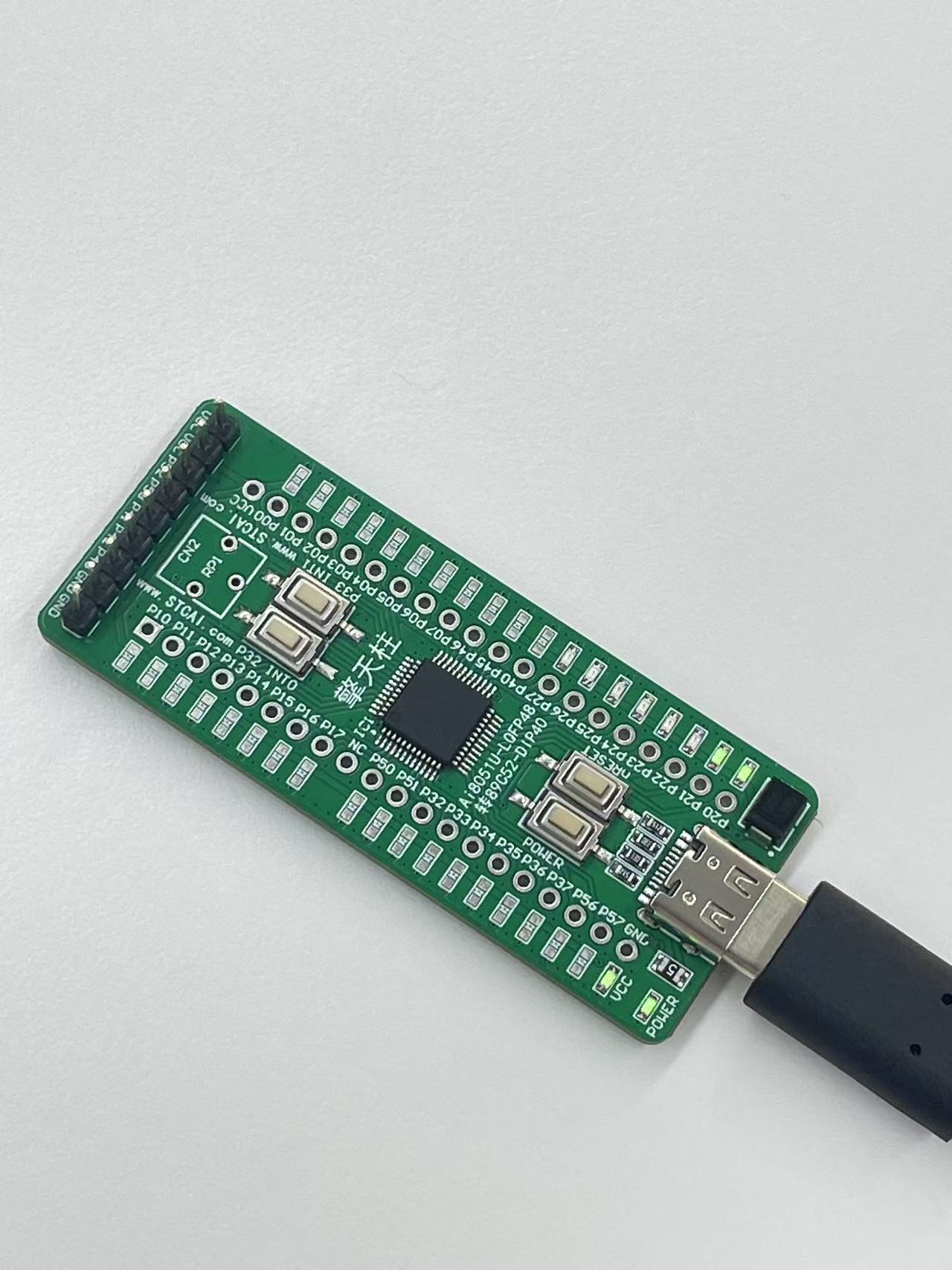

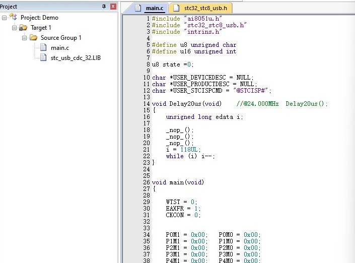

擎天柱 第六集 IO口输入输出 已手敲代码测试成功
#include "intrins.h"
u8 state =0;
void Delay20us(void)        //@24.000MHz  Delay20us();
        unsigned long edata i;
        _nop_();
        _nop_();
        _nop_();
        i = 118UL;
        while (i) i--;
void main(void)
        WTST = 0;                     //设置程序指令延时参数,赋值为0可将CPU执行指令的速度设置为最快
    EAXFR = 1;                       //扩展寄存器(XFR)访问使能
    CKCON = 0;                   //提高访问XRAM速度
        usb_init();
    IE2 |= 0x80;
    EA = 1;
        P40 =0;
        while(1)
                if (bUsbOutReady)
            //USB_SendData(UsbOutBuffer,OutNumber);
            usb_OUT_done();
//                //任务1:按下P32按钮灯亮,松开P32按钮灯灭;
//                if( P32 == 0)
//                        P00 =0;
//                else
//                        P00 =1;
//                //任务2:按下P32按钮灯灭,松开P32按钮灯亮;
//                if( P32 == 0)
//                        P00 =1;
//                else
//                        P00 =0;
                //任务3:按一下灯亮,按一下灯灭;
                if( P32 == 0)
                        Delay20us();
                        if( P32 == 0)
                        state = !state;
                        P00 =state;
                        printf("state %d\r\n",(int)state);
                        while(P32 == 0 );

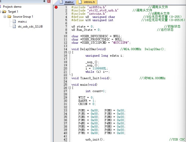

擎天柱 第七集 定时器中断 已手敲代码测试通过
#include "stc32_stc8_usb.h"        //调用头文件
#include "intrins.h"                        //d调用头文件
#define u8  unsigned char                //8位无符号变量(0-255)
#define u16 unsigned int                //16位无符号变量(0-65535)
u8 state = 0;                                        //初始状态
u8 Run_State = 0;                                //运行状态
void Delay20ms(void)        //@24.000MHz  Delay20ms();
        _nop_();
        _nop_();
        i = 119998UL;
        while (i) i--;
void Timer0_Init(void);                //3秒@24.000MHz                //函数声明
void main(void)
        int count=1;
    WTST = 0;
    EAXFR = 1;
    CKCON = 0;
        usb_init();
    IE2 |= 0x80;
    EA = 1;
        P40 = 0;
        while(1)
        if (bUsbOutReady)
            //USB_SendData(UsbOutBuffer,OutNumber);   //发送数据缓冲区,长度(接收数据原样返回, 用于测试)
            usb_OUT_done();
                if( P32 == 0 )
                        Delay20ms();
                        if( P32 == 0 )
                                P20 = 0;
                                Timer0_Init();
                                while( P32 == 0 );
                if( P32 == 0 )
                        Delay20ms();
                        if( P32 == 0 )
                                Run_State = !Run_State;
                                if( Run_State==1 )
                                        Timer0_Init();
                                else
                                        TR0 = 0;
                                        P20 = 1;
                                        P21 = 1;
                                while( P32 == 0 );

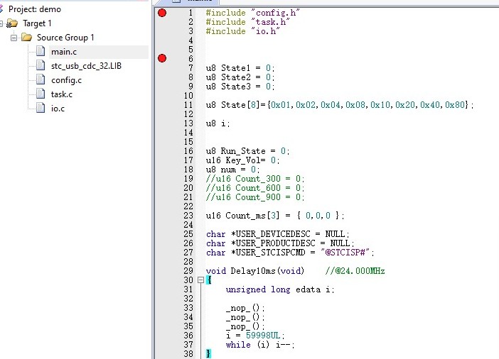

第8集 定时器周期性调度任务 已手敲代码测试完成
代码如下:
#include "config.h"
#include "task.h"
#include "io.h"
u8 State1 = 0;
u8 State2 = 0;
u8 State3 = 0;
u8 State[8]={0x01,0x02,0x04,0x08,0x10,0x20,0x40,0x80};
u8 i;
u8 Run_State = 0;
u16 Key_Vol= 0;
u8 num = 0;
u16 Count_ms[3] = { 0,0,0 };
void Delay10ms(void)        //@24.000MHz
        _nop_();
        _nop_();
        _nop_();
        i = 59998UL;
        while (i) i--;
void main(void)
        int count=1;
        Sys_init();
        usb_init();
    IE2 |= 0x80;
        Timer0_Init();
    EA = 1;
        P40 = 0;
        while(1)
        if (bUsbOutReady)
                        //USB_SendData(UsbOutBuffer,OutNumber); )
                        usb_OUT_done();
                Task_Pro_Handler_Callback();
                P0 = ~State[ num ];
        Task_Marks_Handler_Callback();
