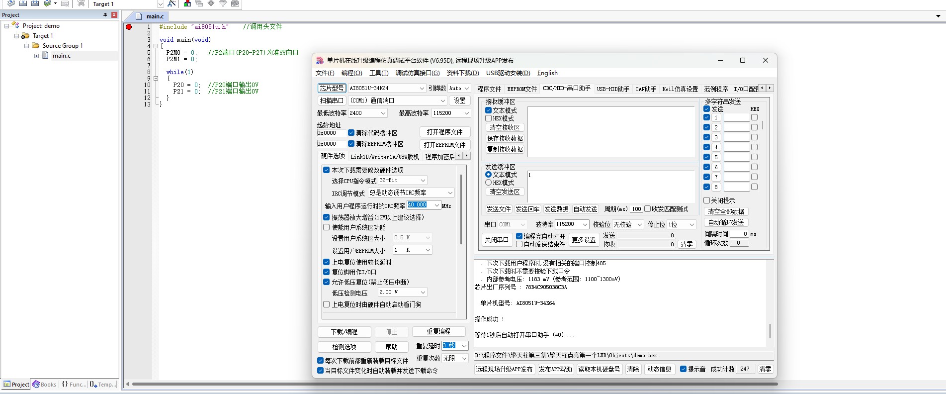

第三集:擎天柱点亮LED灯
源代码如下:
#include "ai8051u.h"                //调用头文件
void main(void)
        P2M0 = 0;                //P2端口(P20-P27)为准双向口
        P2M1 = 0;
        while(1)
                P20 = 0;        //P20端口输出0V
                P21 = 0;        //P21端口输出0V
擎天柱第三集.zip

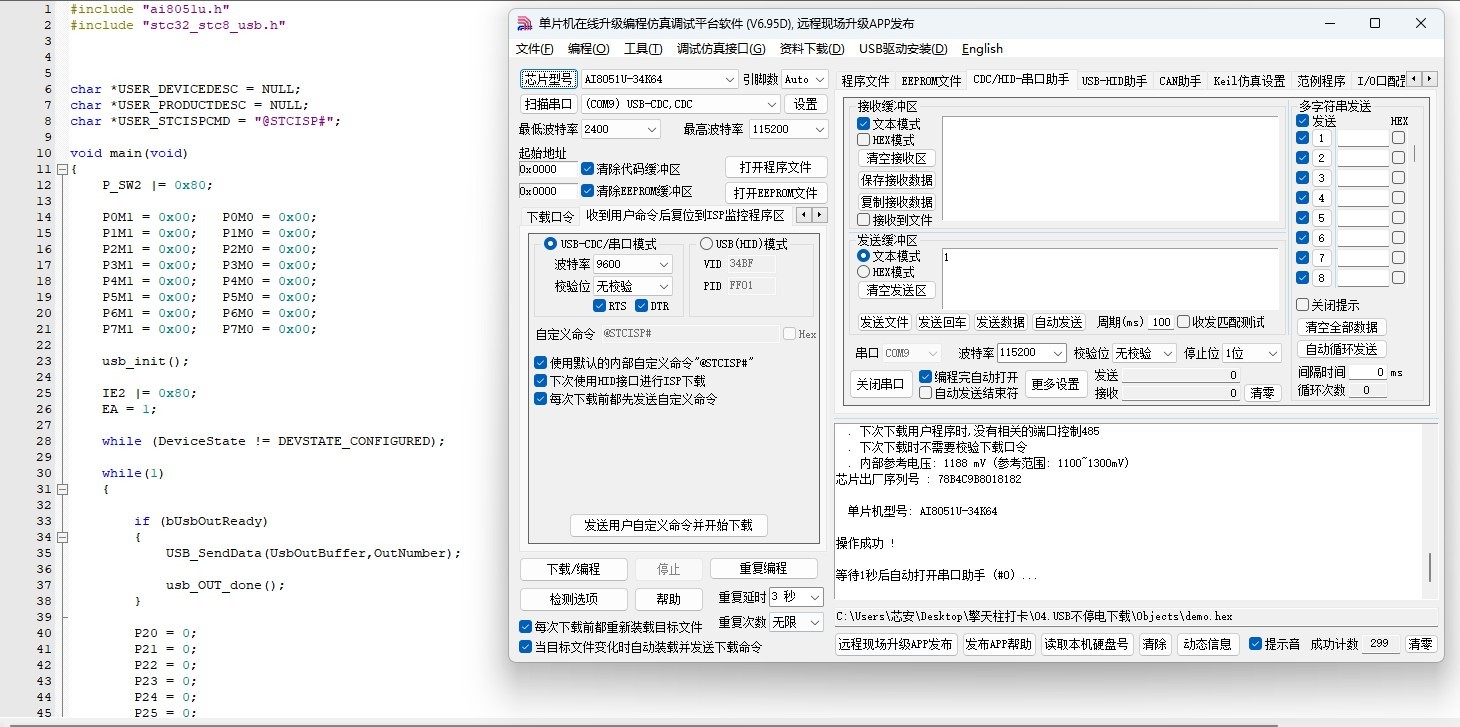

第四集 不停电下载
  • #include "ai8051u.h"
  • #include "stc32_stc8_usb.h"
  • char *USER_DEVICEDESC = NULL;
  • char *USER_PRODUCTDESC = NULL;
  • char *USER_STCISPCMD = "@STCISP#";
  • void main(void)
  •     P_SW2 |= 0x80;
  •     P0M1 = 0x00;   P0M0 = 0x00;
  •     P1M1 = 0x00;   P1M0 = 0x00;
  •     P2M1 = 0x00;   P2M0 = 0x00;
  •     P3M1 = 0x00;   P3M0 = 0x00;
  •     P4M1 = 0x00;   P4M0 = 0x00;
  •     P5M1 = 0x00;   P5M0 = 0x00;
  •     P6M1 = 0x00;   P6M0 = 0x00;
  •     P7M1 = 0x00;   P7M0 = 0x00;
  •     usb_init();
  •     IE2 |= 0x80;
  •     EA = 1;
  •         while (DeviceState != DEVSTATE_CONFIGURED);
  •         while(1)
  •         if (bUsbOutReady)
  •             USB_SendData(UsbOutBuffer,OutNumber);
  •             usb_OUT_done();
  •         P20 = 0;
  •         P21 = 0;
  •         P22 = 0;
  •         P23 = 0;
  •         P24 = 0;
  •         P25 = 0;
  •         P26 = 0;
  •         P27 = 0;

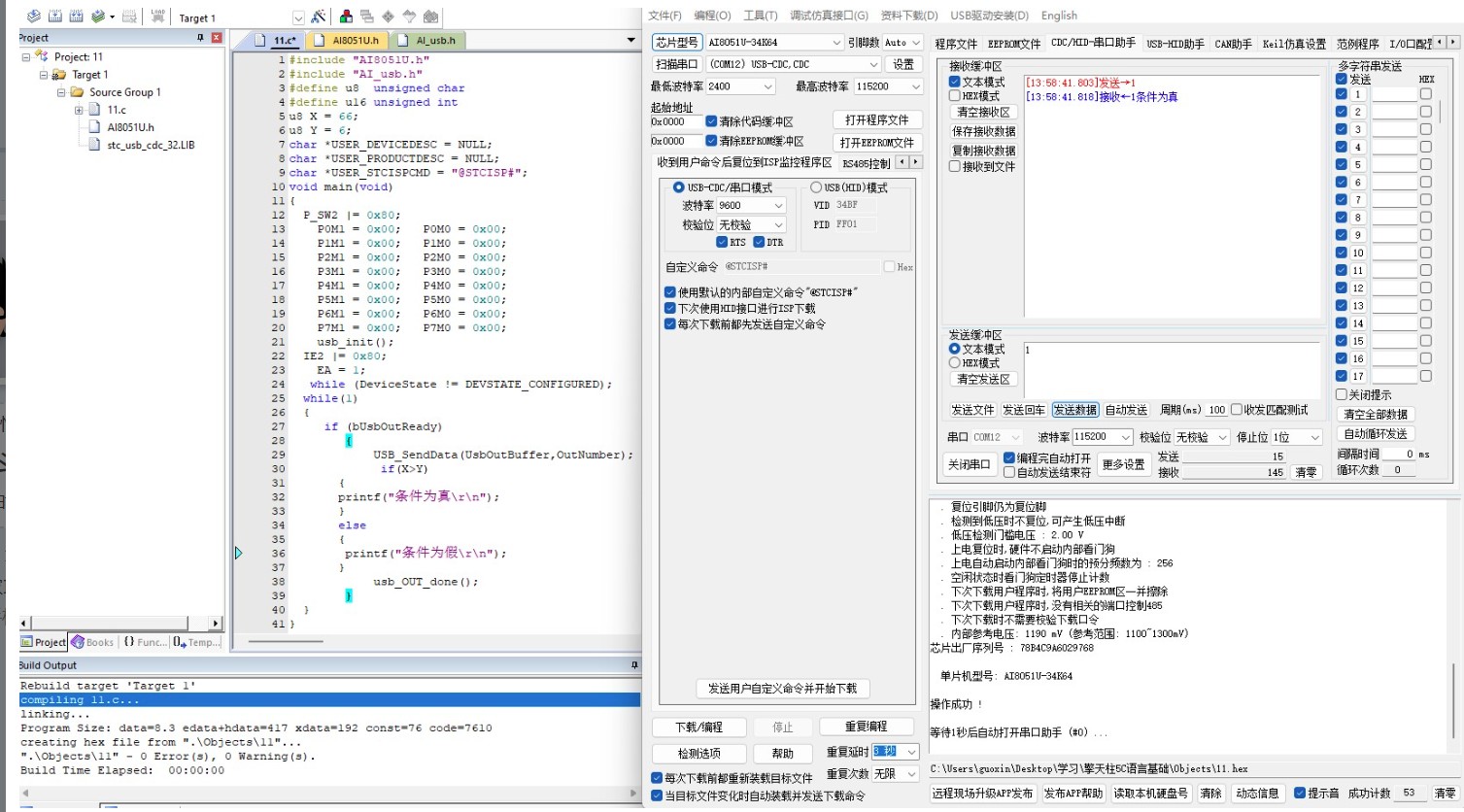

第五集 C语言基础
#include "AI8051U.h"
#include "AI_usb.h"
#define u8  unsigned char
#define u16 unsigned int
u8 X = 66;
u8 Y = 6;
void main(void)
        P_SW2 |= 0x80;
    usb_init();
        IE2 |= 0x80;
    EA = 1;
        while(1)
                 if (bUsbOutReady)
            USB_SendData(UsbOutBuffer,OutNumber);   //发送数据缓冲区,长度(接收数据原样返回, 用于测试)
             if(X>Y)
                         printf("条件为真\r\n");
                         else
                          printf("条件为假\r\n");
            usb_OUT_done();
