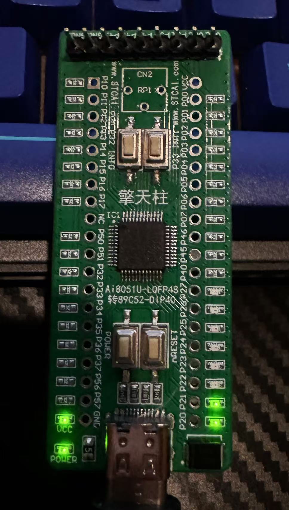

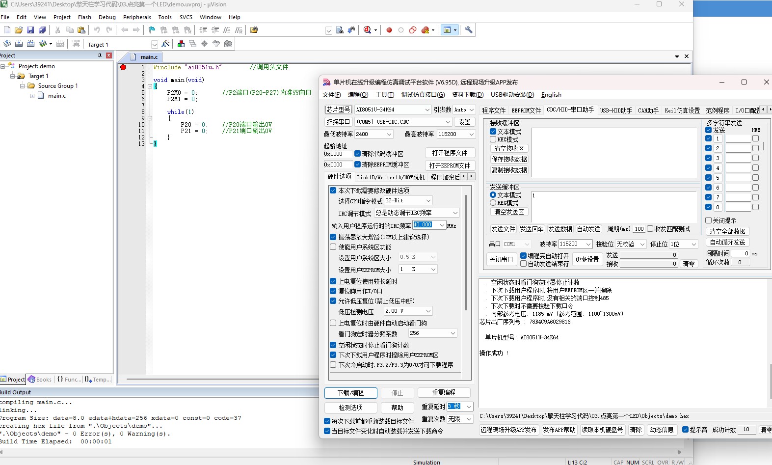

第三集,点亮第一颗LED灯
#include "ai8051u.h"
void main(void)
        P2M0 = 0;
        P2M1 = 0;
        while(1)
                P20 = 0;
                P21 = 0;

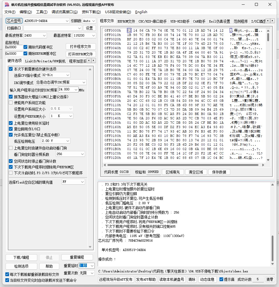

第四集 ,不停电下载
#include "stc32_stc8_usb.h"
char *USER_DEVICEDESC = NULL;
void main(void)
    P_SW2 |= 0x80;
    P0M1 = 0x00;   P0M0 = 0x00;
    P1M1 = 0x00;   P1M0 = 0x00;
    P2M1 = 0x00;   P2M0 = 0x00;
    P3M1 = 0x00;   P3M0 = 0x00;
    P4M1 = 0x00;   P4M0 = 0x00;
    P5M1 = 0x00;   P5M0 = 0x00;
    P6M1 = 0x00;   P6M0 = 0x00;
    P7M1 = 0x00;   P7M0 = 0x00;
        usb_init();
    IE2 |= 0x80;
    EA = 1;                                                                                        //IE |= 0X80;
        while (DeviceState != DEVSTATE_CONFIGURED);
        while(1)
        if (bUsbOutReady)
            USB_SendData(UsbOutBuffer,OutNumber);
            usb_OUT_done();
                P20 = 0;
                P22 = 0;

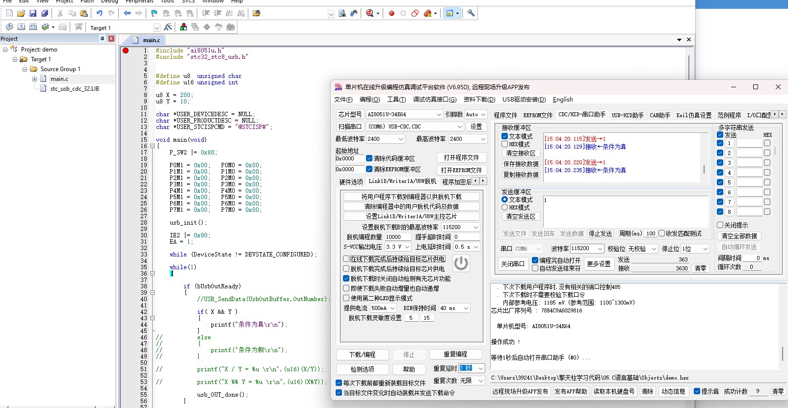

第五集,C语言基础
#define u8  unsigned char
#define u16 unsigned int
u8 X = 200;
u8 Y = 10;
void main(void)
    P_SW2 |= 0x80;
        usb_init();
    IE2 |= 0x80;
    EA = 1;
        while(1)
        if (bUsbOutReady)
            //USB_SendData(UsbOutBuffer,OutNumber);
                        if( X && Y )
                                printf("条件为真\r\n");
//                        else
//                                printf("条件为假\r\n");
//                        printf("X / Y = %u \r\n",(u16)(X/Y));
//                        printf("X %% Y = %u \r\n",(u16)(X%Y));
            usb_OUT_done();

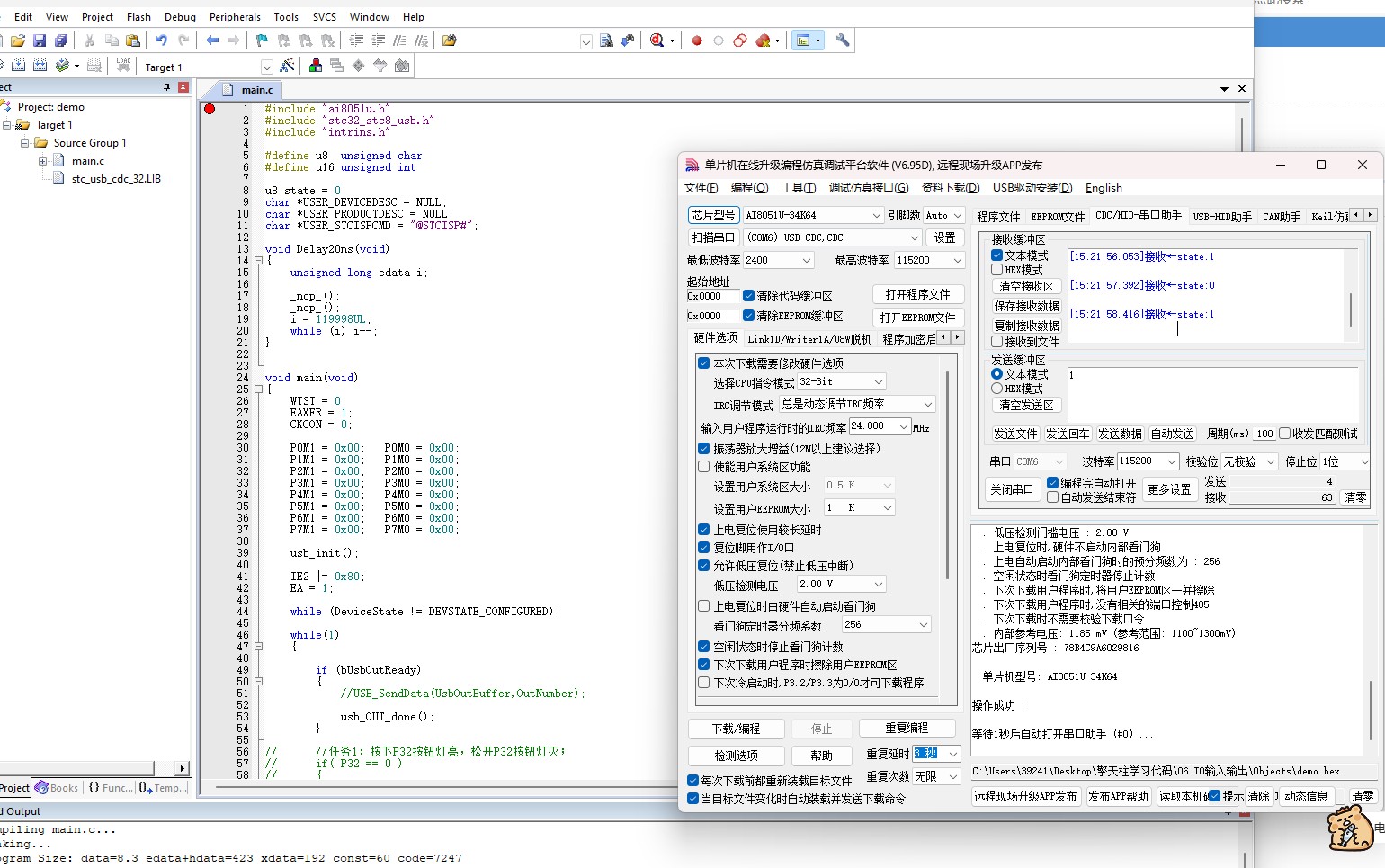

第六集,IO口输入输出
#include "intrins.h"
u8 state = 0;
void Delay20ms(void)
        unsigned long edata i;
        _nop_();
        _nop_();
        i = 119998UL;
        while (i) i--;
void main(void)
    WTST = 0;
    EAXFR = 1;
    CKCON = 0;
        usb_init();
    IE2 |= 0x80;
    EA = 1;
        while(1)
        if (bUsbOutReady)
            usb_OUT_done();
//                //任务1:按下P32按钮灯亮,松开P32按钮灯灭;
//                if( P32 == 0 )
//                        P20 = 0;
//                else
//                        P20 = 1;
                //任务2:按下P32按钮灯灭,松开P32按钮灯亮;
//                if( P32 == 1 )
//                        P20 = 0;
//                else
//                        P20 = 1;
                //任务3:按一下灯亮,按一下灯灭
                if( P32 == 0 )
                        Delay20ms();
                        if( P32 == 0 )
                                state = !state;
                                P20 = state;
                                printf("state:%d\r\n",(int)state);
                                while( P32 == 0 );

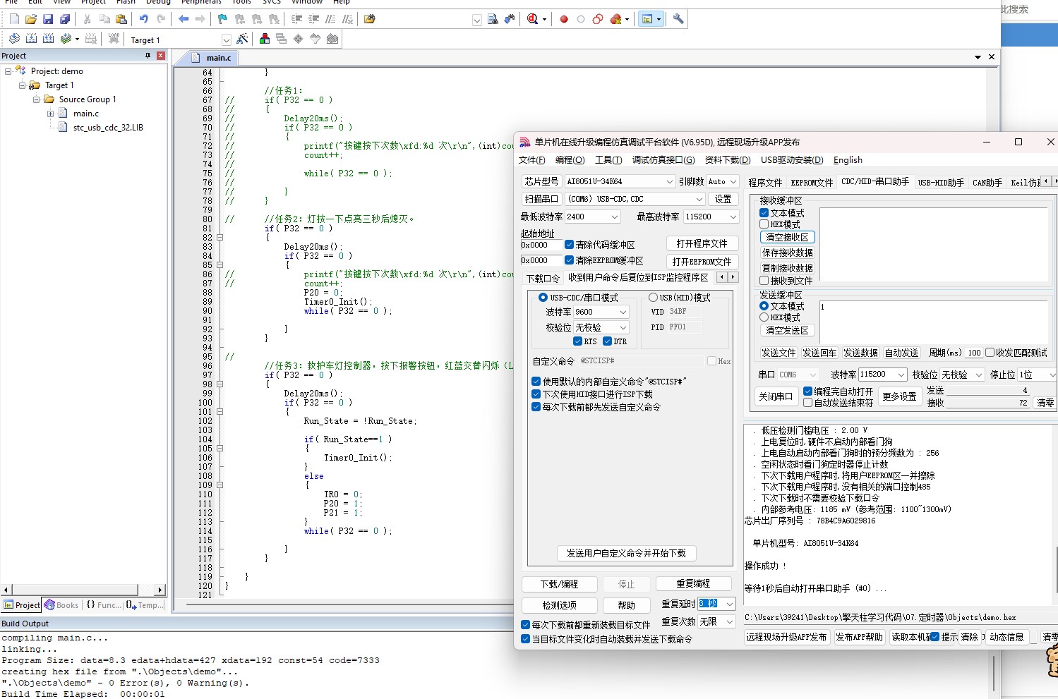

第七集,定时器中断
u8 state = 0;
u8 Run_State = 0;
        _nop_();
        _nop_();
        i = 119998UL;
        while (i) i--;
void Timer0_Init(void);                //3秒@24.000MHz
void main(void)
        int count=1;
    WTST = 0;
    EAXFR = 1;
    CKCON = 0;
        usb_init();
    IE2 |= 0x80;
//        Timer0_Init();
    EA = 1;
        P40 = 0;
        while(1)
        if (bUsbOutReady)
            usb_OUT_done();
                //任务1:
//                if( P32 == 0 )
//                        Delay20ms();
//                        if( P32 == 0 )
//                                printf("按键按下次数\xfd:%d 次\r\n",(int)count);
//                                count++;
//                                while( P32 == 0 );
//                //任务2:灯按一下点亮三秒后熄灭。
                if( P32 == 0 )
                        Delay20ms();
                        if( P32 == 0 )
//                                count++;
                                P20 = 0;
                                Timer0_Init();
                                while( P32 == 0 );
                //任务3:救护车灯控制器,按下报警按钮,红蓝交替闪烁(LED1和LED2表示红和蓝灯),再按一下报警按钮,红蓝灯停止。
                if( P32 == 0 )
                        Delay20ms();
                        if( P32 == 0 )
                                Run_State = !Run_State;
                                if( Run_State==1 )
                                        Timer0_Init();
                                else
                                        TR0 = 0;
                                        P20 = 1;
                                        P21 = 1;
                                while( P32 == 0 );
