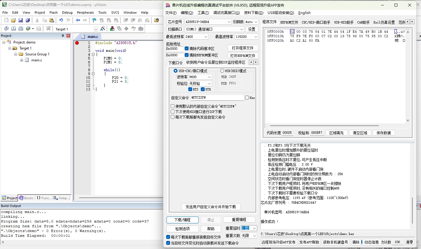

第三集:点亮第一个LED
#include "AI8051U.h"
void main(void)
        P2M0 = 0;
        P2M1 = 0;
        while(1)
                P20 = 0;
                P21 = 0;

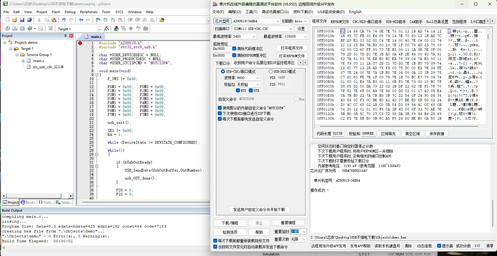

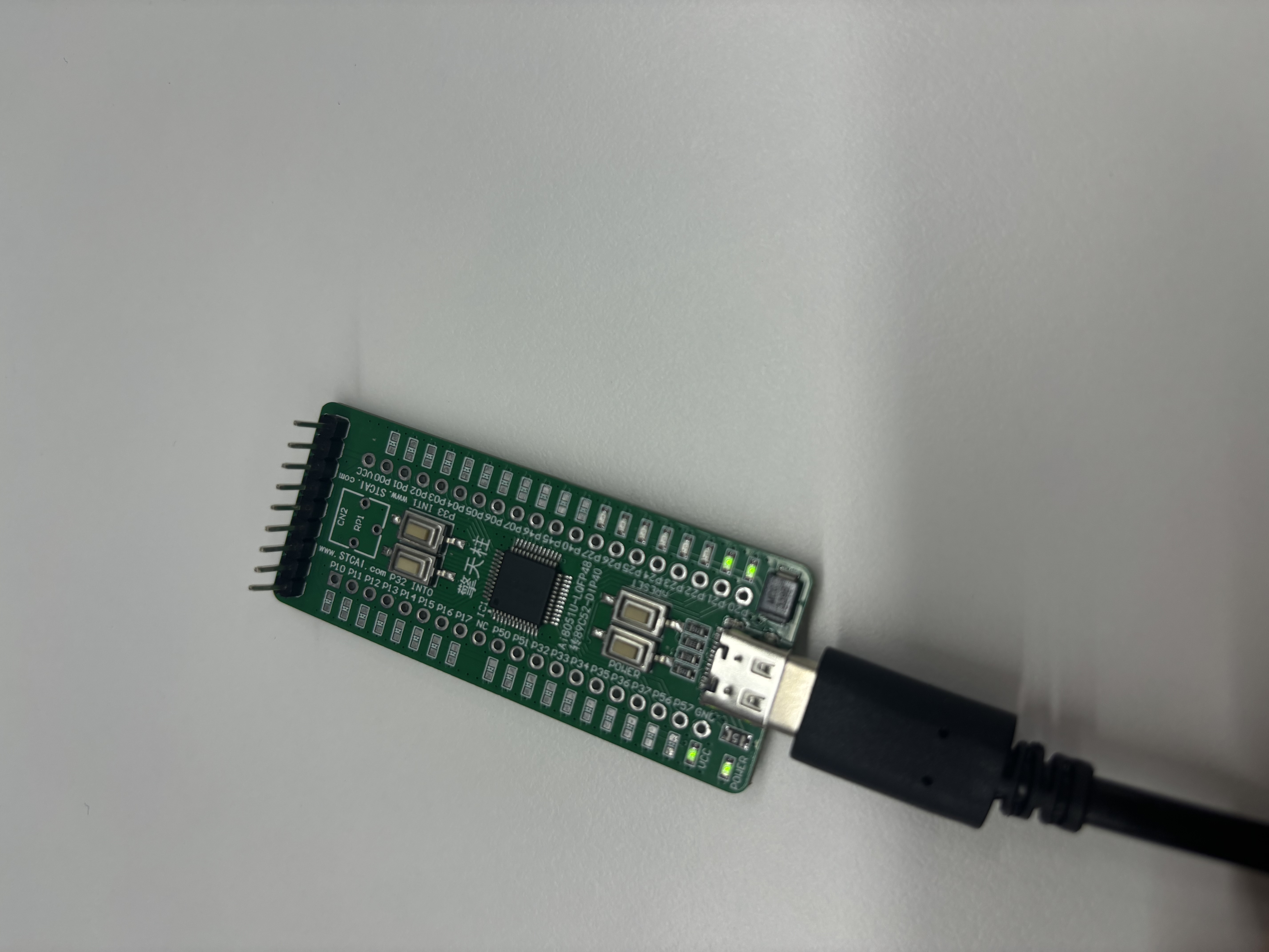

第四集:USB不停电下载
#include "stc32_stc8_usb.h"
char *USER_DEVICEDESC = NULL;
void main(void)
    P_SW2 |= 0x80;
    P0M1 = 0x00;   P0M0 = 0x00;
    P1M1 = 0x00;   P1M0 = 0x00;
    P2M1 = 0x00;   P2M0 = 0x00;
    P3M1 = 0x00;   P3M0 = 0x00;
    P4M1 = 0x00;   P4M0 = 0x00;
    P5M1 = 0x00;   P5M0 = 0x00;
    P6M1 = 0x00;   P6M0 = 0x00;
    P7M1 = 0x00;   P7M0 = 0x00;
        usb_init();
    IE2 |= 0x80;
    EA = 1;
        while (DeviceState != DEVSTATE_CONFIGURED);
        while(1)
        if (bUsbOutReady)
            USB_SendData(UsbOutBuffer,OutNumber);
            usb_OUT_done();
                P20 = 0;
                P22 = 0;
