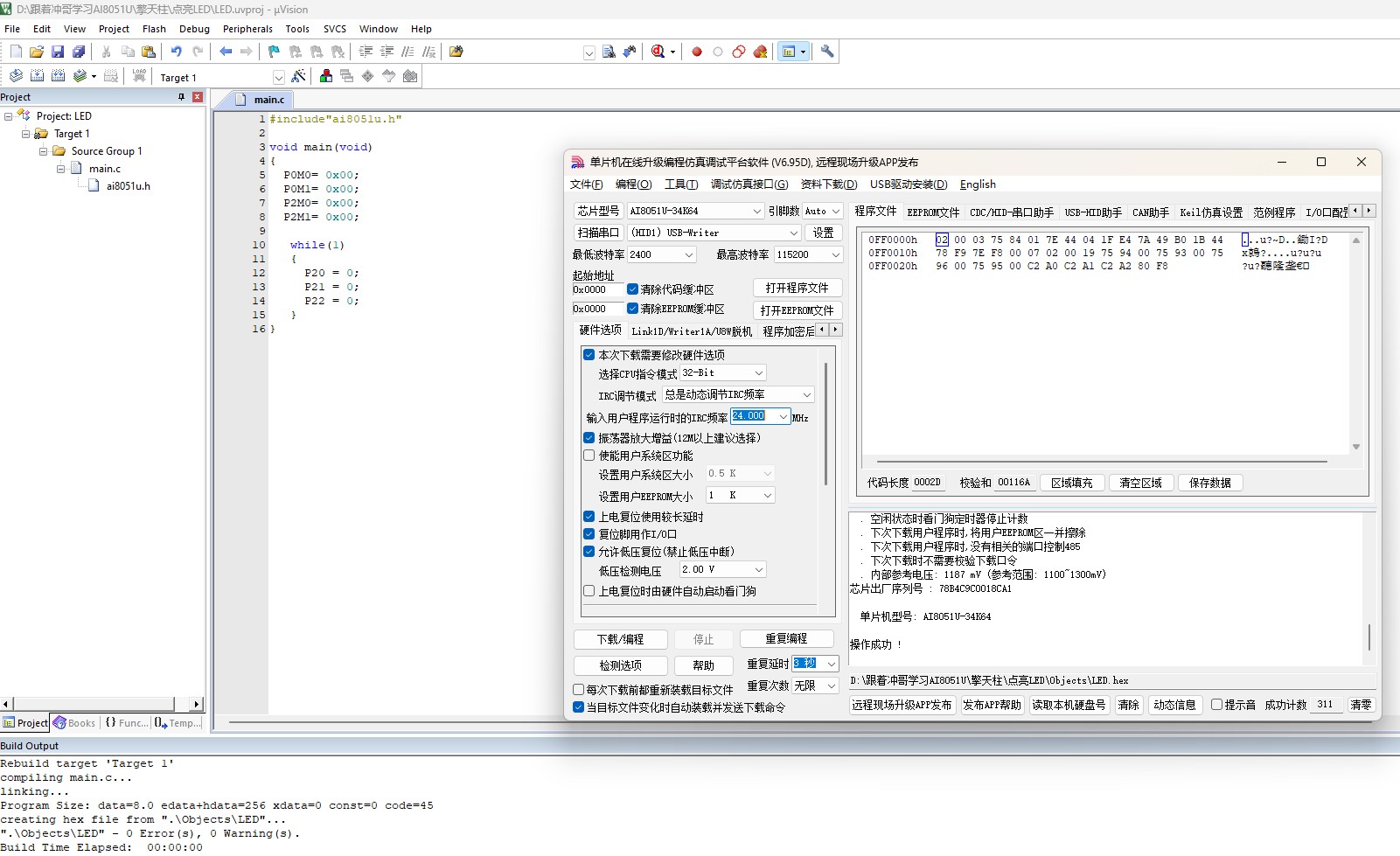

第三集、使用【Ai8051U】擎天柱核心板实现——点亮LED灯
  1. #include"ai8051u.h"
  2. void main(void)
  3. {
  4.         P0M0= 0x00;
  5.         P0M1= 0x00;
  6.         P2M0= 0x00;
  7.         P2M1= 0x00;
  8.    while(1)
  9.          {
  10.                  P20 = 0;
  11.                  P21 = 0;
  12.                  P22 = 0;
  13.          }
  14. }

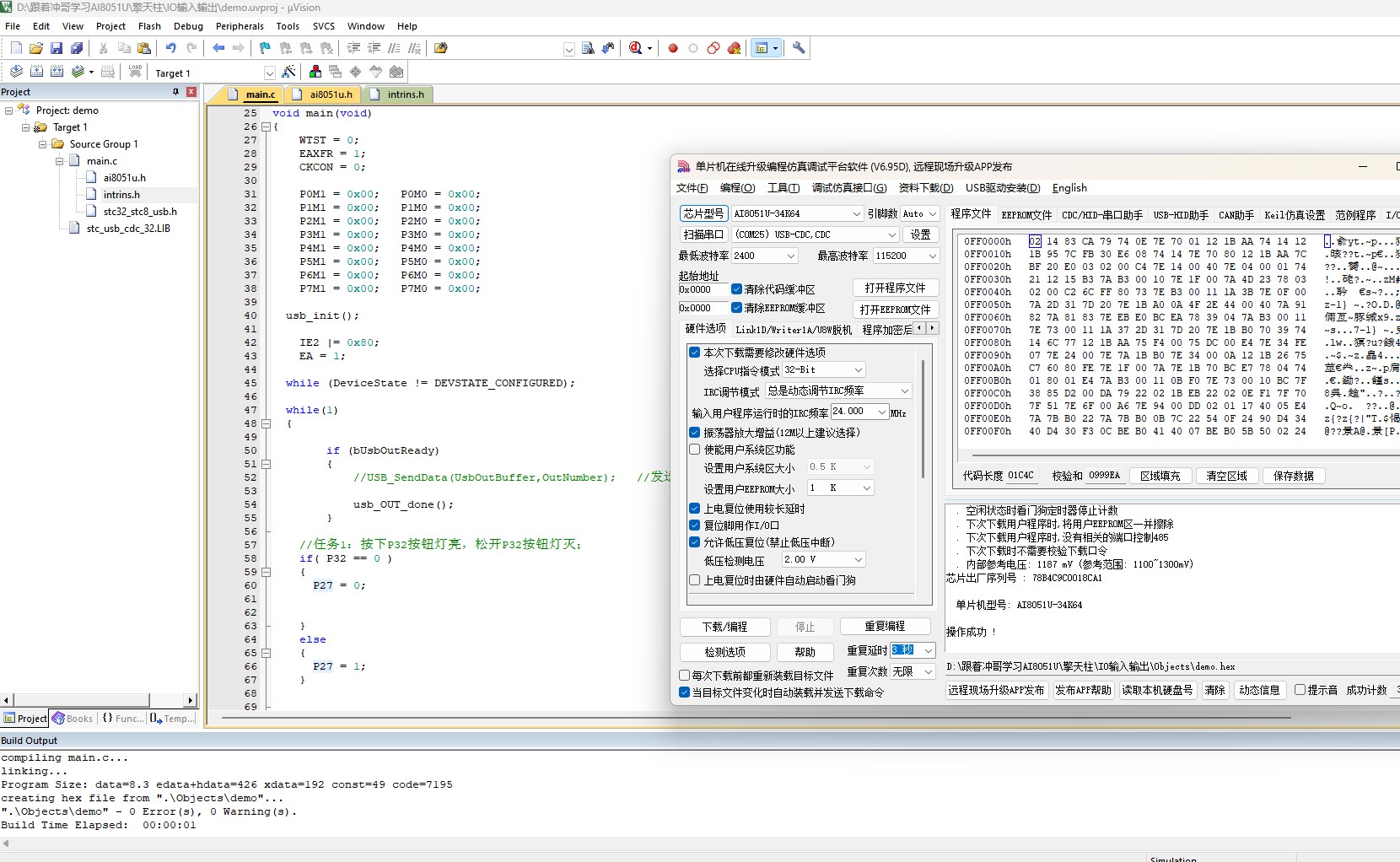

第六集、使用【Ai8051U】擎天柱核心板——IO口输入输出
任务一:按下P32按钮灯亮,松开P32按钮灯灭
  1. #include "ai8051u.h"
  2. #include "stc32_stc8_usb.h"
  3. #include "intrins.h"
  4. #define u8  unsigned char
  5. #define u16 unsigned int
  6.
  7. u8 state = 0;
  8. char *USER_DEVICEDESC = NULL;
  9. char *USER_PRODUCTDESC = NULL;
  10. char *USER_STCISPCMD = "@STCISP#";
  11. void Delay20ms(void)
  12. {
