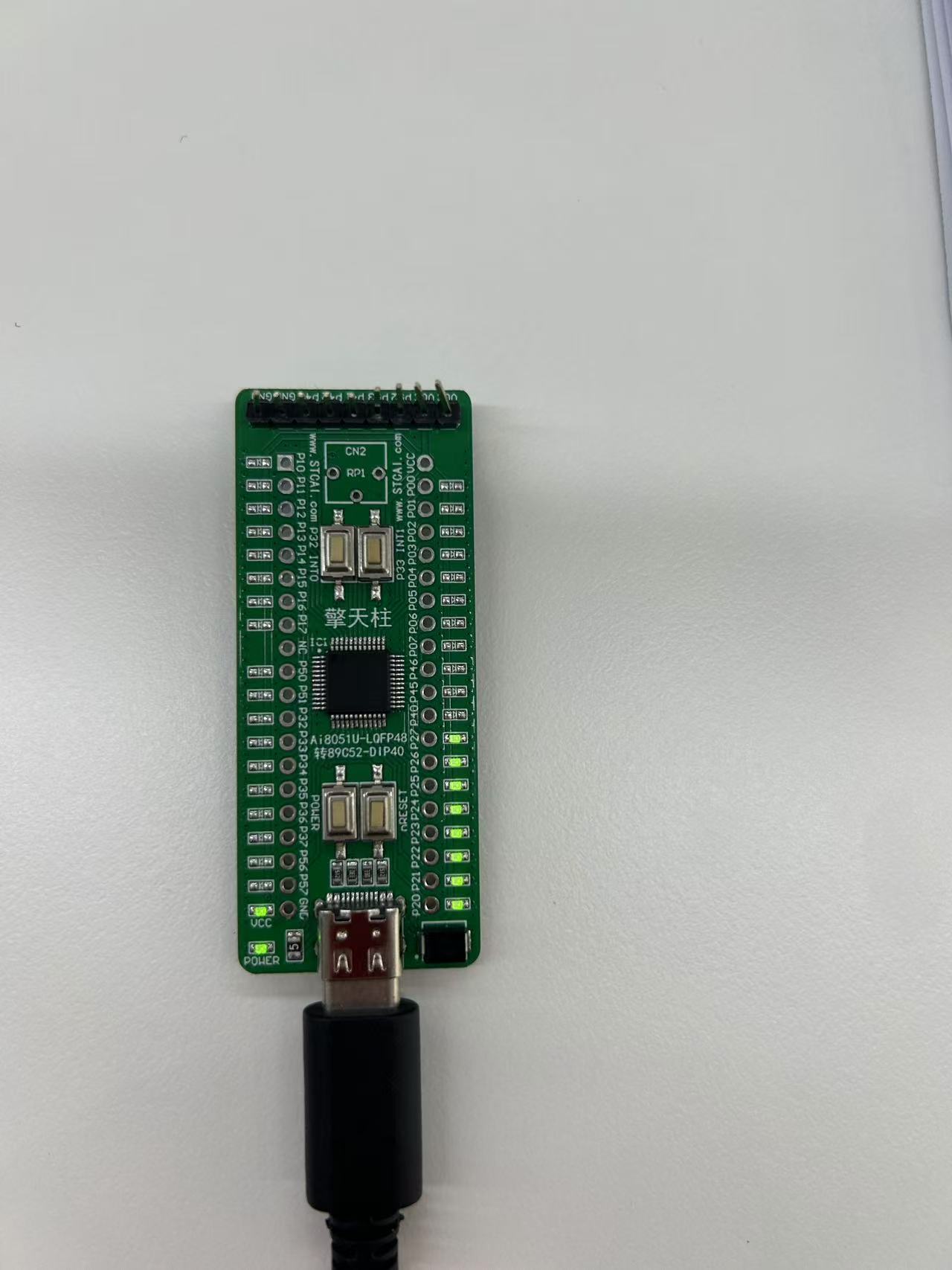

第三集 点亮第一个LED
  1. #include "ai8051u.h"
  2. void main(void)
  3. {
  4.         P2M0 = 0;
  5.         P2M1 = 0;
  6.
  7.         while(1)
  8.         {
  9.                 P20 = 0;
  10.                 P21 = 0;
  11.                 P22 = 0;
  12.                 P23 = 0;
  13.                 P24 = 0;
  14.                 P25 = 0;
  15.                 P26 = 0;
  16.                 P27 = 0;
  17.         }
  18. }

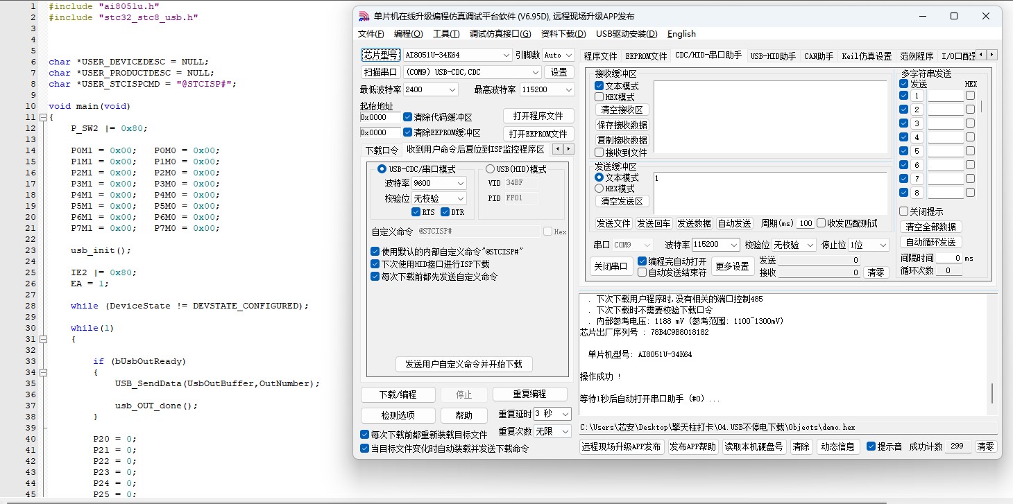

第四集 不停电下载
  2. #include "stc32_stc8_usb.h"
  3. char *USER_DEVICEDESC = NULL;
  4. char *USER_PRODUCTDESC = NULL;
  5. char *USER_STCISPCMD = "@STCISP#";
  6. void main(void)
  7. {
  8.     P_SW2 |= 0x80;
  9.
  10.     P0M1 = 0x00;   P0M0 = 0x00;
  11.     P1M1 = 0x00;   P1M0 = 0x00;
  12.     P2M1 = 0x00;   P2M0 = 0x00;
  13.     P3M1 = 0x00;   P3M0 = 0x00;
  14.     P4M1 = 0x00;   P4M0 = 0x00;
  15.     P5M1 = 0x00;   P5M0 = 0x00;
  16.     P6M1 = 0x00;   P6M0 = 0x00;
  17.     P7M1 = 0x00;   P7M0 = 0x00;
  18.
  19.     usb_init();
  20.     IE2 |= 0x80;
  21.     EA = 1;
  22.
  23.         while (DeviceState != DEVSTATE_CONFIGURED);
  24.
  25.         while(1)
  26.         {
  27.
  28.         if (bUsbOutReady)
  29.         {
  30.             USB_SendData(UsbOutBuffer,OutNumber);
  31.
  32.             usb_OUT_done();
  33.         }
  34.
  35.         P20 = 0;
  36.         P21 = 0;
  37.         P22 = 0;
  38.         P23 = 0;
  39.         P24 = 0;
  40.         P25 = 0;
  41.         P26 = 0;
  42.         P27 = 0;
  43.         }
  44. }

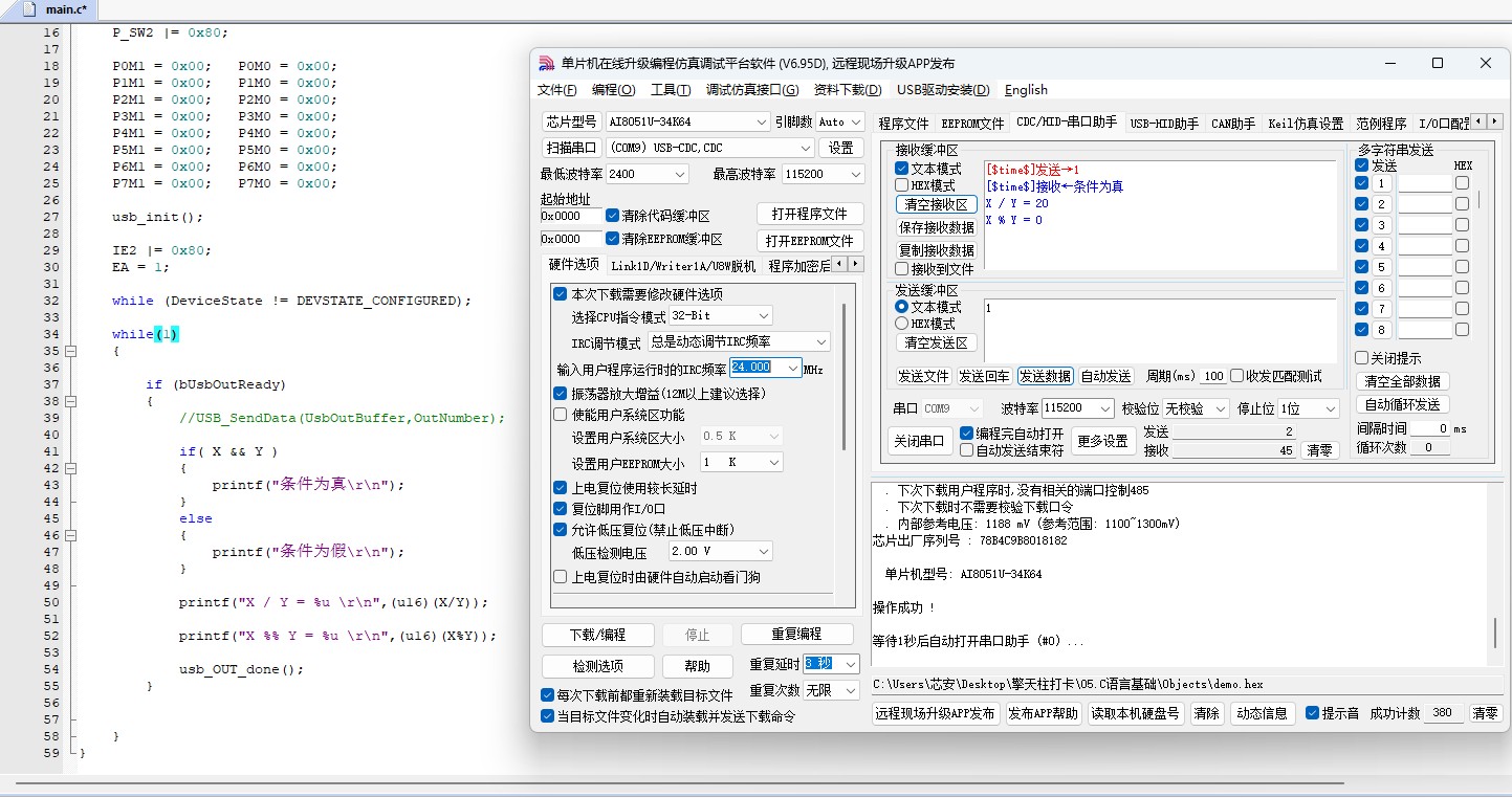

第五集 使用【Ai8051U】擎天柱核心板—— C语言基础
代码如下:
  3. #define u8  unsigned char
  4. #define u16 unsigned int
  5.
  6. u8 X = 200;
  7. u8 Y = 10;
  8. char *USER_DEVICEDESC = NULL;
  9. char *USER_PRODUCTDESC = NULL;
  10. char *USER_STCISPCMD = "@STCISP#";
  11. void main(void)
  12. {
  13.     P_SW2 |= 0x80;
  14.
  15.     P0M1 = 0x00;   P0M0 = 0x00;
  16.     P1M1 = 0x00;   P1M0 = 0x00;
  17.     P2M1 = 0x00;   P2M0 = 0x00;
  18.     P3M1 = 0x00;   P3M0 = 0x00;
  19.     P4M1 = 0x00;   P4M0 = 0x00;
  20.     P5M1 = 0x00;   P5M0 = 0x00;
  21.     P6M1 = 0x00;   P6M0 = 0x00;
  22.     P7M1 = 0x00;   P7M0 = 0x00;
  23.
  24.         usb_init();
  25.     IE2 |= 0x80;
  26.     EA = 1;
  27.
  28.         while (DeviceState != DEVSTATE_CONFIGURED);
  29.
  30.         while(1)
  31.         {
  32.
  33.         if (bUsbOutReady)
  34.         {
  35.             //USB_SendData(UsbOutBuffer,OutNumber);
  36.
  37.                         if( X && Y )
  38.                         {
  39.                                 printf("条件为真\r\n");
  40.                         }
  41.                         else
  42.                         {
  43.                                 printf("条件为假\r\n");
  44.                         }
  45.
  46.                         printf("X / Y = %u \r\n",(u16)(X/Y));
  47.
  48.                         printf("X %% Y = %u \r\n",(u16)(X%Y));
  49.
  50.             usb_OUT_done();
  51.         }
  52.         }
  53. }
