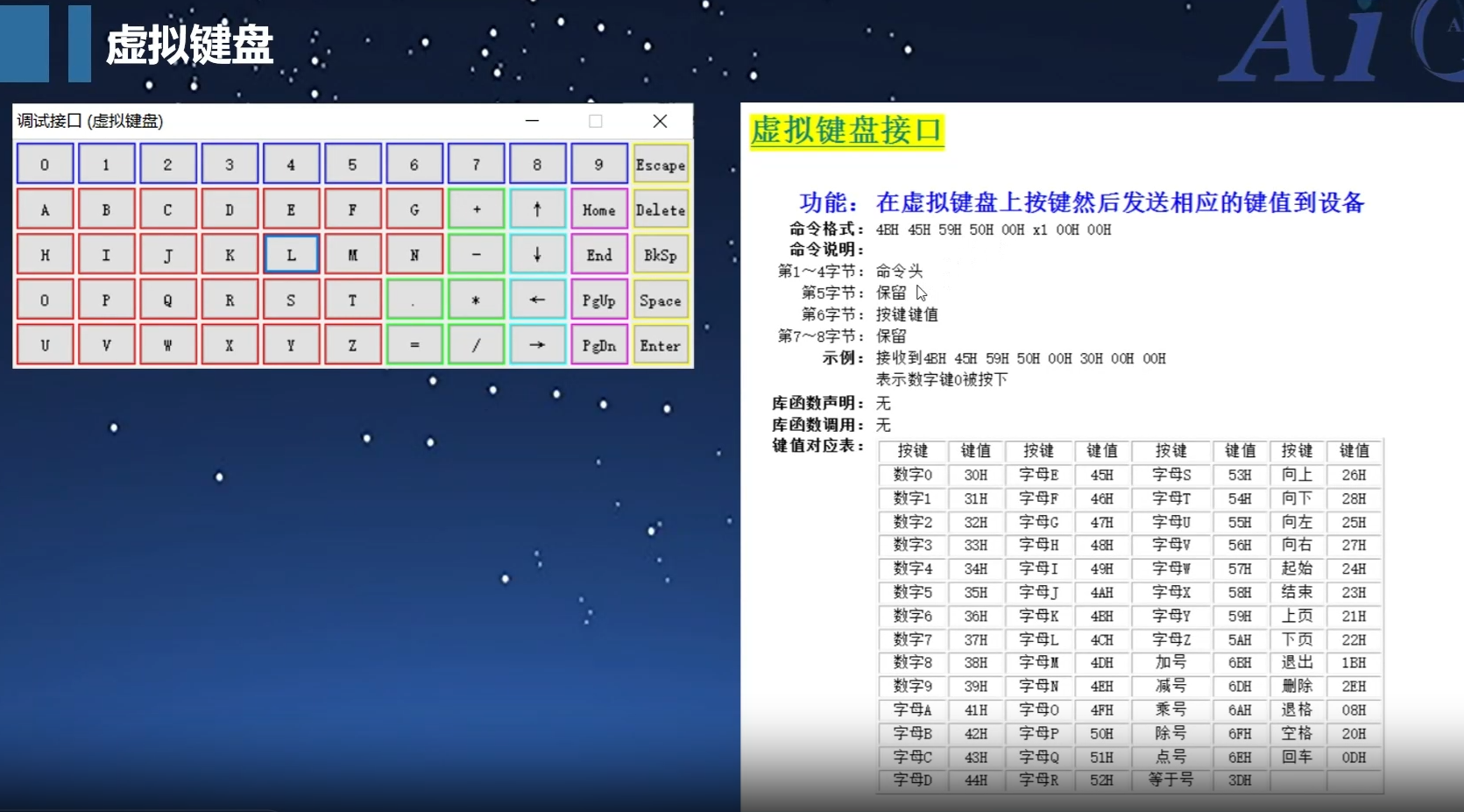

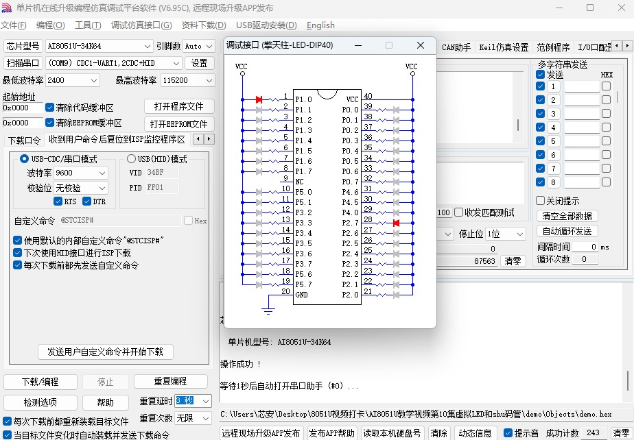

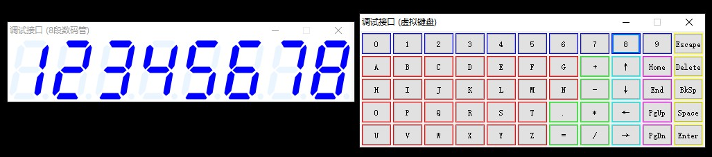

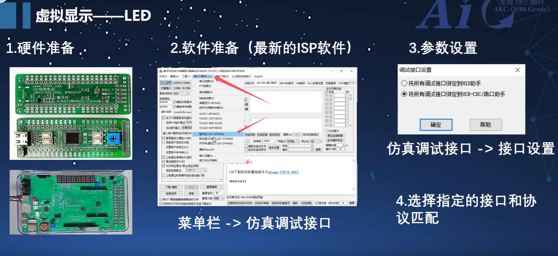

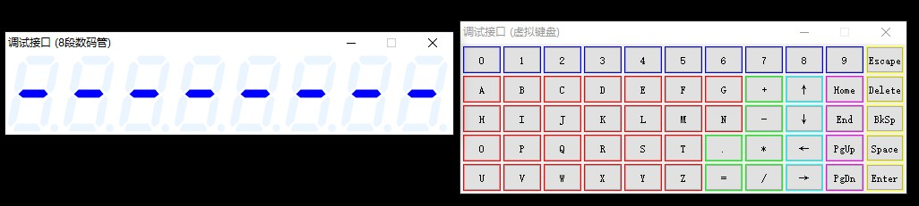

第十集 虚拟LED和数码管
本节主要介绍了ISP软件上的虚拟LED,数码管和虚拟键盘等仿真功能的使用流程及注意事项

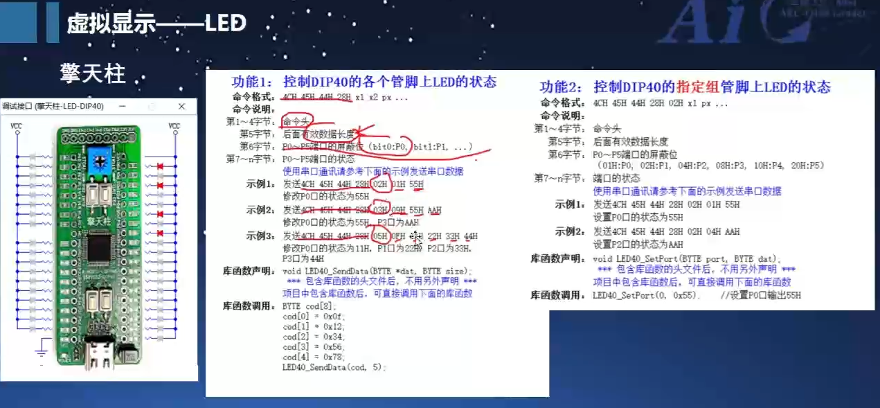

虚拟LED
虚拟数码管
虚拟键盘
任务1:P2口流水灯,P10闪烁
  1. void TASK_1( void )
  2. {
  3.         LED40_SetPort(2,~P2_STATE);                //点亮P20端口
  4.         P2_STATE = (P2_STATE<<1);                //1000 0000 _> 1 0000 0000
  5.         if( P2_STATE == 0 )
  6.         {
  7.                 P2_STATE = 1;
  8.         }
  9.
  10.         if( P10_STATE == 0)
  11.         {
  12.                 LED40_SetBit(1,0);
  13.         }
  14.         else
  15.         {
  16.                 LED40_ClrBit(1,0);
  17.         }
  18.         P10_STATE = !P10_STATE;
  19. }

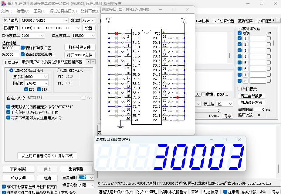

任务2:左边数码管显示P32按下次数 右边数码管显示P33按下次数
  1. void TASK_2( void )
  2. {
  3.         KEY_Count = KEY1_COUNT *10000 + KEY2_COUNT;
  4.         SEG7_ShowLong(KEY_Count ,10);
  5. }

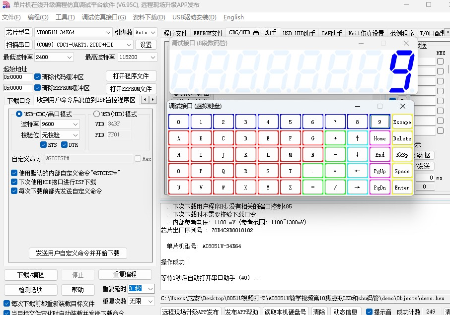

任务3:按下数字按键在数码管显示对应的按键数字
  1. void TASK_3( void )
  2. {
  3.         SEG7_ShowLong( REC_NUM ,10);
  4. }

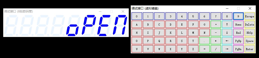

  46.         switch(rec_vkey)
  47.         {
  48.                 case 0:cod[index] = t_display[rec_vkey];rec_vkey = 0xff;index++;if(index > 8){overflag = 1;index = 0;}break;
  49.                 case 1:cod[index] = t_display[rec_vkey];rec_vkey = 0xff;index++;if(index > 8){overflag = 1;index = 0;}break;
  50.                 case 2:cod[index] = t_display[rec_vkey];rec_vkey = 0xff;index++;if(index > 8){overflag = 1;index = 0;}break;
  51.                 case 3:cod[index] = t_display[rec_vkey];rec_vkey = 0xff;index++;if(index > 8){overflag = 1;index = 0;}break;
  52.                 case 4:cod[index] = t_display[rec_vkey];rec_vkey = 0xff;index++;if(index > 8){overflag = 1;index = 0;}break;
  53.                 case 5:cod[index] = t_display[rec_vkey];rec_vkey = 0xff;index++;if(index > 8){overflag = 1;index = 0;}break;
  54.                 case 6:cod[index] = t_display[rec_vkey];rec_vkey = 0xff;index++;if(index > 8){overflag = 1;index = 0;}break;
  55.                 case 7:cod[index] = t_display[rec_vkey];rec_vkey = 0xff;index++;if(index > 8){overflag = 1;index = 0;}break;
  56.                 case 8:cod[index] = t_display[rec_vkey];rec_vkey = 0xff;index++;if(index > 8){overflag = 1;index = 0;}break;
  57.                 case 9:cod[index] = t_display[rec_vkey];rec_vkey = 0xff;index++;if(index > 8){overflag = 1;index = 0;}break;
  58.                 default:rec_vkey = 0xff;break;
  59.         }
  60.
  61.         if(overflag)
  62.         {
  63.                 overflag = 0;
  64.                 if((cod[0]==t_display[1]) && (cod[1]==t_display[2]) && (cod[2]==t_display[3]) && (cod[3]==t_display[4]) && \
  65.                         (cod[4]==t_display[5]) && (cod[5]==t_display[6]) && (cod[6]==t_display[7]) && (cod[7]==t_display[8]))
  66.                 {
  67.                         cod[0] = 0x00;
  68.                         cod[1] = 0x00;
  69.                         cod[2] = 0x00;
  70.                         cod[3] = 0x00;
  71.                         cod[4] = 0x5C;
  72.                         cod[5] = 0x73;
  73.                         cod[6] = 0x79;
  74.                         cod[7] = 0x37;
  75.                 }
  76.                 else
  77.                 {
  78.                         cod[0] = 0x40;
  79.                         cod[1] = 0x40;
  80.                         cod[2] = 0x40;
  81.                         cod[3] = 0x40;
  82.                         cod[4] = 0x40;
  83.                         cod[5] = 0x40;
  84.                         cod[6] = 0x40;
  85.                         cod[7] = 0x40;
  86.                 }
  87.         }
  88.
  89. }

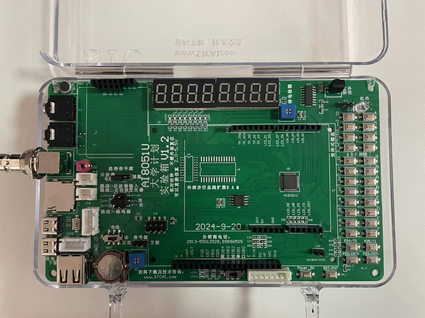

收到官方送的AI8051U实验箱啦,感谢官方支持!!!!!!!!!

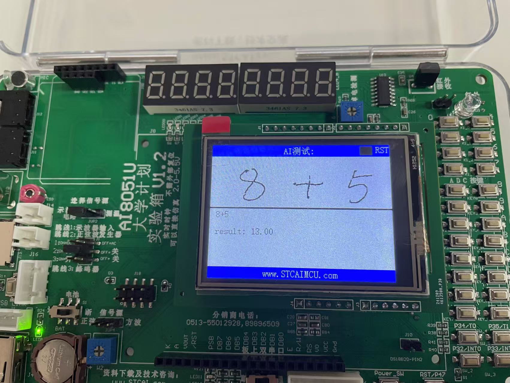

发表于 2024-12-26 13:33:37 | 显示全部楼层
冲哥的屏幕到了先来个手写计算器例程学习下

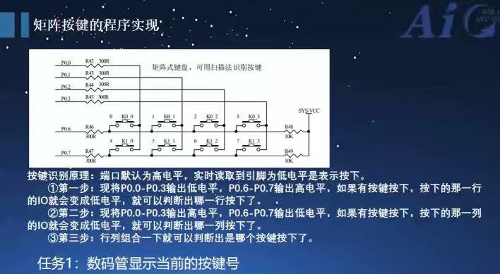

第11集 矩阵按键
一、矩阵按键介绍
与独立按键对比:
独立按键:一个按键占用一个 I/O 口。
矩阵按键:将按键排成行列矩阵形式,可减少 I/O 口占用。
矩阵按键的优势:
以较少的 I/O 口控制较多的按键。
例如:8 个 I/O 口可控制 16 个按键。
二、矩阵按键控制原理
按键检测原理:
先将部分引脚输出低电平,部分输出高电平。
若有按键按下,高电平引脚会被拉低。
通过改变输出电平的引脚,结合行和列的状态,可判断按下的按键。
三、矩阵按键程序编写
功能函数:
定义矩阵按键读取函数,返回按下按键的序号。
函数内通过三步操作判断按键状态:先输出特定电平,延时等待,读取引脚状态并计算。
优化函数:
通过静态变量记录上一次按键状态,与当前状态对比,避免重复输出。
