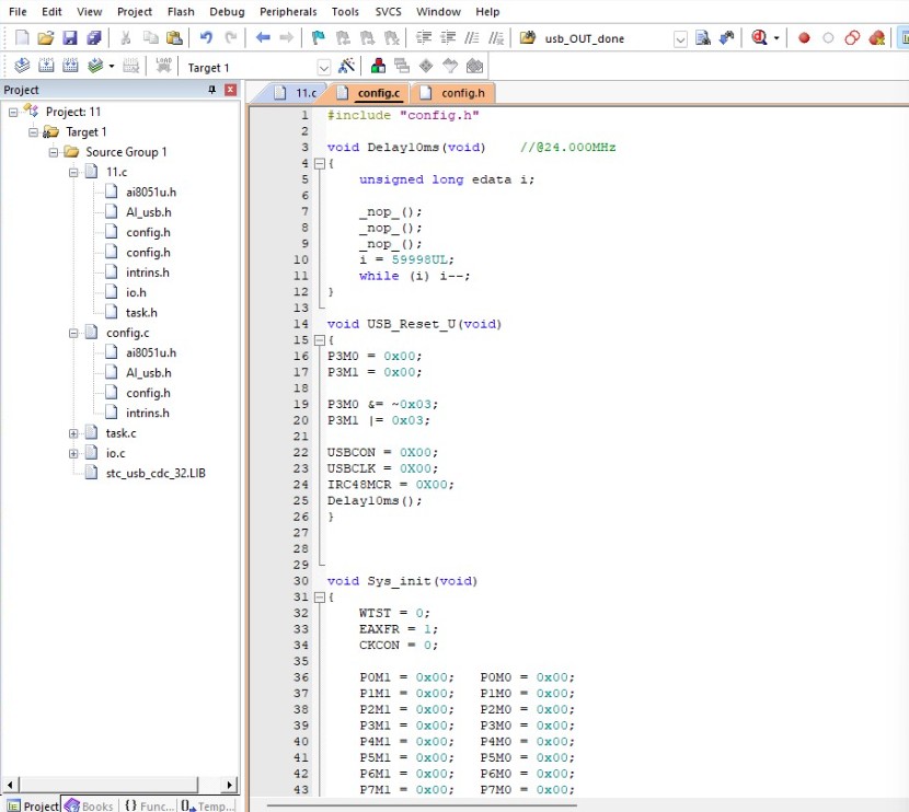

        _nop_();
        _nop_();
        _nop_();
        i = 59998UL;
        while (i) i--;
void USB_Reset_U(void)
P3M0 = 0x00;
P3M1 = 0x00;
P3M0 &= ~0x03;
P3M1 |= 0x03;
USBCON = 0X00;
USBCLK = 0X00;
IRC48MCR = 0X00;
Delay10ms();
void Sys_init(void)
    WTST = 0;
    EAXFR = 1;
    CKCON = 0;
    P0M1 = 0x00;   P0M0 = 0x00;
    P1M1 = 0x00;   P1M0 = 0x00;
    P2M1 = 0x00;   P2M0 = 0x00;
    P3M1 = 0x00;   P3M0 = 0x00;
    P4M1 = 0x00;   P4M0 = 0x00;
    P5M1 = 0x00;   P5M0 = 0x00;
    P6M1 = 0x00;   P6M0 = 0x00;
    P7M1 = 0x00;   P7M0 = 0x00;
    USB_Reset_U();
void Timer0_Init(void)        //1毫秒@24.000MHz
    TM0PS = 0x00;            //设置定时器时钟预分频 ( 注意:并非所有系列都有此寄存器,详情请查看数据手册 )
    AUXR &= 0x7F;            //定时器时钟12T模式
    TMOD &= 0xF0;            //设置定时器模式
    TL0 = 0x30;                //设置定时初始值
    TH0 = 0xF8;                //设置定时初始值
    TF0 = 0;                //清除TF0标志
    TR0 = 1;                //定时器0开始计时
    ET0 = 1;                //使能定时器0中断
任务二代码如下:
#include "config.h"
#include "task.h"
#include "io.h"
char *USER_DEVICEDESC = NULL;
void main(void)
        Sys_init();    //系统初始化
        usb_init();     //USB CDC 接口配置
    IE2 |= 0x80;
          Timer0_Init();
                Init_595();
    EA = 1;
          P40 = 0;
          while (DeviceState!=DEVSTATE_CONFIGURED);
          WDT_CONTR=0X24;
          while(1)
        if (bUsbOutReady)
            //USB_SendData(UsbOutBuffer,OutNumber);
            usb_OUT_done();
        Task_Pro_Handler_Callback();      //执行功能函数
        WDT_CONTR=0X34;
void Timer0_Isr(void) interrupt 1                //1毫秒执行一次
    Task_Marks_Handler_Callback        ();    //系统计时
dishier.mp4
