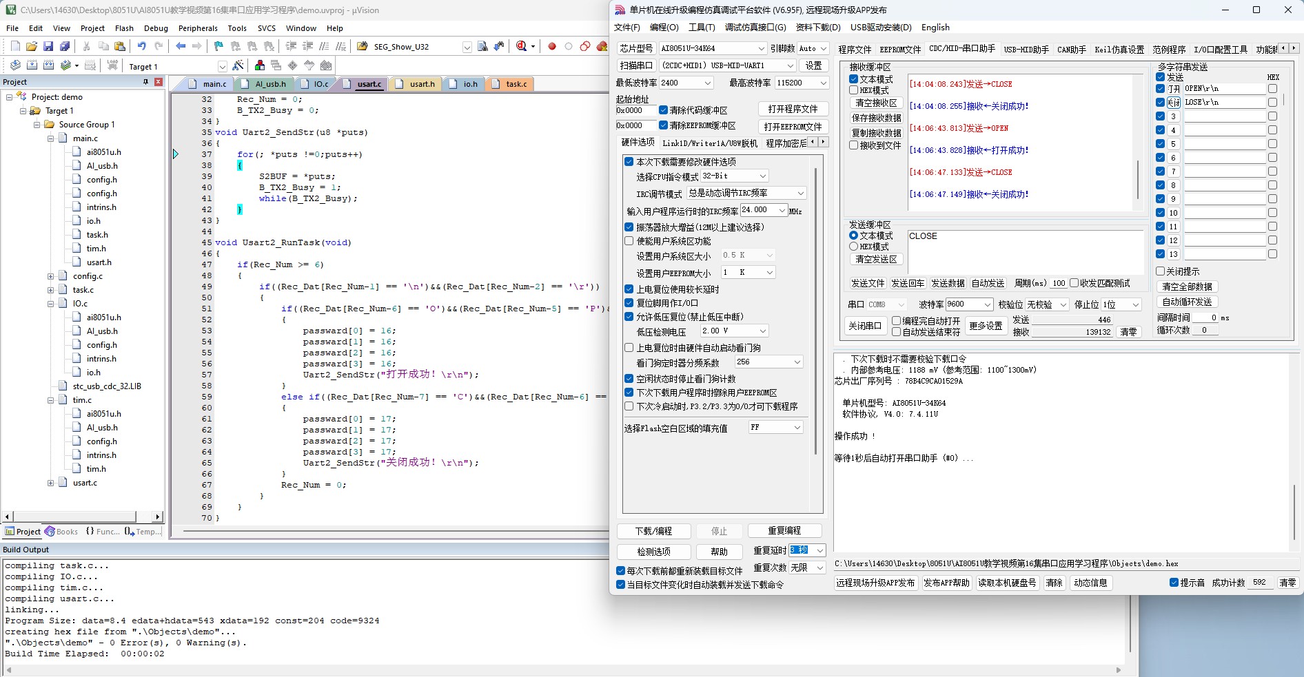

发表于 2025-2-14 14:11:39 | 显示全部楼层
打卡第十六集
#include "usart.h"
#include "io.h"
u8 Rec_Dat[50];
u8 Rec_Num = 0;
bit B_TX2_Busy = 0;
void Uart2_Isr(void) interrupt 8
        if (S2CON & 0x02)        //检测串口2发送中断
                S2CON &= ~0x02;        //清除串口2发送中断请求位
                B_TX2_Busy = 0;
        if (S2CON & 0x01)        //检测串口2接收中断
                S2CON &= ~0x01;        //清除串口2接收中断请求位
                Rec_Dat[Rec_Num++] = S2BUF;
void Uart2_Init(void)        //9600bps@24.000MHz
        P_SW2 |= 0x01;                                                //UART2/USART2: RxD2(P4.6), TxD2(P4.7)
        S2CON = 0x50;                //8位数据,可变波特率
        AUXR |= 0x04;                //定时器时钟1T模式
        T2L = 0x8F;                        //设置定时初始值
        T2H = 0xFD;                        //设置定时初始值
        AUXR |= 0x10;                //定时器2开始计时
        IE2 |= 0x01;                //使能串口2中断
        Rec_Num = 0;
        B_TX2_Busy = 0;
void Uart2_SendStr(u8 *puts)
        for(; *puts !=0;puts++)
                S2BUF = *puts;
                B_TX2_Busy = 1;
                while(B_TX2_Busy);
void Usart2_RunTask(void)
        if(Rec_Num >= 6)
                if((Rec_Dat[Rec_Num-1] == '\n')&&(Rec_Dat[Rec_Num-2] == '\r'))
                        if((Rec_Dat[Rec_Num-6] == 'O')&&(Rec_Dat[Rec_Num-5] == 'P')&&(Rec_Dat[Rec_Num-4] == 'E')&&(Rec_Dat[Rec_Num-3] == 'N'))
                                passward[0] = 16;
                                passward[1] = 16;
                                passward[2] = 16;
                                passward[3] = 16;
                                Uart2_SendStr("打开成功!\r\n");
                        else if((Rec_Dat[Rec_Num-7] == 'C')&&(Rec_Dat[Rec_Num-6] == 'L')&&(Rec_Dat[Rec_Num-5] == 'O')&&(Rec_Dat[Rec_Num-4] == 'S')&&(Rec_Dat[Rec_Num-3] == 'E'))
                                passward[0] = 17;
                                passward[1] = 17;
                                passward[2] = 17;
                                passward[3] = 17;
                                Uart2_SendStr("关闭成功!\r\n");
                        Rec_Num = 0;
附手敲程序
AI8051U教学视频第16集串口应用学习程序.zip (215.31 KB, 下载次数: 39)
