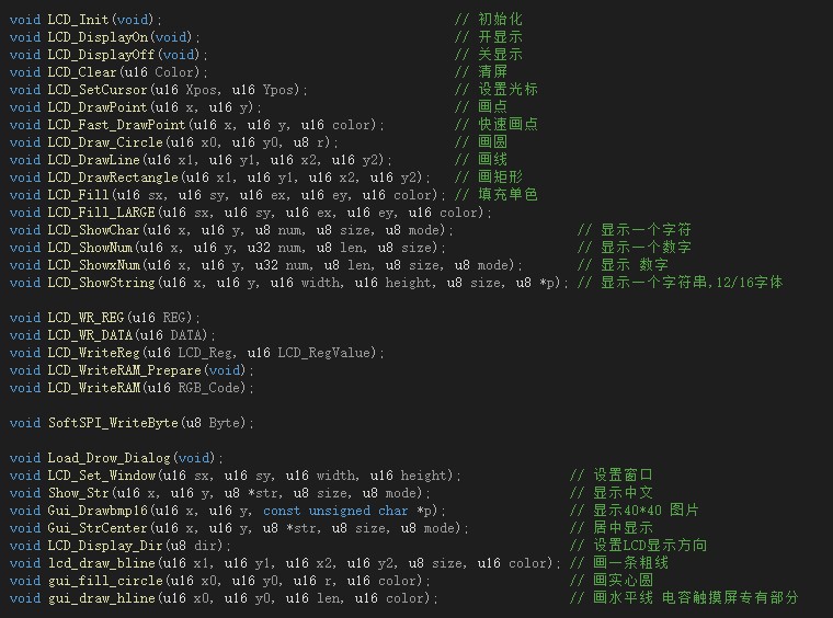

可以用这个程序。
* @name       :void _draw_circle_8(int xc, int yc, int x, int y, u16 c)
* @date       :2018-08-09
* @function   :8 symmetry circle drawing algorithm (internal call)
* @parameters :xc:the x coordinate of the Circular center
                yc:the y coordinate of the Circular center
                                x:the x coordinate relative to the Circular center
                                y:the y coordinate relative to the Circular center
                                c:the color value of the circle
* @retvalue   :None
    GUI_DrawPoint(xc + x, yc + y, c);
    GUI_DrawPoint(xc - x, yc + y, c);
    GUI_DrawPoint(xc + x, yc - y, c);
    GUI_DrawPoint(xc - x, yc - y, c);
    GUI_DrawPoint(xc + y, yc + x, c);
    GUI_DrawPoint(xc - y, yc + x, c);
    GUI_DrawPoint(xc + y, yc - x, c);
    GUI_DrawPoint(xc - y, yc - x, c);

一般用GUI库,这些画线画圈,显示文字的函数都是封装好的,只需要输入坐标信息、颜色信息。找对应的驱动示例工程里一般就有。

可以参考例程函数,直接用也可以
