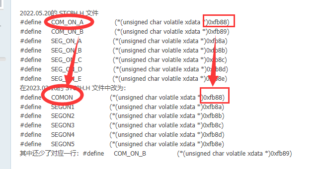

2022.05.20的 STC8H.H 文件
#define     COM_ON_A                (*(unsigned char volatile xdata *)0xfb88)
#define     COM_ON_B                (*(unsigned char volatile xdata *)0xfb89)
#define     SEG_ON_A                (*(unsigned char volatile xdata *)0xfb8a)
#define     SEG_ON_B                (*(unsigned char volatile xdata *)0xfb8b)
#define     SEG_ON_C                (*(unsigned char volatile xdata *)0xfb8c)
#define     SEG_ON_D                (*(unsigned char volatile xdata *)0xfb8d)
#define     SEG_ON_E                (*(unsigned char volatile xdata *)0xfb8e)
在2023.02.16的 STC8H.H 文件中改为:
#define     COMON                   (*(unsigned char volatile xdata *)0xfb88)
#define     SEGON1                  (*(unsigned char volatile xdata *)0xfb8a)
#define     SEGON2                  (*(unsigned char volatile xdata *)0xfb8b)
#define     SEGON3                  (*(unsigned char volatile xdata *)0xfb8c)
#define     SEGON4                  (*(unsigned char volatile xdata *)0xfb8d)
#define     SEGON5                  (*(unsigned char volatile xdata *)0xfb8e)
其中还少了对应一行:#define     COM_ON_B                (*(unsigned char volatile xdata *)0xfb89)
