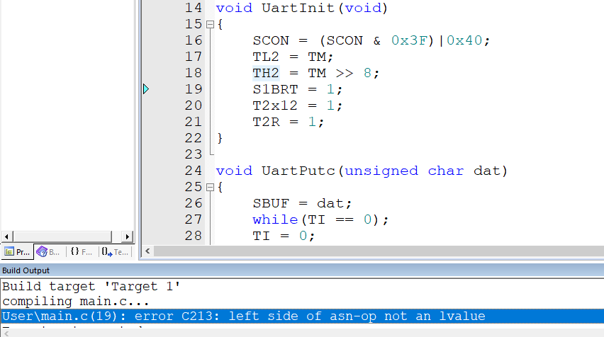

//8bit
//测试工作频率为11.0592MHz
#include <AI8051U.H>
#include "intrins.h"
#include "stdio.h"
#define        MAIN_Fosc                22118400L
#define        Baudrate                115200L
#define        TM                                (65536-(MAIN_Fosc/Baudrate+2)/4)
bit                B1S_Flag;
void RTC_config(void);
void UartInit(void)
        SCON = (SCON & 0x3F)|0x40;
        T2L = TM;
        T2H = TM >> 8;
        S1BRT = 1;
        T2x12 = 1;
        T2R = 1;
void UartPutc(unsigned char dat)
        SBUF = dat;
        while(TI == 0);
        TI = 0;
char putchar(char c)
        UartPutc(c);
        return c;
void RTC_Isr() interrupt 13
        if(RTCIF & 0x08)
                RTCIF &= ~0x08;
                B1S_Flag = 1;
void main(void)
        P_SW2 = 0x80;                //使能XFR,没有冲突不用关闭
        CKCON = 0x00;                //设置外部数据总线速度为最快
        WTST = 0x00;                //设置程序代码等待参数
                                                //赋值为0可将CPU执行程序的速度设置为最快
        P0M1 = 0x00;        P0M0 = 0x00;//配置P0口为准双向口
        P1M1 = 0x00;        P1M0 = 0x00;//配置P1口为准双向口
        P2M1 = 0x00;        P2M0 = 0x00;//配置P2口为准双向口
        P3M1 = 0x00;        P3M0 = 0x00;//配置P3口为准双向口
        P4M1 = 0x00;        P4M0 = 0x00;//配置P4口为准双向口
        P5M1 = 0x00;        P5M0 = 0x00;//配置P5口为准双向口
        UartInit();
        RTC_config();
        EA = 1;
        printf("RTC Test Programme!\r\n");
        while(1)
                if(B1S_Flag)
                        B1S_Flag = 0;
                        printf("Year=20%bd ",YEAR);
                        printf("Month=%bd ",MONTH);
                        printf("Day=%bd ",DAY);
                        printf("Hour=%bd ",HOUR);
                        printf("Minute=%bd ",MIN);
                        printf("Second=%bd ",SEC);
                        printf("\r\n");
        X32KCR = 0xC0;
        while(!(X32KCR & 0x01));
        RTCCFG &= ~0x02;
        INIYEAR = 21;
        INIMONTH = 12;
        INIDAY = 31;
        INIHOUR = 23;
        INIMIN = 59;
        INISEC = 50;
        INISSEC = 0;
        RTCIF = 0;
        RTCIEN = 0X08;
        RTCCR = 0X01;
        RTCCFG |= 0X01;
        while(RTCCFG & 0x01);
编译后会报错
User\main.c(17): error C202: 'T2L': undefined identifier
User\main.c(18): error C202: 'T2H': undefined identifier
在头文件里我没有找到T2L、T2H,但是找到了TL2、TH2
但是会报一个User\main.c(19): error C213: left side of asn-op not an lvalue
无法解决,求大佬帮助

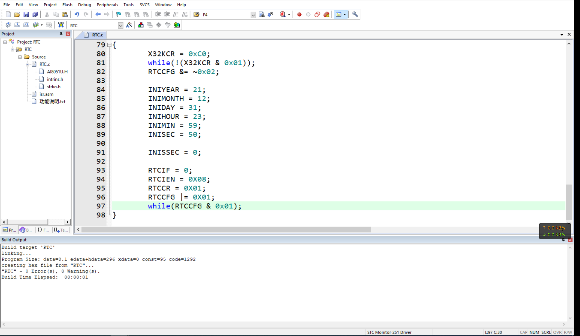

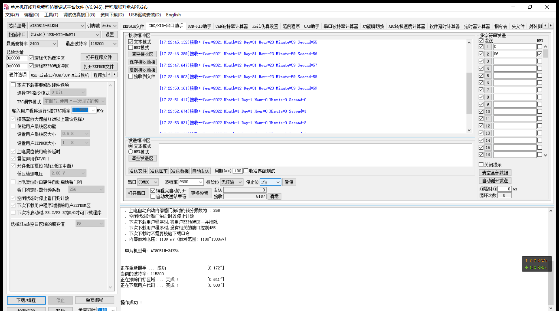

RTC并无问题,可以使用,但是串口不知道哪里错了,求大佬指点
RTC实时时钟(LCD1602).zip
229.11 KB, 下载次数: 78
回复 支持 反对
