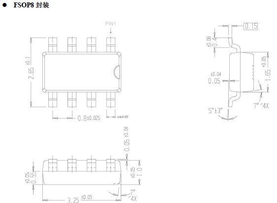

I came across a new package recently, FSOP8 (3.25 x 2.85mm 0.8mm pitch) used by LED drivers, (eg WS2814F).
Q:  Can the STC die fit into this package?
Image attached

发表于 2024-11-2 16:02:08 | 显示全部楼层
据说芯片比较大,可能放不下

发表于 2024-11-2 16:49:51 | 显示全部楼层
应该就是SOT23-8大小的封装吧,
想体积小不如用现成的DFN-8或QFN-20封装

 楼主| 发表于 2024-11-3 13:38:40 | 显示全部楼层
SOT23-8 is very similar, tho 25% thicker,
FSOP8 likely has larger die paddle area, otherwise WS2814F would be in SOT23-8 ?
DFN8 is not gull wing, and the exposed PAD means the routed PCB space is larger, as no vias can go under package.
