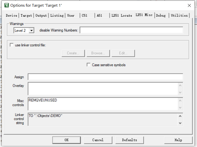

STC8H编译时提升错误:LX51 LINKER/LOCATER V4.66.30.0 - SN: K1DZC-PIGMVC
COPYRIGHT ARM Germany GmbH 1995 - 2014
@.\Objects\DEMO.lnp ".\Objects\man.obj",
".\stc_usb_cdc_8h_xdata.LIB"
TO ".\Objects\DEMO"
PRINT(".\Listings\DEMO.map") REMQVEUNUSED
*** ERROR L204: INVALID KEYWORD
    POS: 117
    h_xdata.LIB TO .\Objects\DEMO PRINT (.\Listings\DEMO.map) REMQVEUNUSED
Target not created.
Build Time Elapsed:  00:00:00

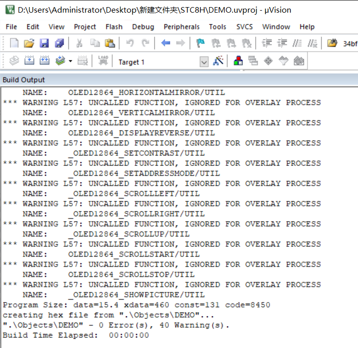

删除REMQVEUNUSED后可以编译,有40个警告:".\Objects\DEMO" - 0 Error(s), 40 Warning(s).

REMQVEUNUSED这个输错了。是REMOVEUNUSED

谢谢,确实这个原因.看论坛的视频有点模糊,自己有不熟悉造成的.谢谢指教
