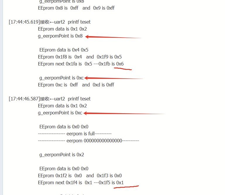

均衡磨损设置2个字节,中间总是会跳一次,然后数值就不正确了, 数值每次加1 为了方便观察

[17:44:45.619]接收←uart2  printf teset
                    EEprom data is 0x1 0x2
                    g_eerpomPoint is 0x8
                     EEprom data is 0x4 0x5
                    EEprom 0x1f8 is  0x4   and  0x1f9 is 0x5
                    EEprom next 0x1fa is  0x5 ---0x1fb is 0x6
                     g_eerpomPoint is 0xc
                    EEprom 0xc is  0xff   and  0xd is 0xff
[17:44:46.587]接收←uart2  printf teset
                     EEprom data is 0x0 0x0
                    ---------------- eerpom is full----------
                    ---------------- eerpom 000000000000000----------
                     g_eerpomPoint is 0x2
