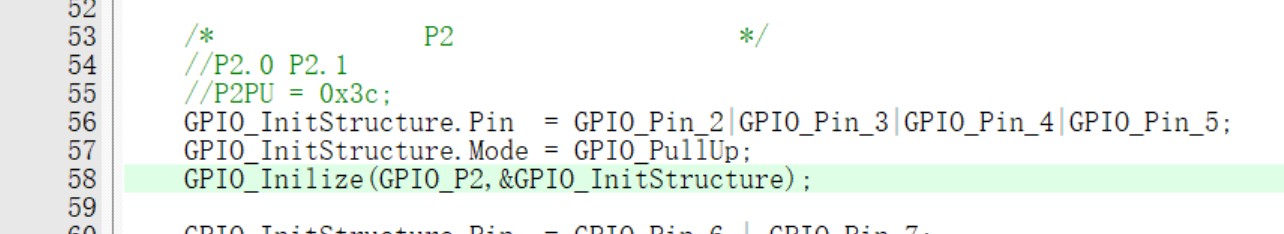

使用硬件SPI的方式,和oz3717通信,用逻辑分析仪挂出来数据正常,但读取SPDAT寄存器一直读到0xFF;
硬件上外部有上拉电阻
IO口初始化部分
    GPIO_InitTypeDef    GPIO_InitStructure;
    GPIO_InitStructure.Pin  = GPIO_Pin_2|GPIO_Pin_3|GPIO_Pin_4|GPIO_Pin_5;
    GPIO_InitStructure.Mode = GPIO_PullUp;
    GPIO_Inilize(GPIO_P2,&GPIO_InitStructure);
