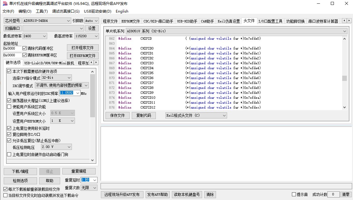

发表于 2024-9-15 18:47:47 | 显示全部楼层
再认真看下头文件里面声明了哪些
#define     CHIPID                  ( (unsigned char volatile xdata *)0xfde0)
#define     CHIPID0                 (*(unsigned char volatile xdata *)0xfde0)
#define     CHIPID1                 (*(unsigned char volatile xdata *)0xfde1)
#define     CHIPID2                 (*(unsigned char volatile xdata *)0xfde2)
#define     CHIPID3                 (*(unsigned char volatile xdata *)0xfde3)
#define     CHIPID4                 (*(unsigned char volatile xdata *)0xfde4)
#define     CHIPID5                 (*(unsigned char volatile xdata *)0xfde5)
#define     CHIPID6                 (*(unsigned char volatile xdata *)0xfde6)
#define     CHIPID7                 (*(unsigned char volatile xdata *)0xfde7)
#define     CHIPID8                 (*(unsigned char volatile xdata *)0xfde8)
#define     CHIPID9                 (*(unsigned char volatile xdata *)0xfde9)
#define     CHIPID10                (*(unsigned char volatile xdata *)0xfdea)
#define     CHIPID11                (*(unsigned char volatile xdata *)0xfdeb)
#define     CHIPID12                (*(unsigned char volatile xdata *)0xfdec)
#define     CHIPID13                (*(unsigned char volatile xdata *)0xfded)
#define     CHIPID14                (*(unsigned char volatile xdata *)0xfdee)
#define     CHIPID15                (*(unsigned char volatile xdata *)0xfdef)
#define     CHIPID16                (*(unsigned char volatile xdata *)0xfdf0)
#define     CHIPID17                (*(unsigned char volatile xdata *)0xfdf1)
#define     CHIPID18                (*(unsigned char volatile xdata *)0xfdf2)
#define     CHIPID19                (*(unsigned char volatile xdata *)0xfdf3)
#define     CHIPID20                (*(unsigned char volatile xdata *)0xfdf4)
#define     CHIPID21                (*(unsigned char volatile xdata *)0xfdf5)
#define     CHIPID22                (*(unsigned char volatile xdata *)0xfdf6)
#define     CHIPID23                (*(unsigned char volatile xdata *)0xfdf7)
#define     CHIPID24                (*(unsigned char volatile xdata *)0xfdf8)
#define     CHIPID25                (*(unsigned char volatile xdata *)0xfdf9)
#define     CHIPID26                (*(unsigned char volatile xdata *)0xfdfa)
#define     CHIPID27                (*(unsigned char volatile xdata *)0xfdfb)
#define     CHIPID28                (*(unsigned char volatile xdata *)0xfdfc)
#define     CHIPID29                (*(unsigned char volatile xdata *)0xfdfd)
#define     CHIPID30                (*(unsigned char volatile xdata *)0xfdfe)
#define     CHIPID31                (*(unsigned char volatile xdata *)0xfdff)

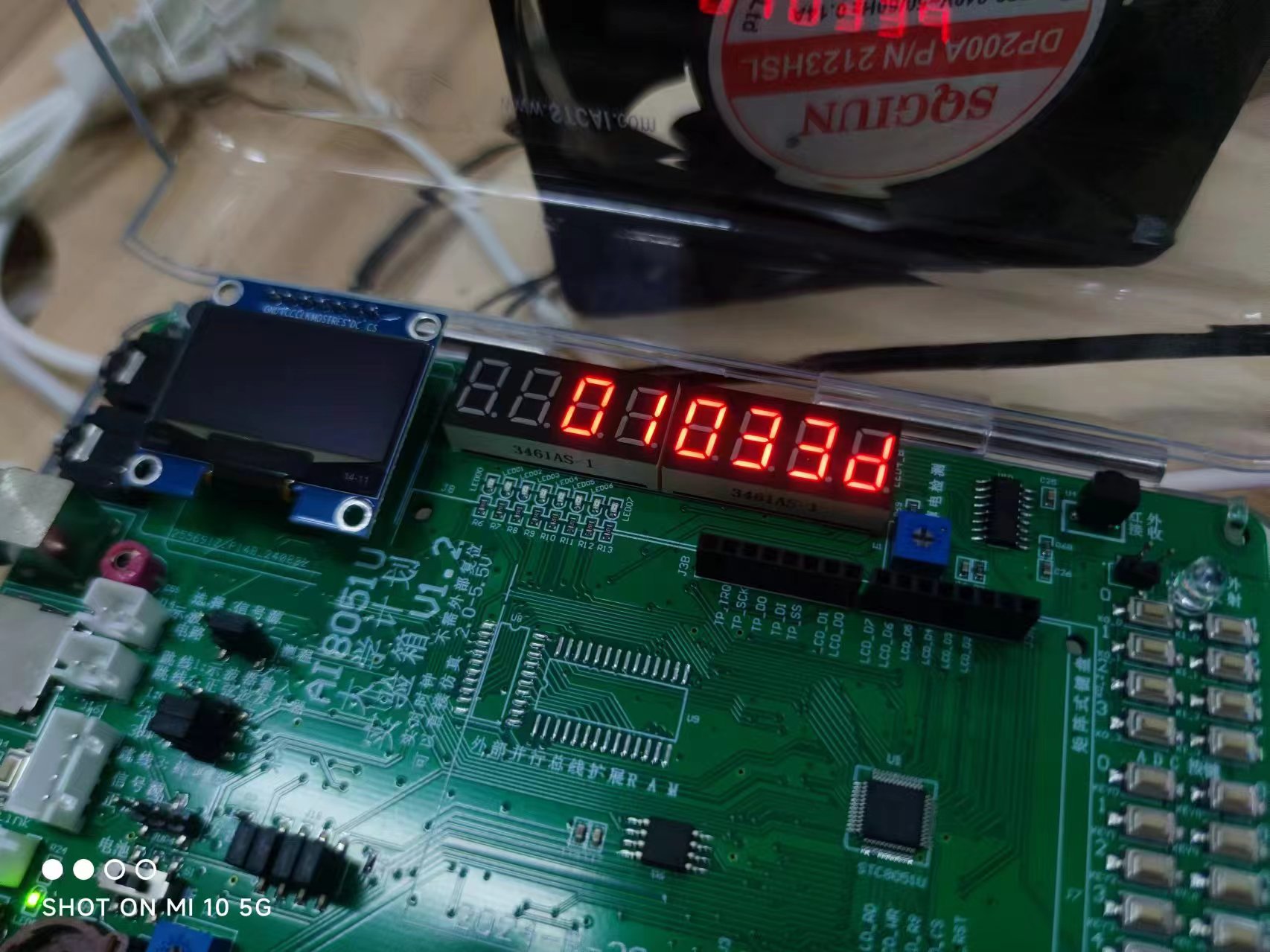

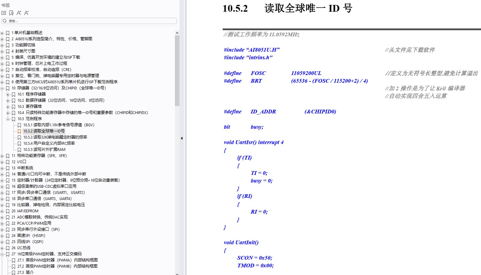

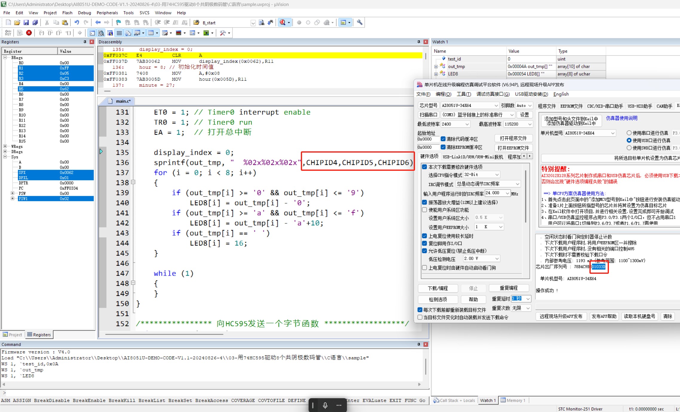

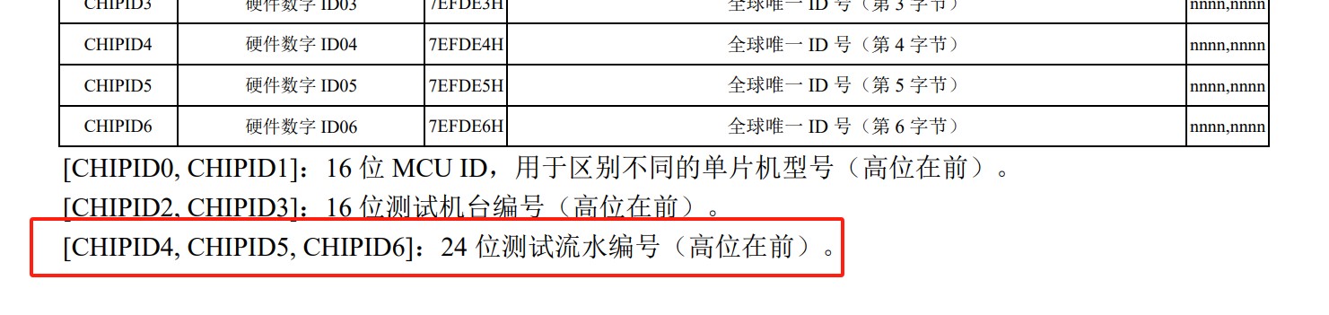

发表于 2024-9-15 19:58:04 | 显示全部楼层
beishe*** 发表于 2024-9-15 18:17
ai8051u 读取不出来 chipid 怎么办啊 求救
使用手里的AI8051试验箱测试读取CHIPID,与STCISP对照无误,应该是你的程序问题。
直接通过AI8051.h的定义读取就可以了,我这也是通过数码管显示十六进制。
程序内容和STCISP内的序列号
以下是程序实际运行结果,显示了最后24位的测试流水编号
有关定义:
