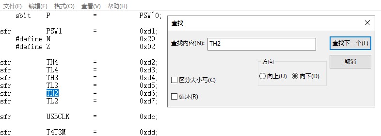

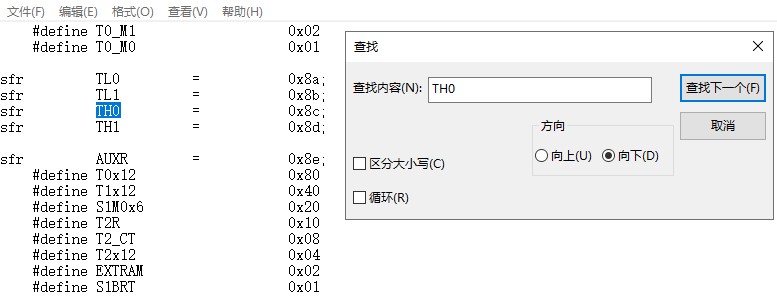

发表于 2024-9-15 13:44:07 | 显示全部楼层
sfr         TH4         =           0xd2;
sfr         TL4         =           0xd3;
sfr         TH3         =           0xd4;
sfr         TL3         =           0xd5;
sfr         TH2         =           0xd6;
sfr         TL2         =           0xd7;
sfr         TL0         =           0x8a;
sfr         TL1         =           0x8b;
sfr         TH0         =           0x8c;
sfr         TH1         =           0x8d;
可见:
T0H, T0L; TH0, TL0
T1H, T1L; TH1, TL1
T2H, T2L; TH2, TL2
T3H, T3L; TH3, TL3
T4H, T4L; TH4, TL4
上面2种风格都有人不同阶段的喜欢
还是都声明下好,也不增加成本
