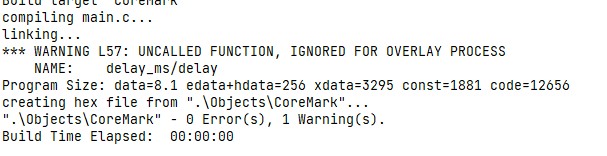

STC8051U CoreMark 测试 未成
研究半天 能运行但未成
输出如下错误
  1. 2K performance run parameters for coremark.
  2. [0]ERROR! list crc 0x919e - should be 0xe714
  3. [0]ERROR! matrix crc 0x0000 - should be 0x1fd7
  4. [0]ERROR! state crc 0x0000 - should be 0x8e3a
  5. CoreMark Size    : 666
  6. Total ticks      : 15
  7. Total time (secs): 0.015000
  8. Iterations/Sec   : 133.333300
  9. ERROR! Must execute for at least 10 secs for a valid result!
  10. Iterations       : 2
  11. Compiler version : Please put compiler version here (e.g. gcc 4.1)
  12. Compiler flags   : None
  13. Memory location  : STACK
  14. seedcrc          : 0xe9f5
  15. [0]crclist       : 0x919e
  16. [0]crcmatrix     : 0x0000
  17. [0]crcstate      : 0x0000
  18. [0]crcfinal      : 0x0db5
  19. Errors detected
修改半天 一直错误
有没有大佬测一下能跑多少分
