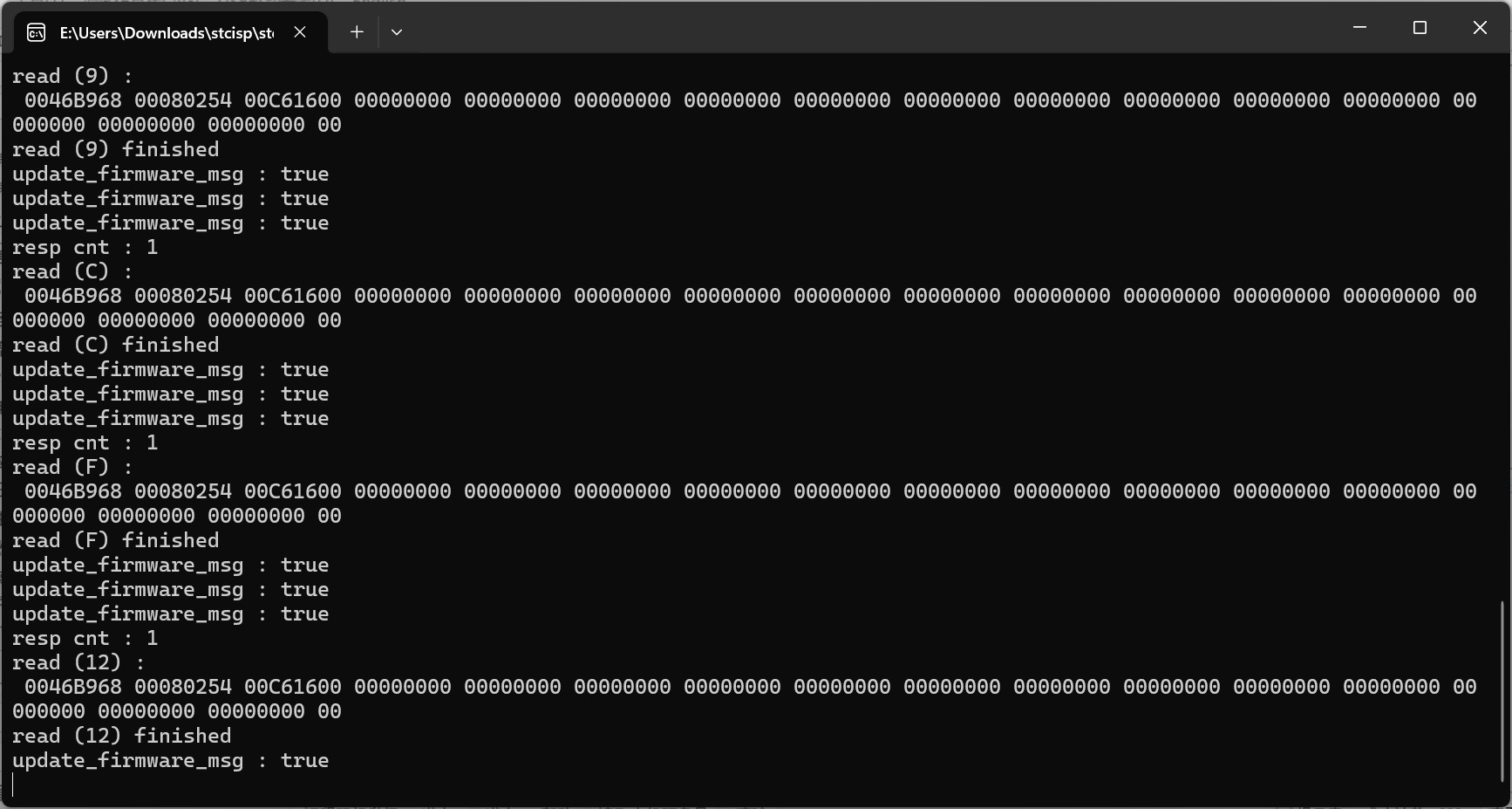

一下是升级时的输出信息。
Note:
        Step 1 : Copy HexFile to current dir.
        Step 2 : Reset current dev.
Found dev count : 0
Add Dev:   \\?\HID#VID_34BF&PID_1001#6&113DEE6B&0&0000#{4D1E55B2-F16F-11CF-88CB-001111000030}
Update001 : true
resp cnt : 1
read (0) :
0046B968 00380001 6E360046 2001FFFF FF3E3FBF AFF70074 5500F7E3 068A1628 461C1F1A 18020002 00049F24 0420600E 79ADE542 54729AC1 117A1600 00000000 00
read (0) finished
Update002 : true
resp cnt : 1
read (0) :
0046B968 00070100 70160000 00000000 00000000 00000000 00000000 00000000 00000000 00000000 00000000 00000000 00000000 00000000 00000000 00000000 00
read (0) finished
Update003 : true
resp cnt : 1
read (0) :
0046B968 00070500 74160000 00000000 00000000 00000000 00000000 00000000 00000000 00000000 00000000 00000000 00000000 00000000 00000000 00000000 00
read (0) finished
Update004 : true
.resp cnt : 1
read (0) :
0046B968 000E03F7 E3C98008 E22304A9 16000000 00000000 00000000 00000000 00000000 00000000 00000000 00000000 00000000 00000000 00000000 00000000 00
read (0) finished
0    :0200000400FFFB
1    :1000000002029DCAD8CA797D7374F87E70301202DC
2    :100010006B74F87E708012026B1202DF6CDD74FA72
3    :10002000CAB87AF1827AE183E4937C7BDAB812026F
4    :100030006B0B740BD0BED01078E474F87E70901205
5    :10004000026B1202DF6CDD74FACAB87AF1827AE1CF
6    :1000500083E4937C7BDAB812026B0B740BD0BED0B6
7    :100060001078E474F87E708812026B1202DF6CDD87
8    :1000700074FACAB87AF1827AE183E4937C7BDAB8C5
9    :1000800012026B0B740BD0BED01078E474F87E7043
A    :100090009812026B1202DF6CDD74FACAB87AF18230
B    :1000A0007AE183E4937C7BDAB812026B0B740BD099
C    :1000B000BED01040E4DA79DAD82275A000D281C22D
D    :1000C00084D2C57E3400041202F174F87E703012BE
E    :1000D000026B7E34000A1202B374F87E7030120292
F    :1000E0006B7E3400041202B374F87E700112026B4E
10    :1000F0007E34000A1202B374F87E700112026B7E25
11    :100100003400011202F174F87E700612026B7E3424
update_firmware_msg : true
resp cnt : 1
read (3) :
0046B968 00080254 00C61600 00000000 00000000 00000000 00000000 00000000 00000000 00000000 00000000 00000000 00000000 00000000 00000000 00000000 00
read (3) finished
resp cnt : 1
read (6) :
read (6) finished
resp cnt : 1
read (9) :
read (9) finished
resp cnt : 1
read (C) :
read (C) finished
resp cnt : 1
read (F) :
read (F) finished
resp cnt : 1
read (12) :
read (12) finished
