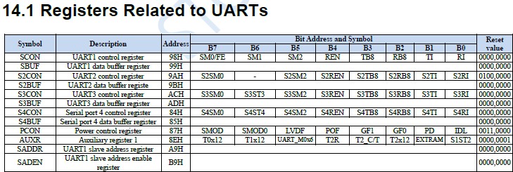

You need to check the SFR's used in your project.
The 80C320 itself is not quite 8051/8052 compatible, for example I can already see 80C320
CKCON [WD1 WD0 T2M T1M T0M MD2 MD1 MD0] 8Eh
conflicts with the usual  8051 AUXR at 8Eh
80C320 can use timer 2 for UART, whilst STC parts use other BAUD options.
You could also look at the AT89LP51RD2, which is more standard Timer2 etc and faster core. (Tho not quite as fast as STC8H)

我原方案是DS80C320 4T + 11.0592MHz方案,按道理我现在用STC89C516RD+ 6T + 20MHz的
性能比原方案强吧,但是串口9600波特率还是有中断重叠的情况,按道理不应该出现这情况。

主频升高了近一倍,当然更强。如有源码则调试串口程序到正常。如果引脚兼容,试试AI8051U...
