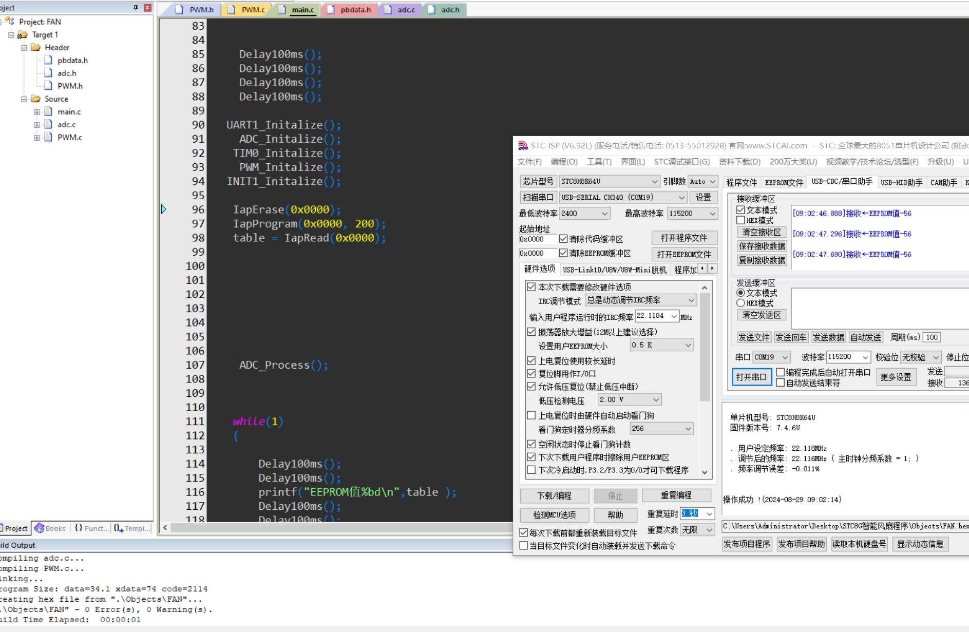

是这样的,我的全局变量 u8 table 没有赋初值,程序如下,但是打印出来的不是200,是不是哪个环节除啦问题啊大神,我用STC8H的EEPROM 一直没有成功过,头疼!
打印出来是-56

发表于 2024-8-29 15:23:28 | 显示全部楼层
#include "pbdata.h"
void UART1_Initalize(void);
void TIM0_Initalize(void);
void INIT1_Initalize(void);
void Delay100ms(void);
void IapIdle()
    IAP_CONTR = 0;                              //??IAP??
    IAP_CMD = 0;                                //???????
    IAP_TRIG = 0;                               //???????
    IAP_ADDRH = 0x80;                           //???????IAP??
    IAP_ADDRL = 0;
char IapRead(int addr)
    char dat;
    IAP_CONTR = 0x80;                           //??IAP
    IAP_TPS = 22;                               //??????12MHz
    IAP_CMD = 1;                                //??IAP???
    IAP_ADDRL = addr;                           //??IAP???
    IAP_ADDRH = addr >> 8;                      //??IAP???
    IAP_TRIG = 0x5a;                            //?????(0x5a)
    IAP_TRIG = 0xa5;                            //?????(0xa5)
    _nop_();
    dat = IAP_DATA;                             //?IAP??
    IapIdle();                                  //??IAP??
    return dat;
void IapProgram(int addr, char dat)
    IAP_CMD = 2;                                //??IAP???
    IAP_DATA = dat;                             //?IAP??
    _nop_();
void IapErase(int addr)
    IAP_CMD = 3;                                //??IAP????
    _nop_();                                    //
u8 table;
void main(void)
   P1M1=0x00;        P1M0=0x00;
         P3M1=0x00;        P3M0=0x00;
         P5M1=0x00;        P5M0=0x00;
                 Delay100ms();
                 Delay100ms();
                 Delay100ms();
                 Delay100ms();
         UART1_Initalize();
           ADC_Initalize();
                TIM0_Initalize();
                 PWM_Initalize();
         INIT1_Initalize();
    IapErase(0x0000);
    IapProgram(0x0000, 200);
    table = IapRead(0x0000);                       //P1
                 ADC_Process();
                while(1)
                          Delay100ms();
                    Delay100ms();
                                 printf("EEPROMÖµ%bd\n",table );

发表于 2024-8-29 15:25:28 | 显示全部楼层
    u8 table;
IapErase(0x0000);
我给地址0 擦除后 编程 地址0 ,数值为200,然后读取地址0,数值给table 然后打印出来就是-56
