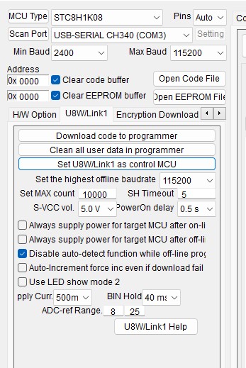

hi Everyone, I'm a new student.
I am working with U8W-Mini. But it's not working, it used to work before.
I have installed the driver.

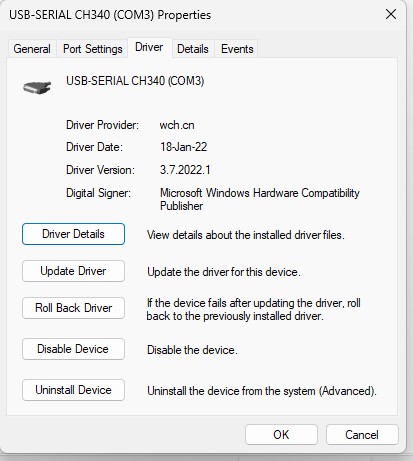

Device Manager:

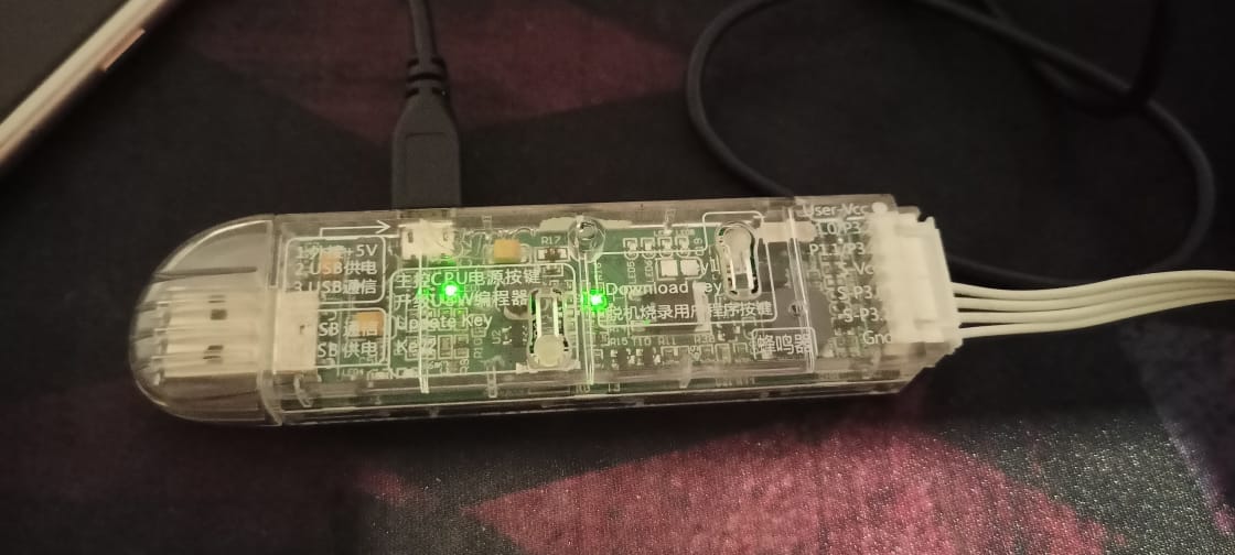

Only 2 LED lights that are on:
Settings:

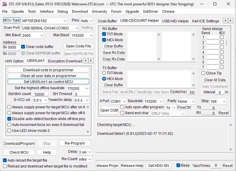

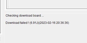

Everything I do, it will always Fail:
I have tried pressing Key 2 multiple time.
I have tried pressing and Holding Key 1 -> Pres Key 2 -> Release Key 2 -> Release Key 1. Still not working.
Can anyone help to explain what I should do?
Thank you.

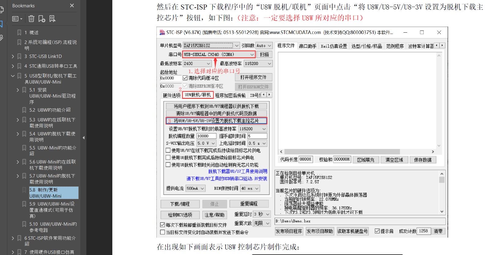

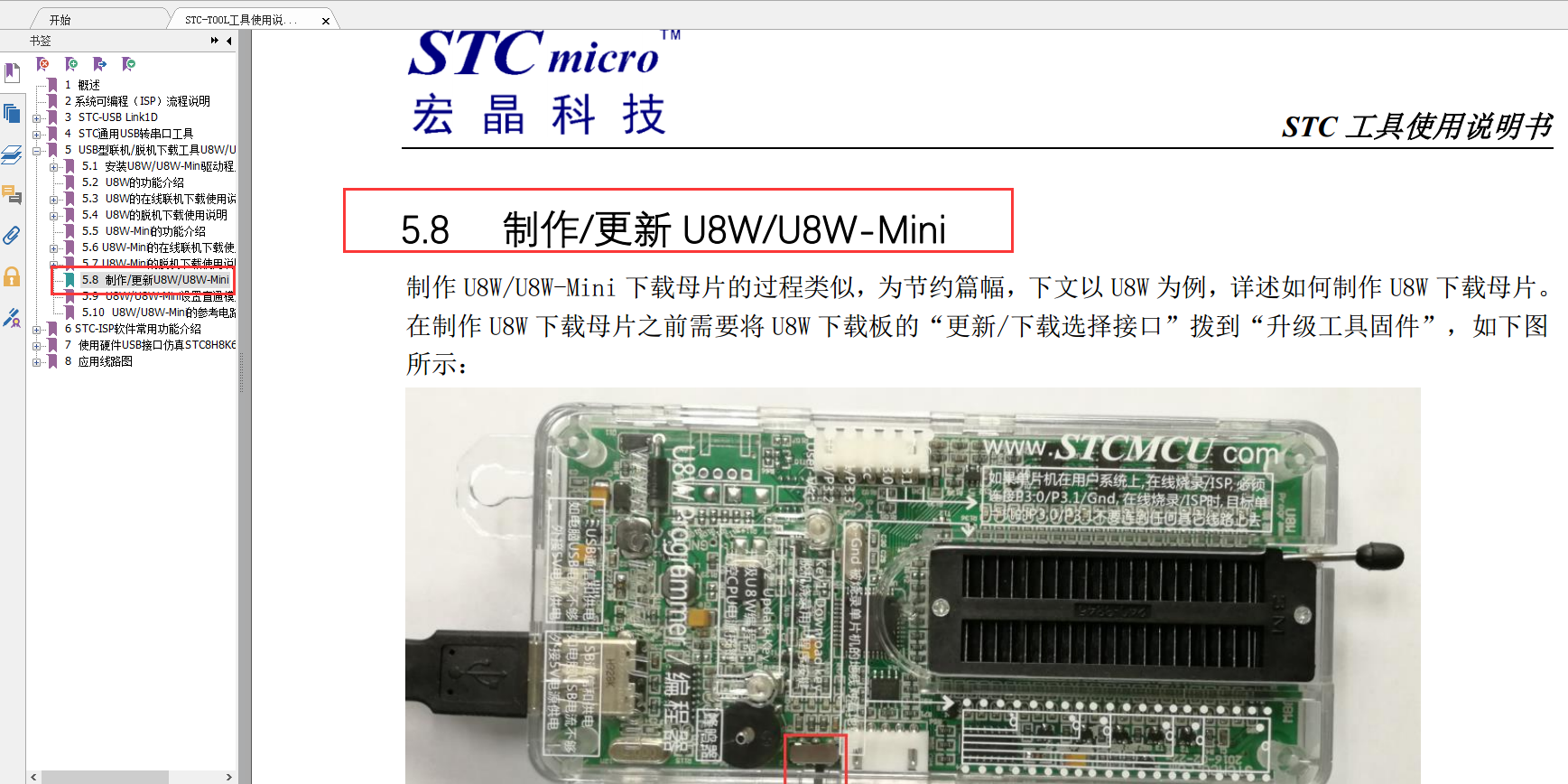

We have an instruction manual。 You need to update the U8W-MINI, you can refer to it here:
STC-TOOL工具使用说明-20221110.pdf
13.82 MB, 下载次数: 204
at this step, I cannot continue.
download failed

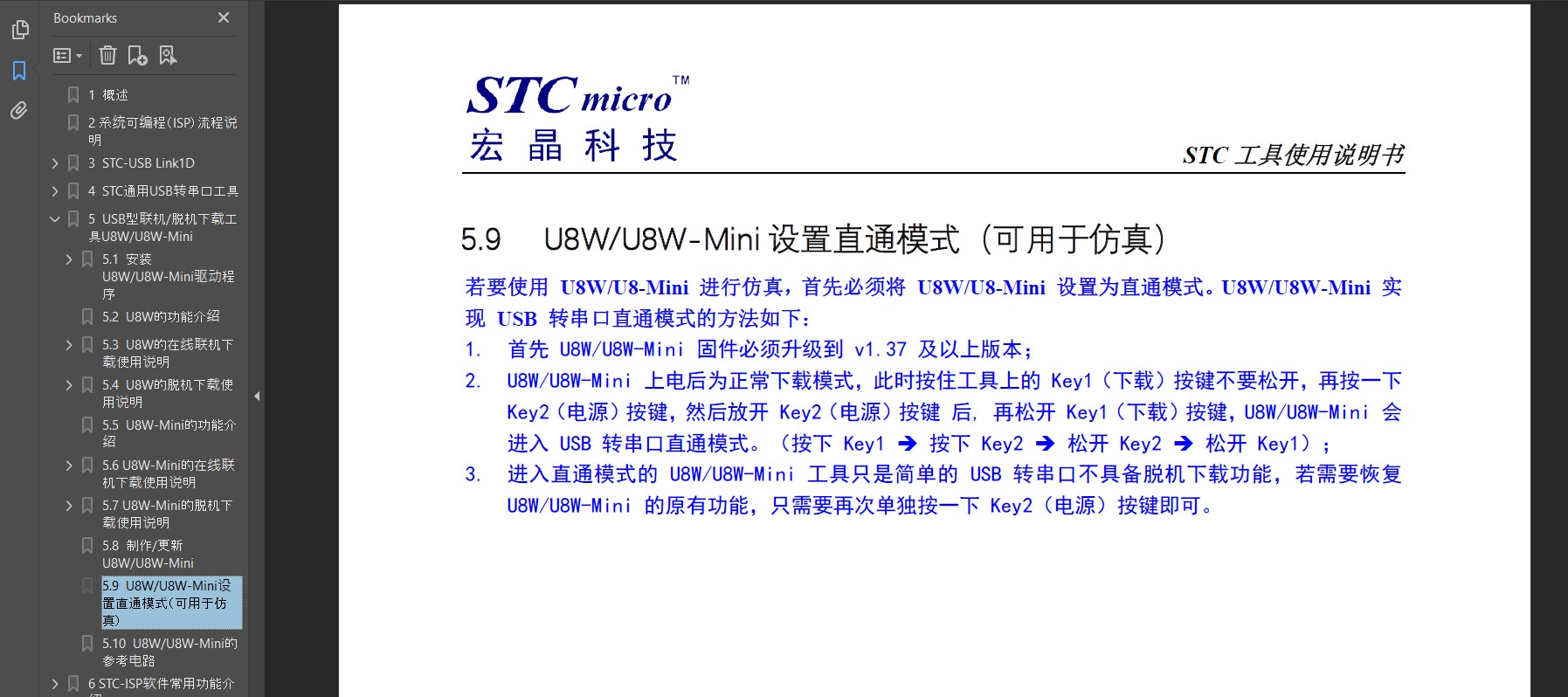

I continued to next chapter:
How can I know my firmware is v1.37?
I assumed my firmware is v1.37, and tried Press and hold Key 1, Press and hold key 2, release key 2, release key 1.
nothing happen.
how long do I keep pressing the button. until what happen should I stop pressing the button?
I tried double clicking Key 2. but nothing happen either.
you can answer in Chinese.

发表于 2023-2-17 13:11:56 | 显示全部楼层
如果点了第③步之后没有出现升级成功的提示,你可以按一下U8W-Mini上的Key2键试一下,看有没有升级成功的提示。

nothing. not even an LED blink, download failed again.
I tried press and hold, double clicking, just 1 click. none works.
How do I Know if my device is no longer working/broken?
如果升级时按key2也没有任何显示的话,这个U8W-MINI工具很有可能是坏了。你可以联系海外负责人沈小姐重新安排一套新的工具。沈小姐QQ:2269694595 微信:18106296594  详情 回复 发表于 2023-2-17 14:04
发表于 2023-2-17 13:55:49 | 显示全部楼层
is the MCU Type (on top left) matter?

发表于 2023-2-17 14:04:42 | 显示全部楼层
I tried press and hold, double clicking, j ...
