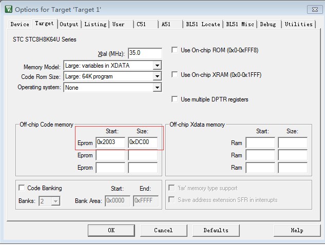

     Target的Eprpm Start改为0x2003,Eprom Size改为0xDC00.

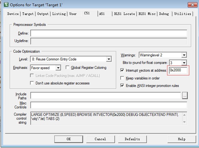

      C51的Interrupt Vectors at address改为0x2000
