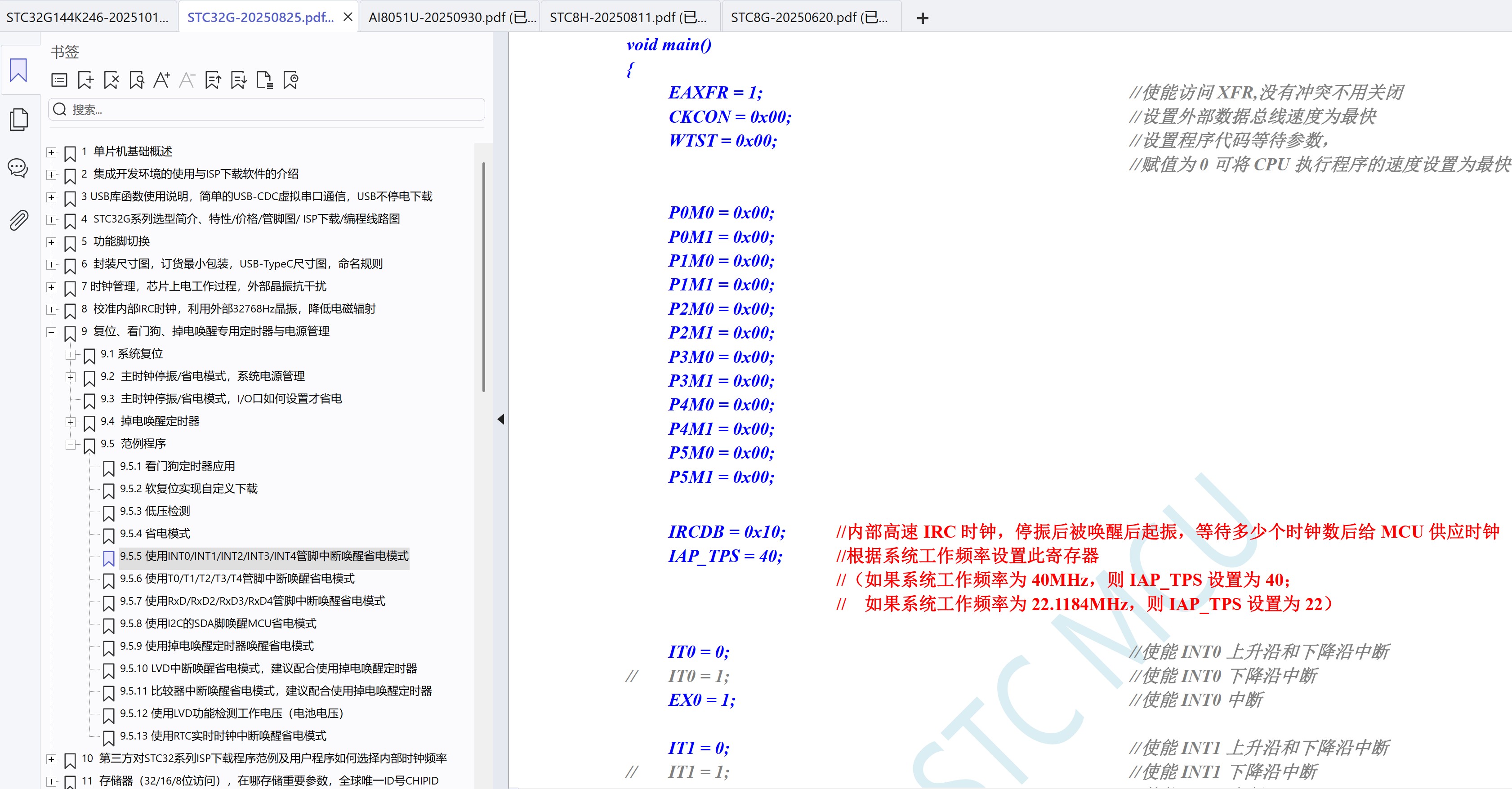

你好,按照你的要求,加了
                IRCDB = 0x10;
                IAP_TPS = 11;
效果一样的,一唤醒就复位
                P3_5 =0;
                P0M0=0x00;
                P0M1=0x00;
                P1M0=0x00;
                P1M1=0x00;
                P2M0=0x00;
                P2M1=0x00;
                P3M0=0x00;
                P3M1=0x00;
                P4M0=0x00;
                P4M1=0x00;
                P5M0=0x00;
                P5M1=0x00;
                P6M0=0x00;
                P6M1=0x00;
                P7M0=0x00;
                P7M1=0x00;
                P3M0 = 0x20;
                P3M1 = 0x00;
                P1M0        =        0x00;
                P1M1        |=        0xc8; //P1_3 为高阻输入,AD输入         P1_7 P1_6为高阻态 外部时钟输入
                P1IE &= ~0x0b;
                P5M0 |=0x10;
                P5M1 =0x00;
                P5_4 = 1;
                P3IE = 0xff;
                IRCDB = 0x10;
                IAP_TPS = 11;

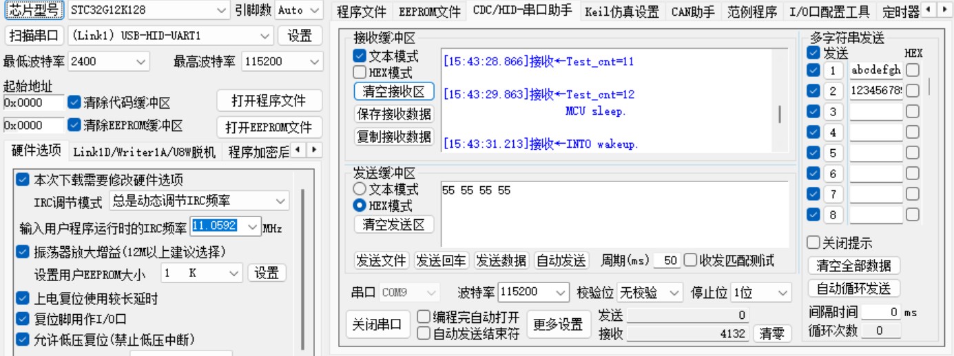

例子通过INT0,INT1唤醒休眠模式,主循环喂狗,串口打印MCU工作状态
外中断休眠唤醒-看门狗-STC32.zip
8.97 KB, 下载次数: 2
