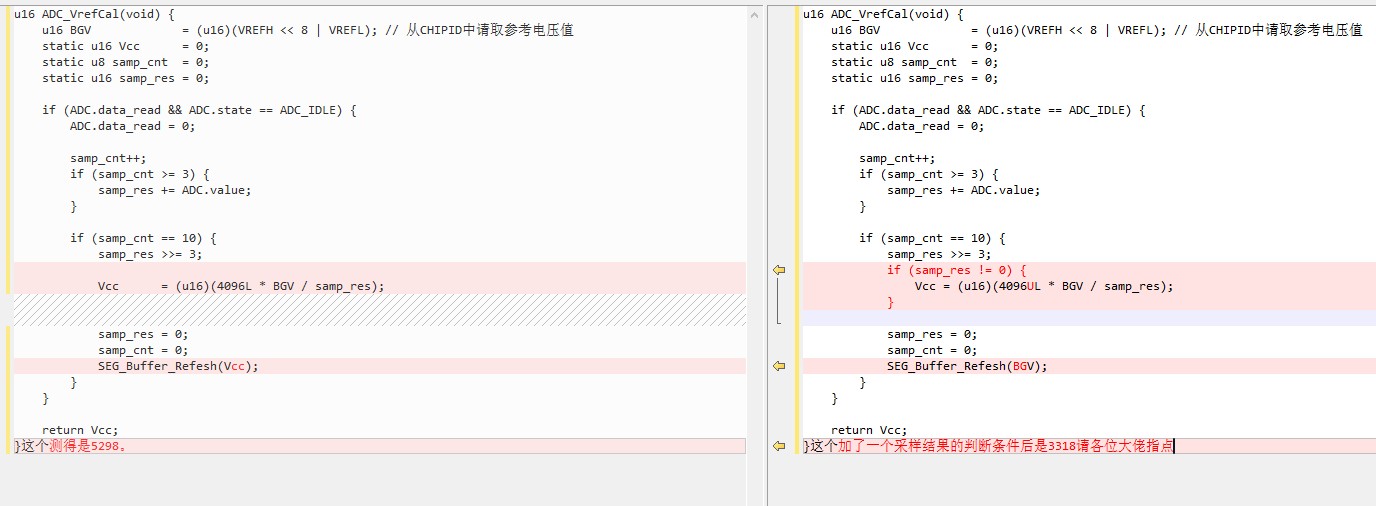

发表于 昨天 08:38 | 显示全部楼层
u16 ADC_VrefCal(void) {
    u16 BGV             = (u16)(VREFH << 8 | VREFL); // 从CHIPID中请取参考电压值
    static u16 Vcc      = 0;
    static u8 samp_cnt  = 0;
    static u16 samp_res = 0;
    if (ADC.data_read && ADC.state == ADC_IDLE) {
        ADC.data_read = 0;
        samp_cnt++;
        if (samp_cnt >= 3) {
            samp_res += ADC.value;
        if (samp_cnt == 10) {
            samp_res >>= 3;
            Vcc      = (u16)(4096L * BGV / samp_res);
            samp_res = 0;
            samp_cnt = 0;
            SEG_Buffer_Refesh(Vcc);
    return Vcc;
}这个测得是5298。
    static u16 Vcc      = 0;
        ADC.data_read = 0;
        samp_cnt++;
            samp_res >>= 3;
            if (samp_res != 0) {
                Vcc = (u16)(4096UL * BGV / samp_res);
            samp_res = 0;
            samp_cnt = 0;
            SEG_Buffer_Refesh(BGV);
    return Vcc;
}这个加了一个采样结果的判断条件后是3318请各位大佬指点

发表于 昨天 10:47 | 显示全部楼层
    u16 BGV             = (u16)(VREFH = 3) {
            samp_res += ADC.val ...
在哪用
可能有打断
